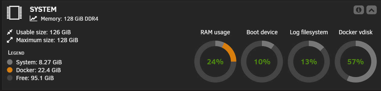

Thank you @JorgeB , it was Linkwarden with the 2G limit; i've updated with increased memory so hopefully this addresses this issue.

Received this notification during routine checks: Your server has run out of memory, and processes (potentially required) are being killed off. You should post your diagnostics and ask for assistance on the Unraid forums More Information Diagnostics attached. It appears the issue has been corrected even though the error message is persisting, but there is plenty of memory available: Would appreciate any insight if there is something going on under the hood that I need to address. brotower-diagnostics-20260913-2143.zip

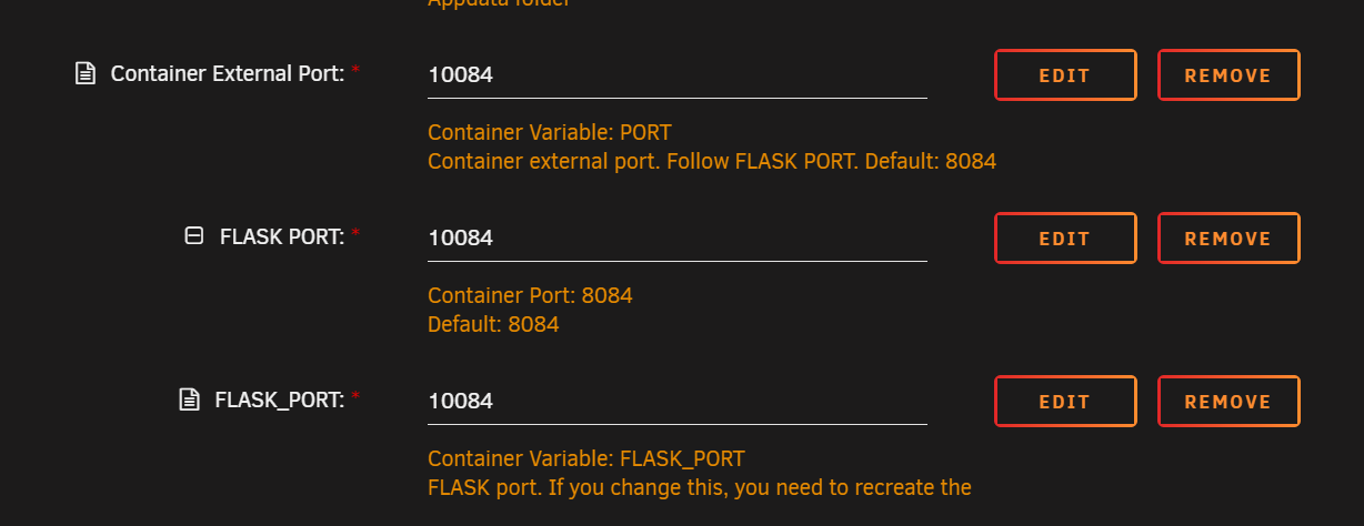

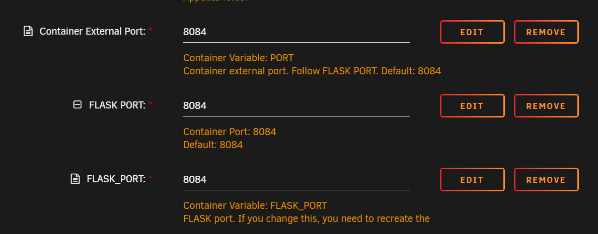

@Nodiaque Hope you can help me out. I need to change the port for this container as I have a another container using 8084. I tried changing the ports to 10084 but the web GUI is not accessible. If I run it with 8084 it works as expected. Looking at the template not sure what I need to change as the comment on the last variable appears cutoff and didn't see any info on github. Appreciate any insight you or others may have. It works like this: Can't access the gui with this change:

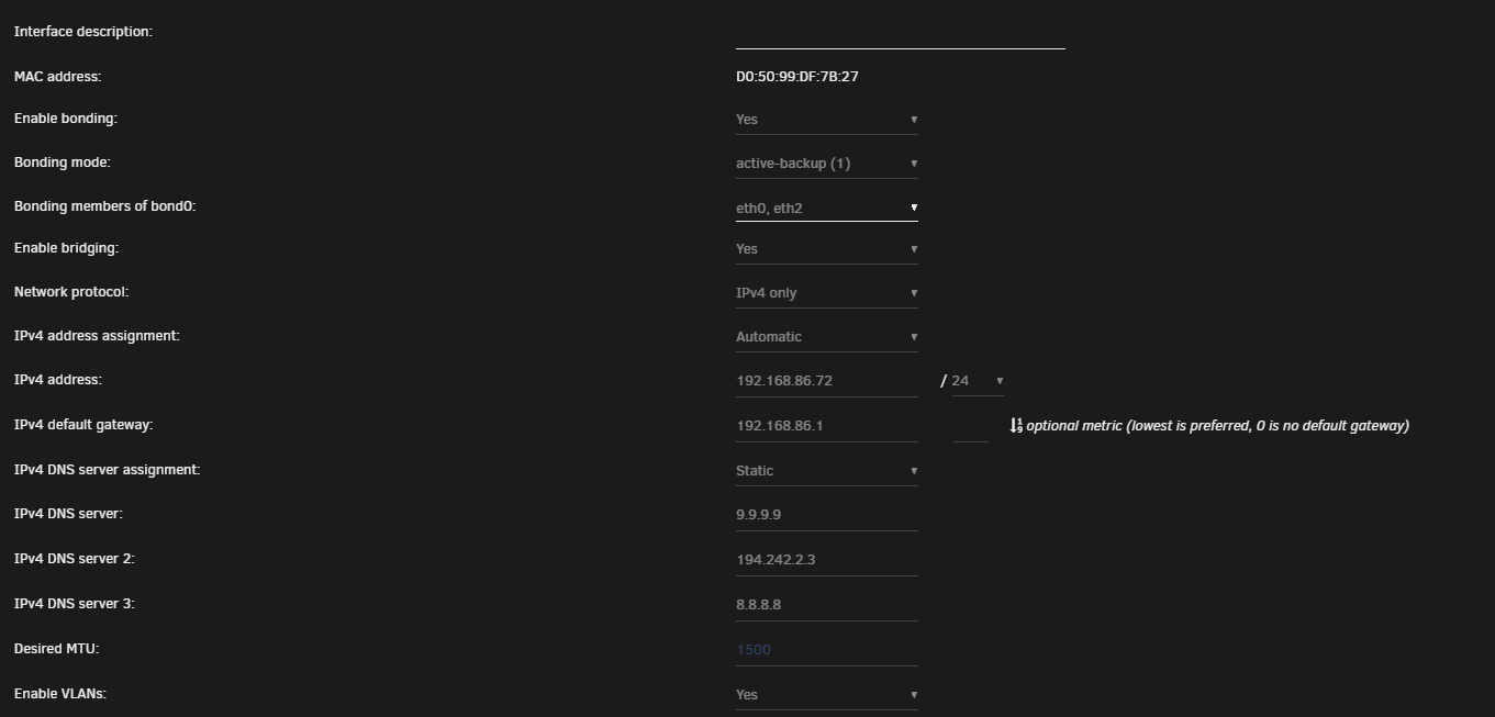

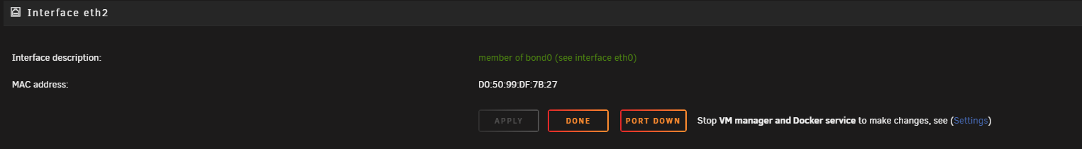

I have it set up as an active backup: Looking at my router, there has been some traffic (278MB) but eth0 is primarily (26GB) being used over the past 6 days, both are 10GB NICs,

Got this notification via Fix Common Problems so posting here hoping someone smarter than me may have insight to why this happened and potential ways to avoid: Either your server has an extremely long uptime, or your syslog could be potentially being spammed with error messages. A reboot of your server will at least temporarily solve this problem, but ideally you should seek assistance in the forums and post your I rebooted the server and will share additional information but looks like something with my NICs (specifically etho2). More info that may be helpful: Motherboard: ASRockRack X570D4U-2L2T American Megatrends Inc., Version P1.20 BIOS dated: Thu 27 Aug 2020 12:00:00 AM EDT RAM: 128GBs Unraid Version: 6.11.5 CPU: AMD Ryzen 9 3900X 12-Core @ 3800 MHz Attached diagnostics as well. brotower-diagnostics-20230507-0812.zip

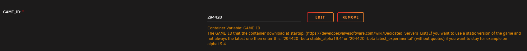

Is anyone else have trouble with 7d2d? My game is currently using Alpha 20.7 but my 7d2d container won't upgrade past Alpha 20.6 so unable to play. I've restarted the container as I thought that would download the latest release but log says it's updated to the latest. I've tried adjusting the game_id to inculde the alpha 20.7 but that didn't fix the issue either. Setting for game: Any ideas on how to solve this?
