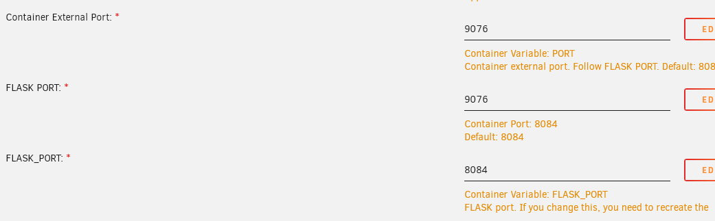

January 12, 20251 yr @Nodiaque Hope you can help me out. I need to change the port for this container as I have a another container using 8084. I tried changing the ports to 10084 but the web GUI is not accessible. If I run it with 8084 it works as expected. Looking at the template not sure what I need to change as the comment on the last variable appears cutoff and didn't see any info on github. Appreciate any insight you or others may have. It works like this: Can't access the gui with this change:
January 12, 20251 yr Author Try changing only FLASK PORT. I haven't really tried to change port but this should work. If you change FLASK_PORT, you must change other parameter too.

February 11, 20251 yr On 1/12/2025 at 1:47 AM, Twinkie0101 said: @Nodiaque Hope you can help me out. I need to change the port for this container as I have a another container using 8084. I tried changing the ports to 10084 but the web GUI is not accessible. If I run it with 8084 it works as expected. Looking at the template not sure what I need to change as the comment on the last variable appears cutoff and didn't see any info on github. Appreciate any insight you or others may have. It works like this: Can't access the gui with this change: This appears to work for me, I can access on 9076 on my LAN.

April 9, 20251 yr On 10/4/2023 at 6:07 AM, Tim Knowlden said: Thank you, run the script and reduced the docker image significantly. On 2/11/2025 at 1:49 PM, SirKelsALot said: This appears to work for me, I can access on 9076 on my LAN. @SirKelsALot - Thanks - i had the same access issue and this fixed it for me! Cheers!
