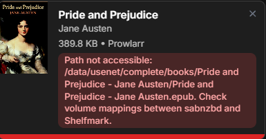

I have it set up for universal. On the client path on your template, I assumed that was where I put the storage path for my downloaders, like this:
but once I have prowlarr and my downloaders set up in Shelfmark, I get this error:
editing the template to this fixes it:
This matches how I have it in my downloader templates:
This is similar to how I had it set up in your template for CWABD that updated to the shelfmark image. On universal mode it would download but not copy to ingest. I had to add a new container path of /data and map /mnt/user/data to it to match my downloaders. I shut down that container (and the bypass) and installed this. With both versions, I didn't need to do any other mapping in the template to make the universal search work. That was all done with API keys, IPs, or sign ins (qbit)
I don't know if this is the right way to set it up but it works for me.
Edited by JewelCrabCrab
Yes you are suppose to change the mapping. That's why I said in the template that you must follow the guide on the github to setup universal. I think I'll remove the mapping in the template to make it less confusing. I followed the github template and that's why I put it with the information to change it. That's why the mount name is /client/path (like in the doc), it's to say to put your client path there. It must match exactly what you have in prowlarr and such. You did put the information at the right place, the edit you did in the second step is what you needed to also do.

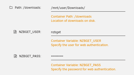

My setup is using nzbget, which has a dedicated 'share' /mnt/user/downloads/* which all my apps will reach into after the download is complete to pull the files and move them to their own shares. For books it would be /mnt/user/Books.
I have tried (i think) all iterations of swapping these paths between book download path and downloader client path, including the absolute path for /mnt/user/downloads/complete which is where the files should be moved to in the final process on nzbget's side. This was tested last as other apps just needed the parent.
If anyone can point in the right direction here would super appreciate.
Copy the mapping from your nzb into that one (for the book) exactly like it is in that one. I do not know how nzb work so I can't really chip in more then that, but it should be the same.

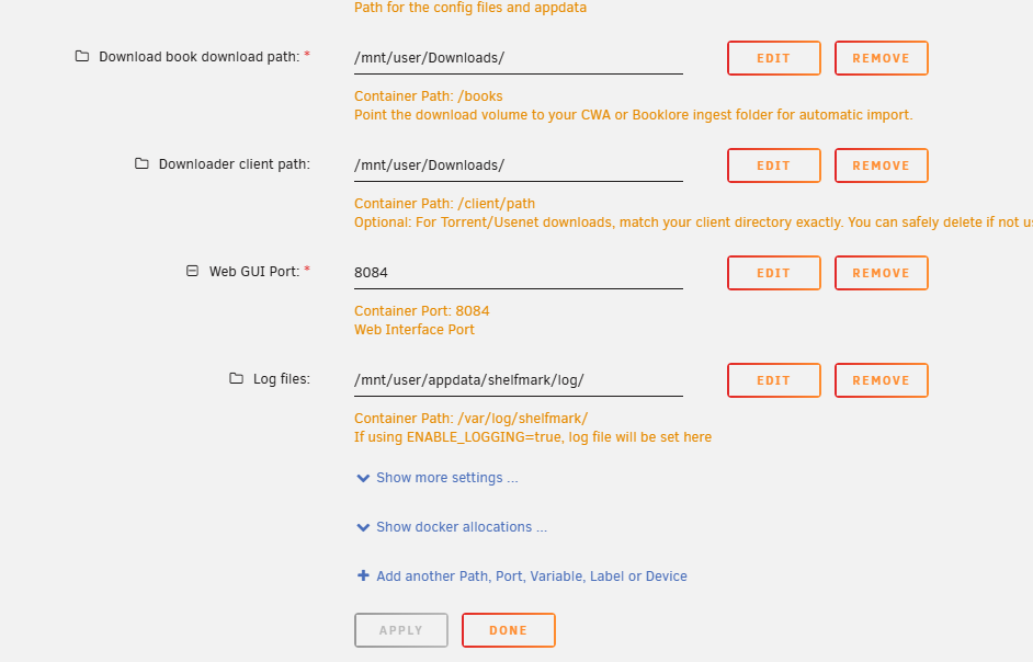

Thanks for reply. Attached images of the edit in unraid. Thats just the current folder setup for shelfmark, as mentioned I have tried /mnt/user/Downloads, /mnt/user/downloads/complete, /mnt/user/books.
What are the actual definitions of the paths? They aren't clear to me, or I thought they were but obviously not. I thought "download book download path" would be the dir files are downloaded into. But also downloader client path sounds similar? Assumption would be that "direct download" (assuming this means AA downloads?) would use "download book download path" and if usenet used, (i.e. NZBget in my instance) would be the "downloader client path" which is the path the usenet client stores the files after downloading. Even if that is the case all downloads in the SS should all land in the same place, which the app should have access to. The next question is how does the app then move the files into the correct share?

You can refer to the official doc if you need more info, it might help understanding how everything work.
The downloader path is where the file will be download when you select download. In a full automated way, it would be where calibre Web automated is set to import the file. If using other method, I cannot say. Like if it's manual, it would be where you want it to download so you can fetch them on your array/share.
The second path, client path, is only needed if using universal mode (default is direct mode and doesn't use that). It's when you do integration with qbittorrent, prowlarr, nzb and such. It must be the exact same path that you mount in these as the download path.
Edit: the app doesn't move anything. The app download in the download mount, the first one. It's the other app you connect to it that does automation. I myself.l use calibre web automated that then import the file from that mount and then do whatever it need to do with it. If using prowlarr, nzb and such, the shelfmark docker will wait for the download complete notice. Since you mapped the exact same map as you download client (let say qbittorrent download in the docker as /download and that on unraid template its mounted to /mnt/user/download, you map the exact same thing in shelfmark), shelfmark will receive a download finish notification from those other software saying download finish at path /download/filedownloaded. Thus shelfmark will take the file from this and put it in its own download folder (the first mapping).
You could say the first mapping is the ready to import folder, which is normally the import folder of CWA (as the origin of this project was to automates download and import into CWA)

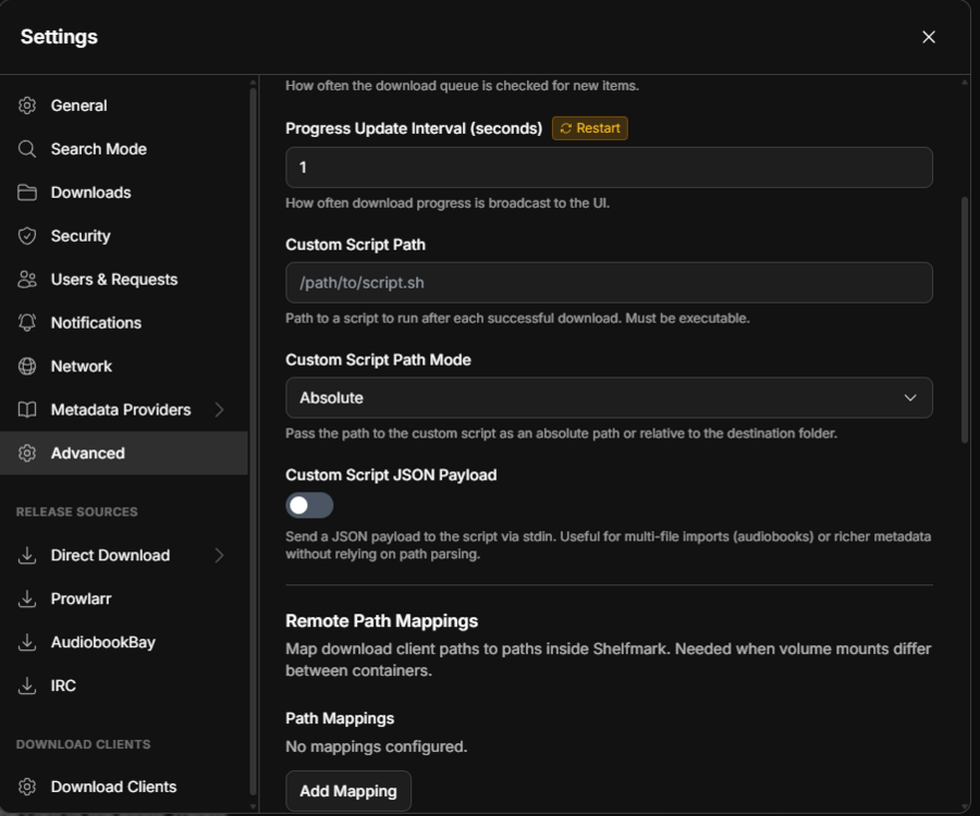

What you could do is simply create a custom script in shelfmark that change the mod after the download. You have that option under advanced

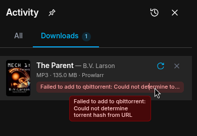

Hi there, thinking this app is going to be great, i`m almost there with it. setup qbittorrent as the indexer but get this error when downloading audiobooks. image.png
not sure what I have done wrong as the indexer connects when testing:
Test ConnectionVerify your qBittorrent
Connected to qBittorrent (API v2.11.4)
Can you someone point me in the right direction please. Many thanks :-)
Hello, I suggest going to the shelfmark project to get help on using this. There is something in the configuration not working.

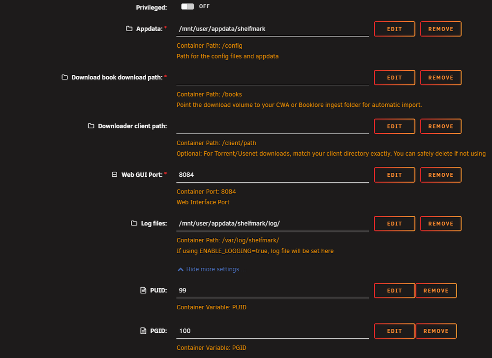

I haven't changed any defaults, and when I run docker exec -u nobody -it shelfmark whoami and again for CWA container, I get nobody returned for both.
I'm relatively unfamiliar with linux users and permissions, but I seemed to break CWA when forcing it to 99:100. I set extra parameters as --user 99:100 and created variables PGID and PUID to set to 100 and 99 respectively.
