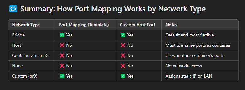

lets break it down:
1. Bridge
Default Docker network mode.
Ports are explicitly mapped (HostPort:ContainerPort) in the template.
Example:
If the app listens on port 8000 in the container, you can map it to 8050 on the host.
Min docker compose yaml example...
HTTP_CONTROL_SERVER_PORT: 8050 (host)
Container port: 8000
as the unraid template constructs a docker run file... Which results in something like:
-p 8050:8000
where we tell nat that going to port 8050 need to point to port 8000. This doesn't stop the serve using port 8000 from still broadcasting and using the port...
NAT rule apply here to dockers default network type as you traverse to the unriad host ip to port to connect to this service...
2. Host
-The container shares the host’s network stack.
-No port mapping is needed or allowed. All ports used by the container must be free on the host.
Example docker run call:
docker run --network=host ...
Whatever port the app listens on in the container (say 8000), that port must be free on the host.
Use this only when an app needs to auto-discover services or work with broadcast/multicast.
Normally used for databases... They will replace unraids host level ports so if you run a web server on port 80 or 443 it will block and prevent the unraid web ui from working...
3. Container (aka --network=container:<container_id_or_name>)
-Shares network with another running container.
-Use case: VPN containers (like Gluetun).
-The secondary container inherits the network namespace of the VPN container.
so setting:
--network=container:gluetun
Then TubeArchivist won’t have its own ports, it’s using Gluetun’s network stack.
This means:
No port mappings in the template will be used.
Only ports exposed by Gluetun can be used to reach the app.
You cannot bind the same port twice across containers using the same network.
This is why the remapping failed!
-So even though the template says:
Container Port: 8000
Host Port: 8050
--That only works in Bridge mode. In --network=container:gluetun, the app must be accessed via the VPN container's IP/interface and exposed ports.
4. None
The container has no network access at all.
Generally used for isolated or CLI-only tools.
*Similar to host... Rarely used dockers applications like Vim for example a application not found natively on unraid you can install vim with network none and use the consol of the docker to vim access files to path you add to the docker...

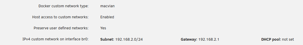

5.Custom: br0 / Veth
In my case per the picture it is using my Proxmox Veth... This is the ipvlan/macvlan depending on your docker settings....
in my case macvlan
*This allows the docker to talk to the same dhcp server and get a lan assigned IP.... this removes the nat port mapping so 8000 would be set to the custom ip you chose...
-I would recommend you use macvlan as well with vpn dockers, so each docker that get a custum ip also gets a randm mac address. ipvlan will share its mac address..

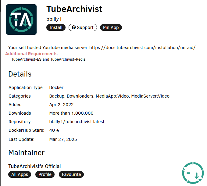

also review the install notes...
https://docs.tubearchivist.com/installation/unraid/
https://docs.tubearchivist.com/installation/env-vars/
TA_PORT#
Optional Type: Number
This changes the actual port Nginx is listening on. That is the public port exposed through the docker container. If you have a port collision on default port 8000, see bellow.
so you will need to add a docker variable TA_PORT and set that to 8080 per teh docs, this will change the port nginx is using...
