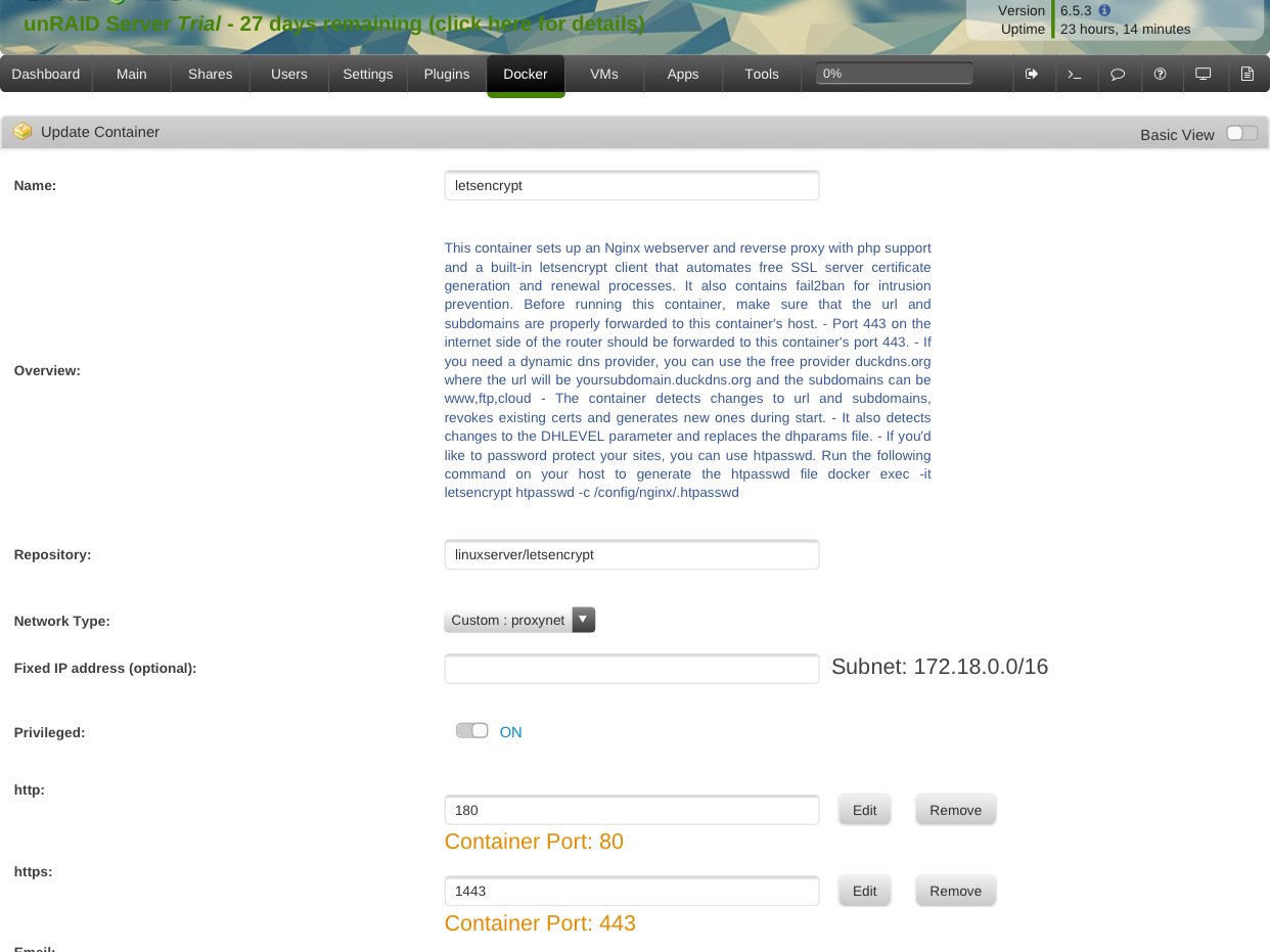

  3. With UNMS Docker - I have the same problems as above. I can't change the ports port 80 or port 433 seems to be the one every time - the template not working. (its need to be 6443->443 and 6080---> 80 )
  4. Same issue, its been like this since I buy the app, It's definitely because the NGINX , If I use port fowording only its not happaing. my config: port 443 handler: ################################################################################ #### PORT 80 ################################################################################ # listening on port 80 disabled by default, remove the "#" signs to enable #redirect all traffic to https server { listen 80 default_server; listen [::]:80; server_name _; return 301 https://$host$request_uri; } ################################################################################ # main server block ################################################################################ server { listen 443 ssl http2 default_server; listen [::]:443 ssl http2 default_server; root /config/www; index index.html index.htm index.php; server_name _; # all ssl related config moved to ssl.conf include /config/nginx/ssl.conf; client_max_body_size 0; location / { try_files $uri $uri/ /index.html /index.php?$args =404; } location ~ \.php$ { fastcgi_split_path_info ^(.+\.php)(/.+)$; fastcgi_pass 127.0.0.1:9000; fastcgi_index index.php; include /etc/nginx/fastcgi_params; } } UNRAID SUBDOMAIN (V1) - currently in use ############################################################## ### SUBDOMAIN 4 - Server UNRAID ############################################################## server { listen 443 ssl http2; server_name UNRAID.MYDOMAIN.COM; include /config/nginx/ssl.conf; location / { include /config/nginx/proxy.conf; proxy_pass https://XXXXXXX.unraid.net; # unraid logs do not work if buffering is enabled proxy_buffering off; # If you are proxying unRAID 6.4+, uncomment the following lines to support WebSockets proxy_set_header Upgrade $http_upgrade; proxy_set_header Connection "upgrade"; } } UNRAID SUBDOMAIN (V2) - not in use - but the same problem: server { listen 443 ssl http2; server_name UNRAID.MYDOMAIN.COM; include /config/nginx/ssl.conf; client_max_body_size 0; location / { proxy_set_header Host $host; proxy_set_header X-Real-IP $remote_addr; proxy_set_header X-Forwarded-For $proxy_add_x_forwarded_for; proxy_set_header X-Forwarded-Proto $scheme; proxy_pass https://XXXXXXXX.unraid.net; proxy_set_header Upgrade $http_upgrade; proxy_set_header Connection "Upgrade"; } }

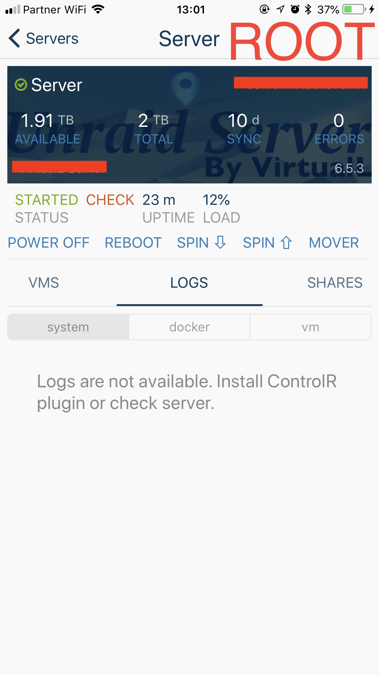

  5. Did someone managed to see LOGS files when using NGINX with outside URL ?
  6. I was recheck root Password = made a logout in my unraid web ui and login agin (same in the ControlR app) the log file is send to you in PM thank you
  7. Hi , I just send to you a PM about it. thank you
  8. Hi , so how i will see the logs ? Even in root I don't see (like you see in the image) About the Way I managed it. I don't really know because I was making changes in Nginx and my Unraid

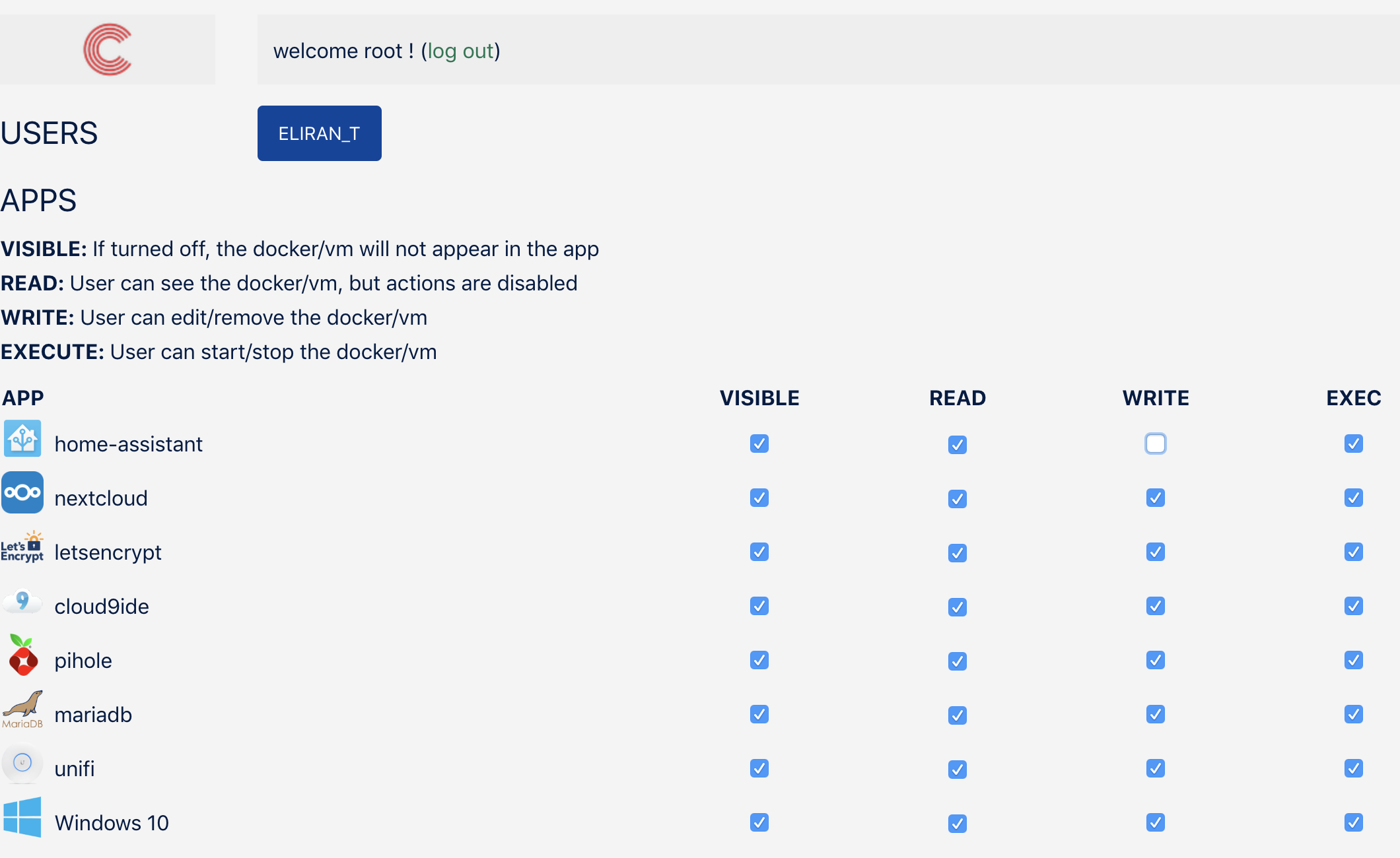

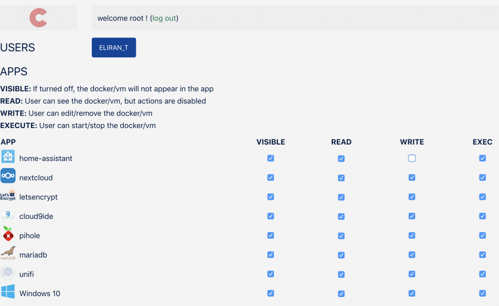

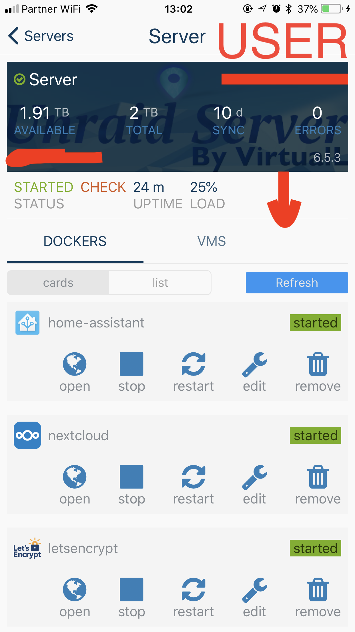

  9. hi , i manage to have it working my setting is : On Unraid/Settings/Identification - Use TLS/SSL = Auto I was open new user , and get into the GUI , and give the user all the permissions and i login in the app with the new user (not root) (p.s - its CRAZY confusing that the PASSWORD is of ROOT instead USER password- you must put some text to let the user to know it!) I got a Question: How to i see the log files in the app? Only if i am logged with ROOT is see LOGS tab, also the User Panel is very Slim VS Root panel

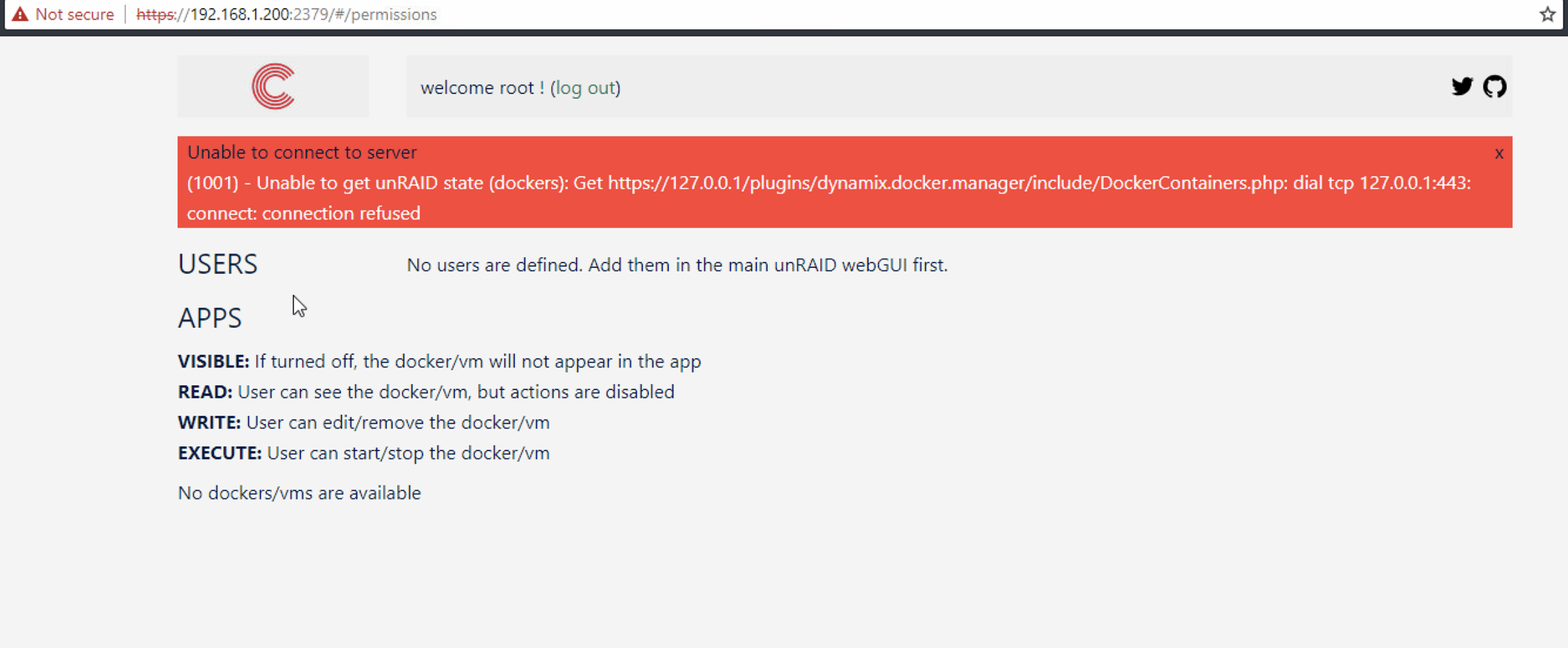

  10. root@Server:~# lsof -i :80 COMMAND PID USER FD TYPE DEVICE SIZE/OFF NODE NAME nginx 2738 root 7u IPv4 15415 0t0 TCP *:http (LISTEN) nginx 2738 root 8u IPv6 15416 0t0 TCP *:http (LISTEN) nginx 2739 nobody 7u IPv4 15415 0t0 TCP *:http (LISTEN) nginx 2739 nobody 8u IPv6 15416 0t0 TCP *:http (LISTEN) nginx 2739 nobody 17u IPv4 55508 0t0 TCP HassServer:http->192.168.1.235:51962 (ESTABLISHED) nginx 2739 nobody 18u IPv4 48831 0t0 TCP HassServer:http->192.168.1.235:51930 (ESTABLISHED) nginx 2739 nobody 20u IPv4 51788 0t0 TCP HassServer:http->192.168.1.235:51938 (ESTABLISHED) nginx 2739 nobody 21u IPv4 55509 0t0 TCP HassServer:http->192.168.1.235:51963 (ESTABLISHED) nginx 2739 nobody 22u IPv4 55510 0t0 TCP HassServer:http->192.168.1.235:51964 (ESTABLISHED) root@Server:~# lsof -i :180 COMMAND PID USER FD TYPE DEVICE SIZE/OFF NODE NAME docker-pr 3803 root 4u IPv6 18102 0t0 TCP *:ris (LISTEN) root@Server:~# lsof -i :443 COMMAND PID USER FD TYPE DEVICE SIZE/OFF NODE NAME python 3283 root 58u IPv4 56247 0t0 TCP HassServer:51164->fra15s11-in-f10.1e100.net:https (ESTABLISHED) python 3283 root 59u IPv4 60182 0t0 TCP HassServer:43772->ec2-54-77-241-118.eu-west-1.compute.amazonaws.com:https (ESTABLISHED) python 3283 root 62u IPv4 59486 0t0 TCP HassServer:49470->149.154.167.220:https (ESTABLISHED) docker-pr 3336 root 6u IPv4 60412 0t0 TCP 172.18.0.1:36690->172.18.0.2:https (ESTABLISHED) docker-pr 3336 root 11u IPv4 60416 0t0 TCP 172.18.0.1:36700->172.18.0.2:https (ESTABLISHED) root@Server:~# lsof -i :1443 COMMAND PID USER FD TYPE DEVICE SIZE/OFF NODE NAME docker-pr 3791 root 4u IPv6 18087 0t0 TCP *:ies-lm (LISTEN) and this is the file /boot/config/ident.cfg # Generated settings: NAME="Server" timeZone="Asia/Jerusalem" COMMENT="VirtualL Server" SECURITY="user" WORKGROUP="WORKGROUP" DOMAIN="" DOMAIN_SHORT="" hideDotFiles="no" localMaster="yes" USE_NTP="yes" NTP_SERVER1="time1.google.com" NTP_SERVER2="time2.google.com" NTP_SERVER3="time3.google.com" NTP_SERVER4="time4.google.com" DOMAIN_LOGIN="Administrator" DOMAIN_PASSWD="" SYS_MODEL="Custom" SYS_ARRAY_SLOTS="4" SYS_CACHE_SLOTS="2" USE_SSL="auto" PORT="80" PORTSSL="443" LOCAL_TLD="local" BIND_MGT="no" USE_TELNET="no" PORTTELNET="23" USE_SSH="yes" PORTSSH="22" START_PAGE="Dashboard" the way my server is using SSL is Via letsencrypt (https://hub.docker.com/r/linuxserver/letsencrypt/ ) and my domain menage by CloudFlare
