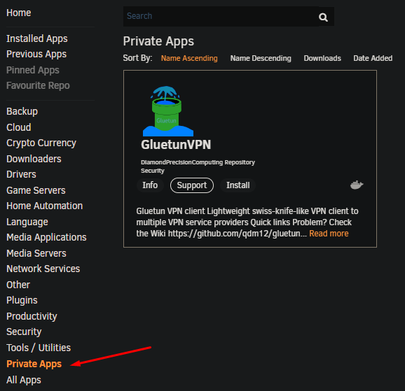

Hm no idea what I'm doing wrong here...
Went into boot/config/plugins/community.applications/private/
created a folder:
DiamondPrecisionComputing/
went into it and wget your Gluetun template (wget https://github.com/DiamondPrecisionComputing/unraid-templates/blob/master/templates/GluetunVPN.xml)
Even rebooted just to be sure.
Now I go into the apps tab and I still don't see a "private" section as mentioned in your link above. going to that folder via terminal I see the .xml file right there.. :/
You need to grab the raw file otherwise the grabbed file will be malformed.
wget https://raw.githubusercontent.com/DiamondPrecisionComputing/unraid-templates/master/templates/GluetunVPN.xml
After that it should show up here

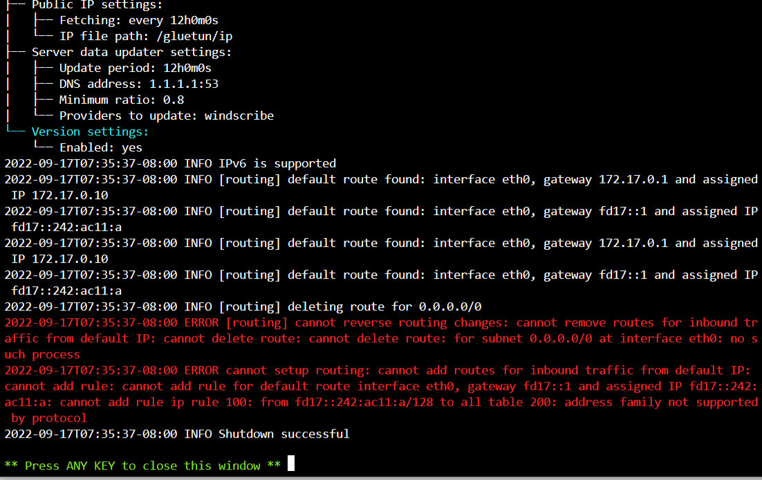

Good day.  After the latest GluetunVPN update it will no longer start.  I use it with Windscribe and have been using it alongside Unraid 6.10.3's VPN Manager for several months without issue.  I went to sleep last night with everything working well and after auto-updates were installed last night, this morning I receive this error in the log upon trying to restart the container.  I have restarted the Unraid server and the error is the same after.  Can anyone help me to get it going again?  I would be grateful.  Several of my Docker containers rely on GluetunVPN to work properly.
Can you post the entire log from the beginning?
If you need to you can roll back to a previous version by editing the application and in the repository replacing qmcgaw/gluetun:latest with qmcgaw/gluetun:v3.31.1 which is the latest major release.

Thank you for the help.  Where can I find the GluetunVPN.log file?  The only file located in my appdata\gluetun folder is servers.json
I tried reverting to a few prior versions and receive different connection errors.  I'm starting to think this may be a problem with Windscribe changing something, but I did test and confirm that my Windscribe account is still active and functioning.  My Unraid server updates Docker containers every Friday night, but I wouldn't think that a different Docker update could impact this one since that's not how Docker is supposed to work except for containers that rely on this one, but I would expect those to fail to start since GluetunVPN is stopped.

{"log":"2022-09-17T11:04:49-08:00 INFO Unbound version: 1.15.0\n","stream":"stdout","time":"2022-09-17T19:04:49.066230911Z"}
{"log":"2022-09-17T11:04:49-08:00 INFO IPtables version: v1.8.8\n","stream":"stdout","time":"2022-09-17T19:04:49.067562625Z"}
{"log":"2022-09-17T11:04:49-08:00 INFO Settings summary:\n","stream":"stdout","time":"2022-09-17T19:04:49.067919022Z"}
{"log":"├── VPN settings:\n","stream":"stdout","time":"2022-09-17T19:04:49.067947996Z"}
{"log":"|   ├── VPN provider settings:\n","stream":"stdout","time":"2022-09-17T19:04:49.06795821Z"}
{"log":"|   |   ├── Name: windscribe\n","stream":"stdout","time":"2022-09-17T19:04:49.067965761Z"}
{"log":"|   |   └── Server selection settings:\n","stream":"stdout","time":"2022-09-17T19:04:49.06797302Z"}
{"log":"|   |       ├── VPN type: wireguard\n","stream":"stdout","time":"2022-09-17T19:04:49.067980328Z"}
{"log":"|   |       ├── Regions: canada east\n","stream":"stdout","time":"2022-09-17T19:04:49.067987617Z"}
{"log":"|   |       └── Wireguard selection settings:\n","stream":"stdout","time":"2022-09-17T19:04:49.067994662Z"}
{"log":"|   |           ├── Endpoint port: 443\n","stream":"stdout","time":"2022-09-17T19:04:49.068001777Z"}
{"log":"|   |           └── Server public key: YxWQDjNmU41PJXtoobFek3Y6nhICSLgsqH+QKPO5AQ8=\n","stream":"stdout","time":"2022-09-17T19:04:49.068009069Z"}
{"log":"|   └── Wireguard settings:\n","stream":"stdout","time":"2022-09-17T19:04:49.068039683Z"}
{"log":"|       ├── Private key: CI...nM=\n","stream":"stdout","time":"2022-09-17T19:04:49.06804804Z"}
{"log":"|       ├── Pre-shared key: tl...lo=\n","stream":"stdout","time":"2022-09-17T19:04:49.068055073Z"}
{"log":"|       ├── Interface addresses:\n","stream":"stdout","time":"2022-09-17T19:04:49.068062111Z"}
{"log":"|       |   └── 100.111.141.127/32\n","stream":"stdout","time":"2022-09-17T19:04:49.068068922Z"}
{"log":"|       └── Network interface: wg10\n","stream":"stdout","time":"2022-09-17T19:04:49.06807576Z"}
{"log":"├── DNS settings:\n","stream":"stdout","time":"2022-09-17T19:04:49.06808287Z"}
{"log":"|   ├── DNS server address to use: 10.255.255.2\n","stream":"stdout","time":"2022-09-17T19:04:49.068089922Z"}
{"log":"|   ├── Keep existing nameserver(s): no\n","stream":"stdout","time":"2022-09-17T19:04:49.068096988Z"}
{"log":"|   └── DNS over TLS settings:\n","stream":"stdout","time":"2022-09-17T19:04:49.068103844Z"}
{"log":"|       ├── Enabled: yes\n","stream":"stdout","time":"2022-09-17T19:04:49.068110628Z"}
{"log":"|       ├── Update period: every 24h0m0s\n","stream":"stdout","time":"2022-09-17T19:04:49.068117602Z"}
{"log":"|       ├── Unbound settings:\n","stream":"stdout","time":"2022-09-17T19:04:49.068124454Z"}
{"log":"|       |   ├── Authoritative servers:\n","stream":"stdout","time":"2022-09-17T19:04:49.068131256Z"}
{"log":"|       |   |   └── cloudflare\n","stream":"stdout","time":"2022-09-17T19:04:49.068138087Z"}
{"log":"|       |   ├── Caching: no\n","stream":"stdout","time":"2022-09-17T19:04:49.068145077Z"}
{"log":"|       |   ├── IPv6: no\n","stream":"stdout","time":"2022-09-17T19:04:49.068151893Z"}
{"log":"|       |   ├── Verbosity level: 1\n","stream":"stdout","time":"2022-09-17T19:04:49.068158656Z"}
{"log":"|       |   ├── Verbosity details level: 0\n","stream":"stdout","time":"2022-09-17T19:04:49.06816547Z"}
{"log":"|       |   ├── Validation log level: 0\n","stream":"stdout","time":"2022-09-17T19:04:49.068172691Z"}
{"log":"|       |   ├── System user: root\n","stream":"stdout","time":"2022-09-17T19:04:49.068179524Z"}
{"log":"|       |   └── Allowed networks:\n","stream":"stdout","time":"2022-09-17T19:04:49.06818635Z"}
{"log":"|       |       ├── 0.0.0.0/0\n","stream":"stdout","time":"2022-09-17T19:04:49.068193197Z"}
{"log":"|       |       └── ::/0\n","stream":"stdout","time":"2022-09-17T19:04:49.06820019Z"}
{"log":"|       └── DNS filtering settings:\n","stream":"stdout","time":"2022-09-17T19:04:49.068207032Z"}
{"log":"|           ├── Block malicious: yes\n","stream":"stdout","time":"2022-09-17T19:04:49.068213909Z"}
{"log":"|           ├── Block ads: no\n","stream":"stdout","time":"2022-09-17T19:04:49.068220773Z"}
{"log":"|           ├── Block surveillance: yes\n","stream":"stdout","time":"2022-09-17T19:04:49.068227531Z"}
{"log":"|           └── Blocked IP networks:\n","stream":"stdout","time":"2022-09-17T19:04:49.068234328Z"}
{"log":"|               ├── 127.0.0.1/8\n","stream":"stdout","time":"2022-09-17T19:04:49.068241149Z"}
{"log":"|               ├── 10.0.0.0/8\n","stream":"stdout","time":"2022-09-17T19:04:49.068248095Z"}
{"log":"|               ├── 172.16.0.0/12\n","stream":"stdout","time":"2022-09-17T19:04:49.068254933Z"}
{"log":"|               ├── 192.168.0.0/16\n","stream":"stdout","time":"2022-09-17T19:04:49.068261751Z"}
{"log":"|               ├── 169.254.0.0/16\n","stream":"stdout","time":"2022-09-17T19:04:49.068268549Z"}
{"log":"|               ├── ::1/128\n","stream":"stdout","time":"2022-09-17T19:04:49.06827529Z"}
{"log":"|               ├── fc00::/7\n","stream":"stdout","time":"2022-09-17T19:04:49.068282057Z"}
{"log":"|               ├── fe80::/10\n","stream":"stdout","time":"2022-09-17T19:04:49.068288871Z"}
{"log":"|               ├── ::ffff:7f00:1/104\n","stream":"stdout","time":"2022-09-17T19:04:49.068295601Z"}
{"log":"|               ├── ::ffff:a00:0/104\n","stream":"stdout","time":"2022-09-17T19:04:49.06831229Z"}
{"log":"|               ├── ::ffff:a9fe:0/112\n","stream":"stdout","time":"2022-09-17T19:04:49.068321271Z"}
{"log":"|               ├── ::ffff:ac10:0/108\n","stream":"stdout","time":"2022-09-17T19:04:49.068328516Z"}
{"log":"|               └── ::ffff:c0a8:0/112\n","stream":"stdout","time":"2022-09-17T19:04:49.068335297Z"}
{"log":"├── Firewall settings:\n","stream":"stdout","time":"2022-09-17T19:04:49.068342052Z"}
{"log":"|   └── Enabled: yes\n","stream":"stdout","time":"2022-09-17T19:04:49.068348897Z"}
{"log":"├── Log settings:\n","stream":"stdout","time":"2022-09-17T19:04:49.068355697Z"}
{"log":"|   └── Log level: INFO\n","stream":"stdout","time":"2022-09-17T19:04:49.068362428Z"}
{"log":"├── Health settings:\n","stream":"stdout","time":"2022-09-17T19:04:49.06836924Z"}
{"log":"|   ├── Server listening address: 127.0.0.1:9999\n","stream":"stdout","time":"2022-09-17T19:04:49.068376113Z"}
{"log":"|   ├── Target address: github.com\n","stream":"stdout","time":"2022-09-17T19:04:49.068383009Z"}
{"log":"|   ├── Read header timeout: 100ms\n","stream":"stdout","time":"2022-09-17T19:04:49.06838988Z"}
{"log":"|   ├── Read timeout: 500ms\n","stream":"stdout","time":"2022-09-17T19:04:49.068396769Z"}
{"log":"|   └── VPN wait durations:\n","stream":"stdout","time":"2022-09-17T19:04:49.0684036Z"}
{"log":"|       ├── Initial duration: 10s\n","stream":"stdout","time":"2022-09-17T19:04:49.068410656Z"}
{"log":"|       └── Additional duration: 10s\n","stream":"stdout","time":"2022-09-17T19:04:49.06841744Z"}
{"log":"├── Shadowsocks server settings:\n","stream":"stdout","time":"2022-09-17T19:04:49.06842459Z"}
{"log":"|   ├── Enabled: yes\n","stream":"stdout","time":"2022-09-17T19:04:49.068431508Z"}
{"log":"|   ├── Listening address: :8388\n","stream":"stdout","time":"2022-09-17T19:04:49.06843828Z"}
{"log":"|   ├── Cipher: chacha20-ietf-poly1305\n","stream":"stdout","time":"2022-09-17T19:04:49.068445167Z"}
{"log":"|   ├── Password: [set]\n","stream":"stdout","time":"2022-09-17T19:04:49.068452009Z"}
{"log":"|   └── Log addresses: no\n","stream":"stdout","time":"2022-09-17T19:04:49.068458889Z"}
{"log":"├── HTTP proxy settings:\n","stream":"stdout","time":"2022-09-17T19:04:49.068466256Z"}
{"log":"|   └── Enabled: no\n","stream":"stdout","time":"2022-09-17T19:04:49.068473138Z"}
{"log":"├── Control server settings:\n","stream":"stdout","time":"2022-09-17T19:04:49.068479898Z"}
{"log":"|   ├── Listening address: :8000\n","stream":"stdout","time":"2022-09-17T19:04:49.068487451Z"}
{"log":"|   └── Logging: yes\n","stream":"stdout","time":"2022-09-17T19:04:49.068494206Z"}
{"log":"├── OS Alpine settings:\n","stream":"stdout","time":"2022-09-17T19:04:49.068501074Z"}
{"log":"|   ├── Process UID: 1000\n","stream":"stdout","time":"2022-09-17T19:04:49.068507825Z"}
{"log":"|   ├── Process GID: 1000\n","stream":"stdout","time":"2022-09-17T19:04:49.068514599Z"}
{"log":"|   └── Timezone: America/Anchorage\n","stream":"stdout","time":"2022-09-17T19:04:49.068521352Z"}
{"log":"├── Public IP settings:\n","stream":"stdout","time":"2022-09-17T19:04:49.068528286Z"}
{"log":"|   ├── Fetching: every 12h0m0s\n","stream":"stdout","time":"2022-09-17T19:04:49.068535067Z"}
{"log":"|   └── IP file path: /gluetun/ip\n","stream":"stdout","time":"2022-09-17T19:04:49.068541865Z"}
{"log":"├── Server data updater settings:\n","stream":"stdout","time":"2022-09-17T19:04:49.068548665Z"}
{"log":"|   ├── Update period: 12h0m0s\n","stream":"stdout","time":"2022-09-17T19:04:49.068555636Z"}
{"log":"|   ├── DNS address: 1.1.1.1:53\n","stream":"stdout","time":"2022-09-17T19:04:49.068562592Z"}
{"log":"|   ├── Minimum ratio: 0.8\n","stream":"stdout","time":"2022-09-17T19:04:49.068569377Z"}
{"log":"|   └── Providers to update: windscribe\n","stream":"stdout","time":"2022-09-17T19:04:49.068584064Z"}
{"log":"└── Version settings:\n","stream":"stdout","time":"2022-09-17T19:04:49.068591605Z"}
{"log":"    └── Enabled: yes\n","stream":"stdout","time":"2022-09-17T19:04:49.068598403Z"}
{"log":"2022-09-17T11:04:49-08:00 INFO IPv6 is supported\n","stream":"stdout","time":"2022-09-17T19:04:49.069033369Z"}
{"log":"2022-09-17T11:04:49-08:00 INFO [routing] default route found: interface eth0, gateway 172.17.0.1 and assigned IP 172.17.0.10\n","stream":"stdout","time":"2022-09-17T19:04:49.069478656Z"}
{"log":"2022-09-17T11:04:49-08:00 INFO [routing] default route found: interface eth0, gateway fd17::1 and assigned IP fd17::242:ac11:a\n","stream":"stdout","time":"2022-09-17T19:04:49.069734211Z"}
{"log":"2022-09-17T11:04:49-08:00 INFO [routing] default route found: interface eth0, gateway 172.17.0.1 and assigned IP 172.17.0.10\n","stream":"stdout","time":"2022-09-17T19:04:49.070399201Z"}
{"log":"2022-09-17T11:04:49-08:00 INFO [routing] default route found: interface eth0, gateway fd17::1 and assigned IP fd17::242:ac11:a\n","stream":"stdout","time":"2022-09-17T19:04:49.070619987Z"}
{"log":"2022-09-17T11:04:49-08:00 INFO [routing] deleting route for 0.0.0.0/0\n","stream":"stdout","time":"2022-09-17T19:04:49.070638425Z"}
{"log":"2022-09-17T11:04:49-08:00 ERROR [routing] cannot reverse routing changes: cannot remove routes for inbound traffic from default IP: cannot delete route: cannot delete route: for subnet 0.0.0.0/0 at interface eth0: no such process\n","stream":"stdout","time":"2022-09-17T19:04:49.070731452Z"}
{"log":"2022-09-17T11:04:49-08:00 ERROR cannot setup routing: cannot add routes for inbound traffic from default IP: cannot add rule: cannot add rule for default route interface eth0, gateway fd17::1 and assigned IP fd17::242:ac11:a: cannot add rule ip rule 100: from fd17::242:ac11:a/128 to all table 200: address family not supported by protocol\n","stream":"stdout","time":"2022-09-17T19:04:49.070752382Z"}
{"log":"2022-09-17T11:04:49-08:00 INFO Shutdown successful\n","stream":"stdout","time":"2022-09-17T19:04:49.07076129Z"}
root@Goliath:/var/lib/docker/containers#
