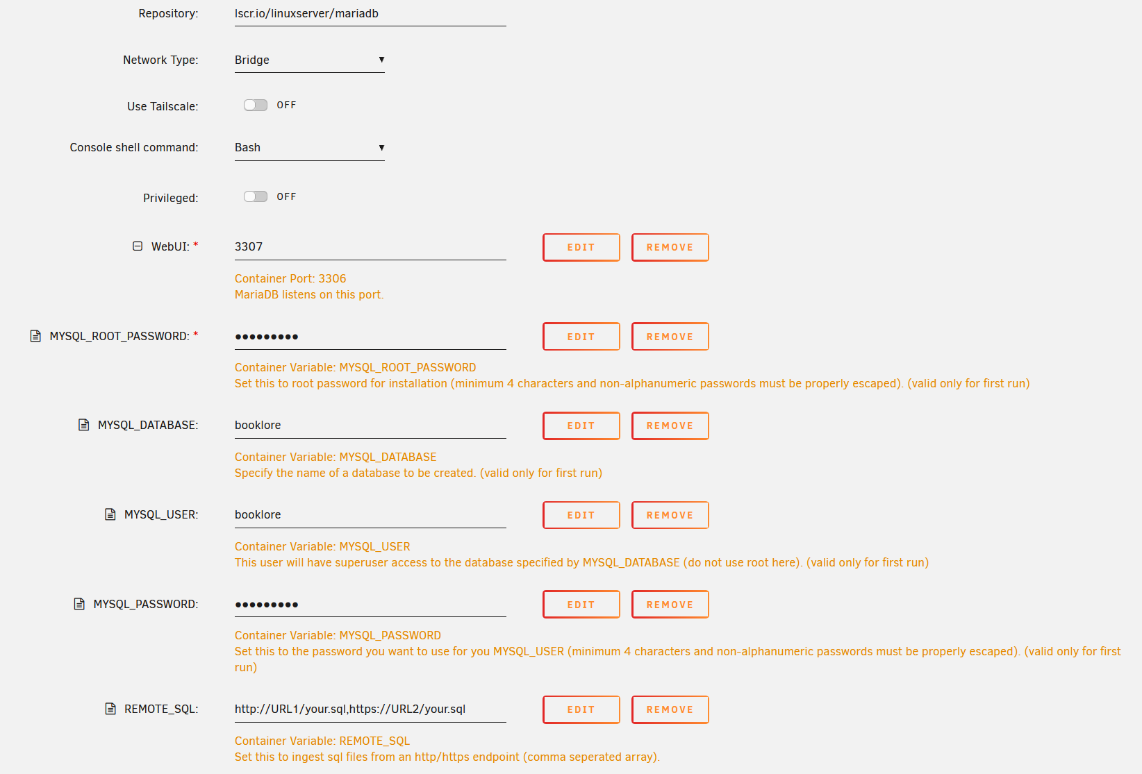

I got Boooklore working. Here's my MariaDB setup:
I left REMOTE_SQL untouched because I don't know what it does. Note the non-standard WebUI port, because I have another MariaDB container running.

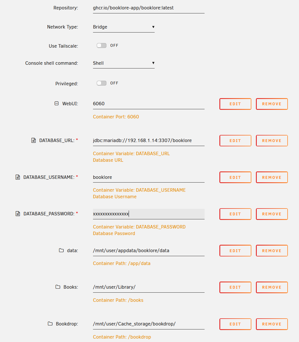

Here's my Booklore setup:
Hope this helps, @Johnny Utah
