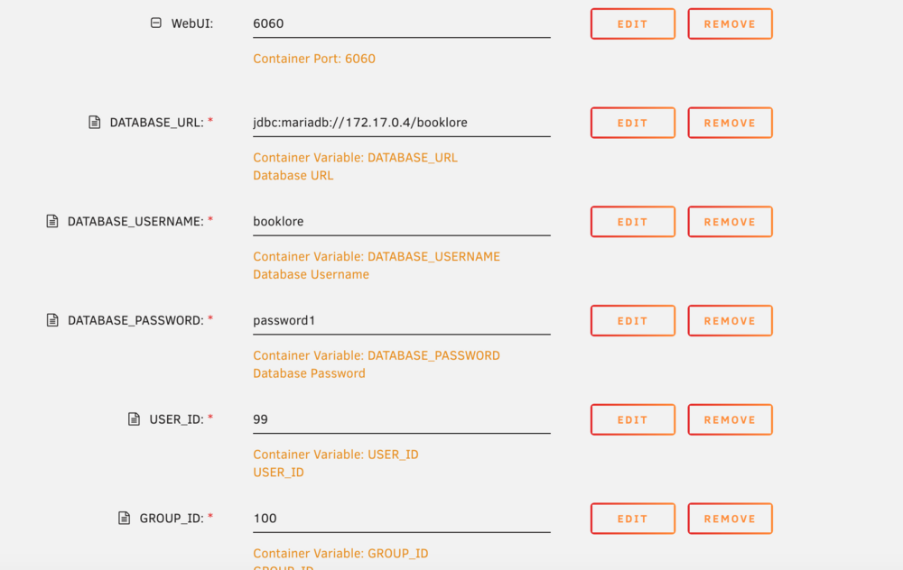

In the Booklore config:
Use:
jdbc:mariadb://192.168.0.137:3307/booklore
Make sure your <password1> is the actual DB password, not the Root password
Use:
I tried this and unfortunately, the issue still persists. The only change in the logs is the following line:
2026-02-26 12:03:37 3 [Warning] Access denied for user 'booklore'@'172.17.0.1' (using password: YES)

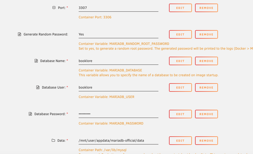

So I think you got the port settings mixed up, since you have 2 MDB instances runnning.
If I look at your logging, you are trying to connect to 'the other instance' running on port 3306, but you want to connect to the one running on port 3307
Version: '12.2.2-MariaDB-ubu2404'  socket: '/run/mysqld/mysqld.sock'  port: 3306  mariadb.org binary distribution
2026-02-25 22:30:15 3 [Warning] Access denied for user 'booklore'@'172.17.0.1' (using password: YES)
I do have two instances set up, but I was under the impression that if I change the port in the new instance's docker template to 3307 and point with the lan IP:3307 on the booklore container, it should be fine. The container port does remain 3306, but I thought that was just internal to the container. Would there be additional steps to ensure that they're connecting on the correct port?

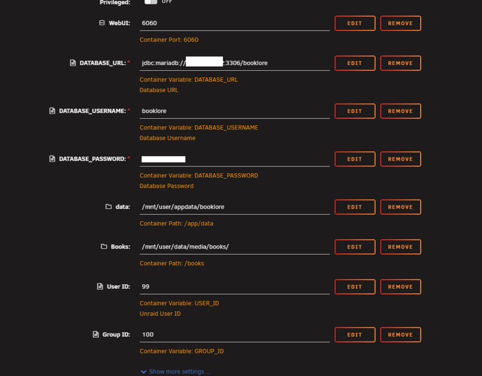

On 2/26/2026 at 12:47 AM, cambrionic said:
Booklore docker log: https://pastes.io/item-1772088002732
Maria-db docker log: https://pastes.io/2026-02-25
I had changed the database URL to point to my LAN ip (192.168.0.137:3307) before and it gave me the same error, with the address being [email protected] denied in the logs
your database URL should be the IP of the unraid server if you're using bridged, it should be possible to use the docker network too but im not certain. you will need to include the port number for either. I would blow away the folder for the database in your appdata folder and start over there. The fields on the DB container for DB name, user, and password are only executed on first run so if you changed those fields after, you're going to get errors. alternatively you could add the database to your existing mariadb instance with some relatively simple commands.
Edited by Adubs
I just tested this both ways and it does work, so I'm leaning towards whatever db name, user, or pass you initially put in is not what you have in there now and its not going to update that for you.
You probably still want to use the IP of the server rather than docker in case that happens to change down the road. The server should be static.
Your config is otherwise correct.

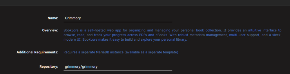

@jmztaylor any interest in changing this template to Grimmory? Or creating a new template? I was thinking about just mapping my current one to the new images, but I don't really know what I'm doing and want to avoid guessing.
GitHub
No image preview
GitHub - grimmory-tools/grimmory: Grimmory is the success...
Grimmory is the successor of booklore. Contribute to grimmory-tools/grimmory development by creating an account on GitHub.
Edited by ignitionnight
GitHub
No image preview
Someone else is more than welcome. I needed more stability than Booklore and now a new one. I ended up writing my own opds server and mobile app as my needs are a lot less than booklore features.
Until it's changed or there is a replacement, you can edit the template yourself. I did it and it worked fine.
Totally understandable! Thanks for your work on this one!
I can take care of this. Will need a few days. Once live, I can follow up here so this can one can be decommissioned.
I have added the template to my repo, and it should be available in a few hours.
The only thing I wasn't sure on was the support topic. Should a new one be created, or should this one remain for continuity purposes? I have left this thread as the path temporarily.
