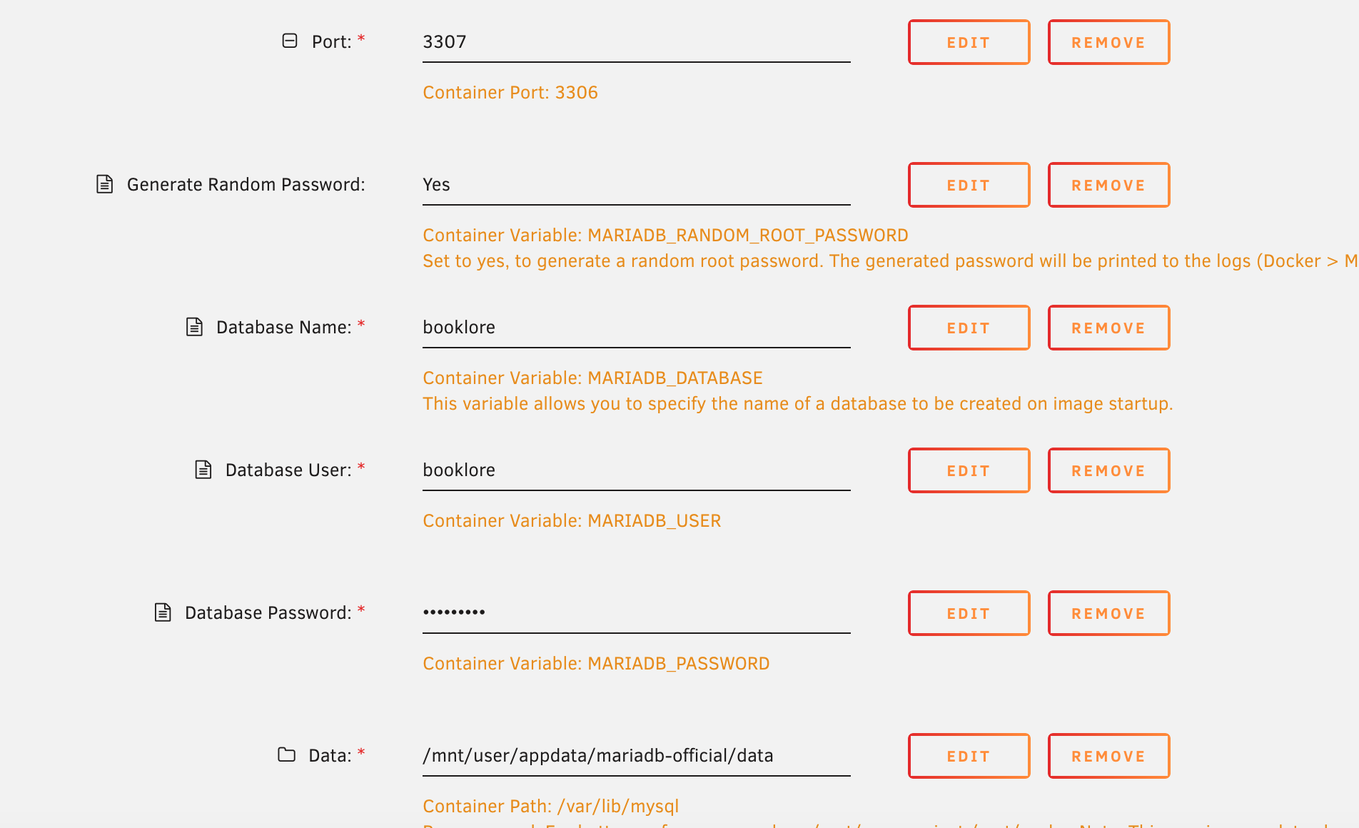

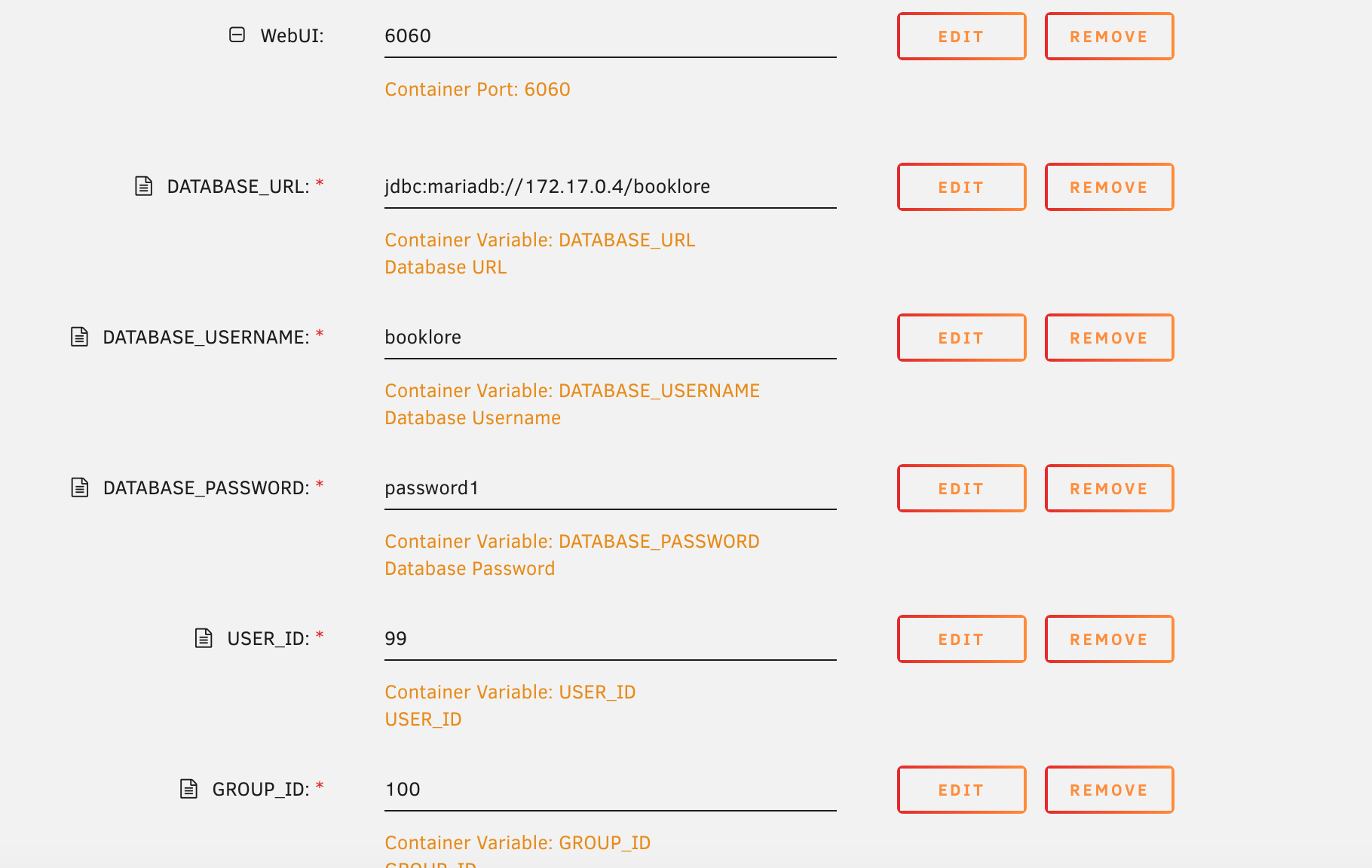

  1. Blowing away the app data folder did it!! Thanks! I had no idea the appdata folder persists even after you remove the container. Is this true for all CA docker containers?
  2. I do have two instances set up, but I was under the impression that if I change the port in the new instance's docker template to 3307 and point with the lan IP:3307 on the booklore container, it should be fine. The container port does remain 3306, but I thought that was just internal to the container. Would there be additional steps to ensure that they're connecting on the correct port?
  3. To clarify, I am using the lan IP of the maria-db container in the database url (192.0.. etc), the logs return 172.17.0.1 . For reference, when the container starts, the Container IP for booklore is 172.17.0.10 and the Container IP for maria-db is 172.17.0.4
  4. I tried this and unfortunately, the issue still persists. The only change in the logs is the following line: 2026-02-26 12:03:37 3 [Warning] Access denied for user 'booklore'@'172.17.0.1' (using password: YES)
  5. Booklore docker log: https://pastes.io/item-1772088002732 Maria-db docker log: https://pastes.io/2026-02-25 I had changed the database URL to point to my LAN ip (192.168.0.137:3307) before and it gave me the same error, with the address being [email protected] denied in the logs
