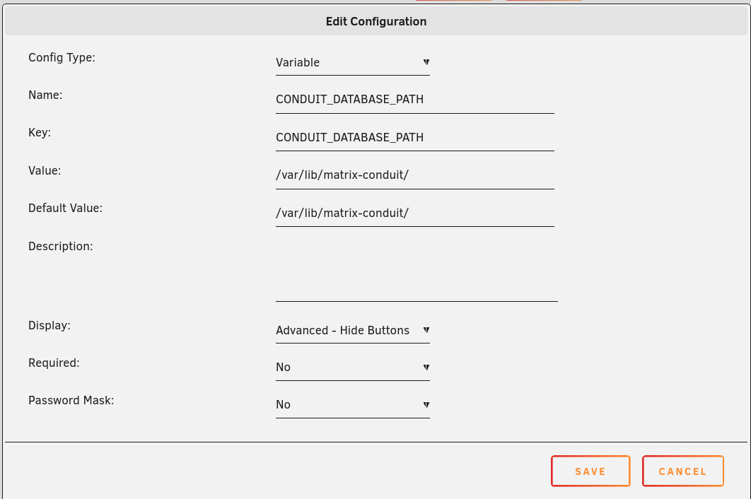

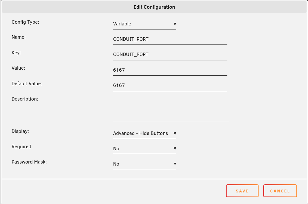

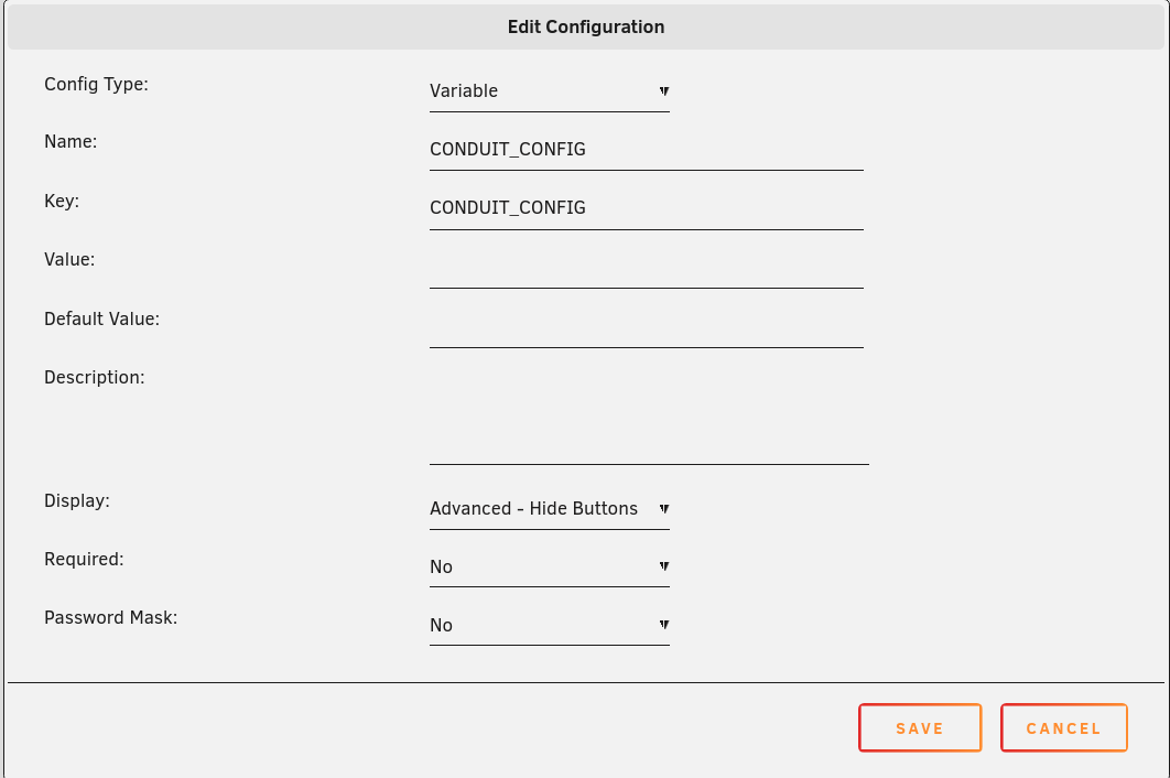

April 25, 20242 yr Author I have updated the template and the nginx conf (in the main post). Hopefully that should be reflected soon for everyone. The NGINX conf is not required but if you have issues then give it a look and apply the changes. The lines I added into the template in case you have issues (they're hidden in the advanced section because they shouldn't need changing): <Config Name="CONDUIT_DATABASE_PATH" Target="CONDUIT_DATABASE_PATH" Default="/var/lib/matrix-conduit/" Mode="" Description="" Type="Variable" Display="advanced-hide" Required="false" Mask="false">/var/lib/matrix-conduit/</Config> <Config Name="CONDUIT_PORT" Target="CONDUIT_PORT" Default="6167" Mode="" Description="" Type="Variable" Display="advanced-hide" Required="false" Mask="false">6167</Config> <Config Name="CONDUIT_CONFIG" Target="CONDUIT_CONFIG" Default="" Mode="" Description="" Type="Variable" Display="advanced-hide" Required="false" Mask="false"/> So: Variable: CONDUIT_DATABASE_PATH - /var/lib/matrix-conduit/ Variable: CONDUIT_PORT - 6167 Variable: CONDUIT_CONFIG - leave empty Edited April 25, 20242 yr by jimrummy101
April 27, 20242 yr The latest update seemed to have broken it for me: thread 'main' panicked at src/main.rs:53:55: The CONDUIT_CONFIG env var needs to be set. Example: /etc/conduit.toml note: run with `RUST_BACKTRACE=1` environment variable to display a backtrace
April 27, 20242 yr Author 2 minutes ago, Zachary.Griffin208 said: The latest update seemed to have broken it for me: thread 'main' panicked at src/main.rs:53:55: The CONDUIT_CONFIG env var needs to be set. Example: /etc/conduit.toml note: run with `RUST_BACKTRACE=1` environment variable to display a backtrace Yeah it seems my template changes haven't made it to those who already have it installed you need to add these variables: Variable: CONDUIT_DATABASE_PATH - /var/lib/matrix-conduit/ Variable: CONDUIT_PORT - 6167 Variable: CONDUIT_CONFIG - leave empty
April 27, 20242 yr 52 minutes ago, jimrummy101 said: Yeah it seems my template changes haven't made it to those who already have it installed you need to add these variables: Variable: CONDUIT_DATABASE_PATH - /var/lib/matrix-conduit/ Variable: CONDUIT_PORT - 6167 Variable: CONDUIT_CONFIG - leave empty I tried this, but I must have typed something incorrectly. This did fix it, thanks!
