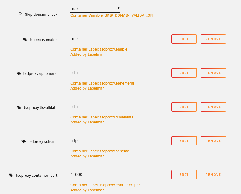

February 15, 20251 yr TsdProxy + Tailscale + Nextcloud-AIO Hi Spaceinvader The TSDProxy is a very good solution for Tailscale + Docker. I get it running! First you need install from docker app: Label Manager by Derek Kaser use that configs for NEXTCLOUD AIO 2) Docker Repository: almeidapaulopt/tsdproxy:next From LOG window of TSDProxy, you get the URLS to connect dockers enabled to your TAILSCLAE NETWORK Use the urls from the log windows and Add the NEXTCLOUD AIO DOCKER to your TAILSCALE NETWORK. My Docker NEXTCLOUD AIO use the default template ( Skip Domain Checked) It will Work! Edited February 15, 20251 yr by psycmos
