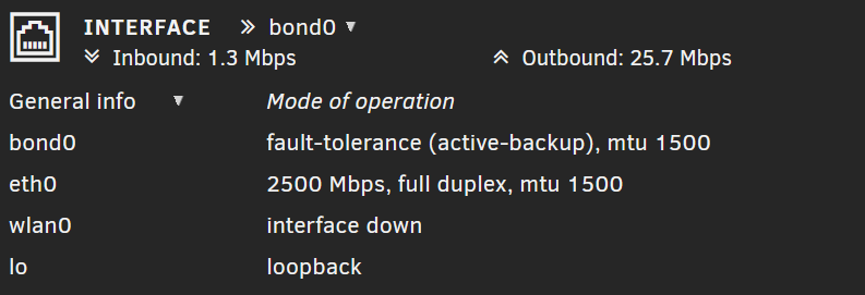

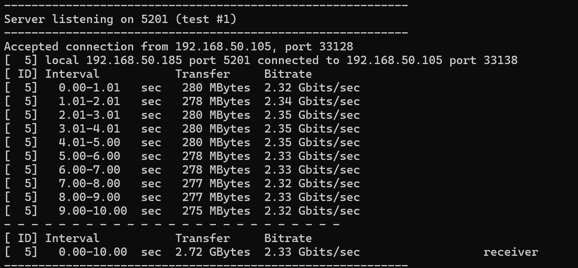

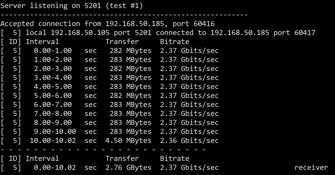

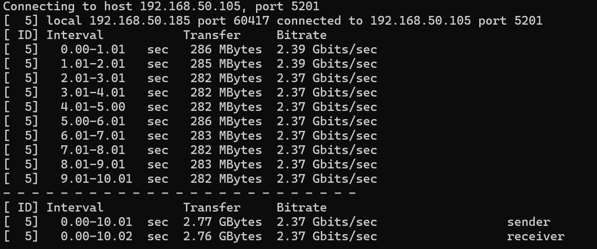

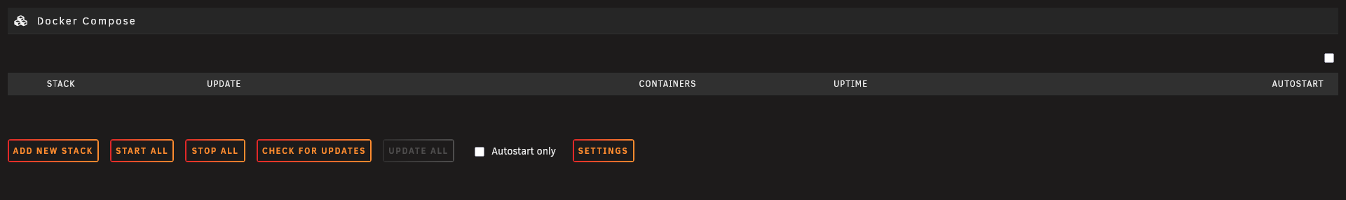

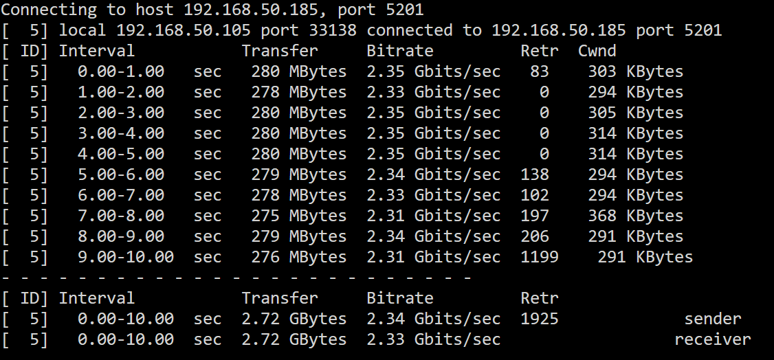

  3. My stacks are not showing up either, Unraid version 7.2.4, Compose Manager Plus version 2026.03.28.
  4. Thank you for your help, at least now I know the network upgrade was a success, and I have more room for an all SSD Unraid box in the future, if I ever save up that much cash and/or SSDs become cheap.
  5. From Unraid to Windows: From Windows to Unraid: Looks pretty close to 2.5Gbps, so I guess the connection was not the issue. Thanks Tom3 for the suggestion, my Unraid server has Seagate Ironwolf SATA HDD 7200rpm, the Windows 11 PC has all Crucial P3 SSDs, do you reckon this might be due to the reading speed of the HDDs?
