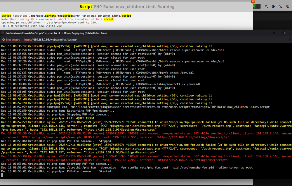

so at frist aray start user script plugn run:
#!/bin/bash
# Increase PHP-FPM max_children to handle more concurrent UI/API calls
# Run "At First Array Start" in User Scripts
PHP_FPM_CONF="/etc/php-fpm.d/www.conf"
NEW_LIMIT=200  # adjust as needed (default 50)
# Verify config exists
if [[ -f "$PHP_FPM_CONF" ]]; then
    echo "Updating pm.max_children in $PHP_FPM_CONF to $NEW_LIMIT..."
    # Use sed to replace the line if it exists, otherwise append it
    if grep -q '^pm.max_children' "$PHP_FPM_CONF"; then
        sed -i "s/^pm.max_children.*/pm.max_children = ${NEW_LIMIT}/" "$PHP_FPM_CONF"
    else
        echo "pm.max_children = ${NEW_LIMIT}" >> "$PHP_FPM_CONF"
    fi
    # Restart PHP-FPM service safely
    /etc/rc.d/rc.php-fpm restart
    echo "PHP-FPM restarted with new limit: $NEW_LIMIT"
else
    echo "ERROR: $PHP_FPM_CONF not found. Unraid may have changed its path."
fi
this will increase the limit to 200...
However, again. this is not a fix!!! You need to figur out the memory leak that hitting the 50...
I ran that and get this output:
I can neither confirm the time you ran the script nor a issues with your screenshot log...
issues again is not the script nor a solution to increase the child max... (this is temp relief anyways...) as you have somthign calling and tyring to call a script...

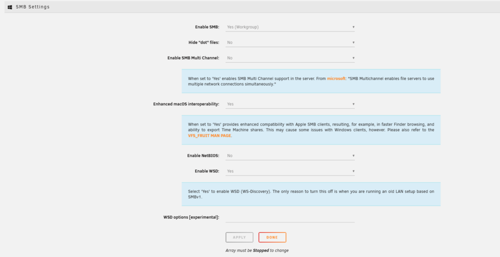

Update: So, I started tackling the Avahi error and low and behold the max_children error came back. All I did was rename a share with a blank in it, and it seem to come up during some additional log info.
This didn't exist before these last updates leading to 7.2.3. I don't know what is going on and not deep enough skills to fix them. What I do know, I am not the only 1 to report these problems.
Edited by goldbondx
2 hours ago, goldbondx said:
OK it has been 3 days after removing unassigned drive and unassigned drive plus with no max_children message that I can see. That said, still flooded with avahi_key_new() failed. Moving on..
edit the samba setting to match theses settings:

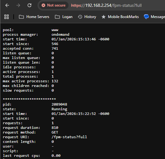

... fine lets edit fast-cgi... theres some htings to note as unraids emhttp server and its interaction with orginal nginx for https / fastcgi/php...
root@OMV:~# cat /etc/php-fpm.d/www.conf

Following the default config they ship some notes and caveats...
Your real problem: ondemand + no hard kill = saturation
default ships with:
pm = ondemand
pm.max_children = 50
With no request kill timeout enabled.
That means:
  • A worker accepts a request
  • If that request never returns, the worker never dies
  • Enough of those → you hit 50 → everything stalls
This is classic Unraid / emhttp behavior when a PHP call touches:
  • /mnt/user during disk spin-up
  • a stalled Docker socket
  • a dead plugin endpoint
  • slow USB / FUSE filesystem
  • blocking shell_exec()
The missing kill switch (this is what you want)
You must enable a hard timeout: request_terminate_timeout = 120s
Optionally track finished requests too (important for emhttp): request_terminate_timeout_track_finished = yes
Why this matters
  • Even if PHP ignores max_execution_time
  • Even if fastcgi_finish_request() was called
  • Even if shutdown handlers hang
FPM will SIGTERM the worker anyway
This is the actual zombie killer. making the child pids...
How to prove what’s leaking or stuck (no guessing)
Watch live FPM state: pm.status_path = /fpm-status
then go to http://unraid ip/fpm-status?full
Look for:
  • Workers stuck in Running state for long durations
  • Same script path repeated
  • High request duration, low request count
Regardless theres a memomory leak some where ...
so lets makse some safe tuning:
pm = ondemand
pm.process_idle_timeout = 10s
pm.max_requests = 200
so heres another user script to help idetfy and kils some zombie childs...
DO SO AT YOUR OWN RISK!!!
#!/bin/bash
# Unraid PHP-FPM hardening + diagnostics
# Run: At First Array Start
set_value() {
    local key="$1"
    local value="$2"
    if grep -qE "^[;[:space:]]*${key}[[:space:]]*=" "$PHP_FPM_CONF"; then
        sed -i -E "s|^[;[:space:]]*${key}[[:space:]]*=.*|${key} = ${value}|" "$PHP_FPM_CONF"
    else
        echo "${key} = ${value}" >> "$PHP_FPM_CONF"
    fi
    echo "Configuring PHP-FPM limits and status endpoint in $PHP_FPM_CONF"
    # Process model
    set_value "pm" "ondemand"
    set_value "pm.max_children" "50"
    set_value "pm.process_idle_timeout" "10s"
    set_value "pm.max_requests" "200"
    # Hung / zombie worker kill switches
    set_value "request_terminate_timeout" "120s"
    set_value "request_terminate_timeout_track_finished" "yes"
    # FPM status endpoint (read-only diagnostics)
    set_value "pm.status_path" "/fpm-status"
    # Restart PHP-FPM
    echo "Restarting PHP-FPM..."
    echo "PHP-FPM configuration enforced successfully."
else
    echo "ERROR: $PHP_FPM_CONF not found. PHP-FPM may not be installed or path changed."
fi

data example...
Thanks @bmartino1 . I am very hesitant to jump into scripts. However, this gave me some ideas where to start researching more.
1 comment I have as I continue to troubleshoot. GPU statistics are hammering 1-2 CPU cores (100%) like clockwork every 2-4 seconds. I verified this when I uninstalled gpu statistics plugin. The CPU usage went to <1 and stayed that way until I reinstalled and selected my RTX3070. Then the 1-2 CPU cores started bouncing to 100% again like clockwork.
I have deselected my card in GPU statistics and seems to have stabilized. I will start up the array and monitor for several hours.
It appears occurrences of [WARNING] [pool www] server reached max_children setting (50), consider raising it are indeed tied to load of Dashboard (specifically Main) in browser. Only occurrences thus far are tied to refresh or tab changes as I monitor real-time.
