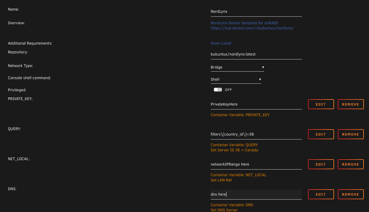

I'm taking another run at the setup, installation and configuration of the bubuntux/nordlynx container.
If I go to apps and select the NordLynx container then enter the following parameters:
- Extra Parameters: --cap-add=NET_ADMIN --sysctl net.ipv4.conf.all.src_valid_mark=1 --sysctl net.ipv6.conf.all.disable_ipv6=1
- Network Type: Bridge
- QUERY: filters\[country_id\]=38
- NET_LOCAL: 192.168.0.0/24
- DNS: 1.1.1.1,8.8.8.8
- Parameter - qBittorrent-6881: 6881
- Parameter - qBittorrent-8080: 8080
- PRIVATE_KEY:  <- Here's where things fall apart. I went to my account at NordVPN and generated a token however if I use this value in the PRIVATE_KEY field, the log generates a
- Key is not the correct length or format: `***********************REDACTED***********************'
- Configuration parsing error
Then it goes on to indicate:
- [2023-04-10T15:22:38-04:00] Connecting...
- [2023-04-10T15:22:38-04:00] Connected! \(ᵔᵕᵔ)/
However, the next problem I encounter is when I open a console into the container and try to use the "curl ifconfig.io" command to get the IP address that the container is using. The curl ifconfig.io command returns:
curl: (28) Failed to connect to ifconfig.io port 80 after 261772 ms: Couldn't connect to server
I'm opened to any ideas, suggestions, guidance or input that may help. I've seem where it just seems to work for some people and others eventually get it working but I've had no luck with this whatsoever.

Finally resolved this and got NordLynx container working!
Here are the steps I took:
- To obtain my NordVPN Token, I followed the process outlined here.
- Following the above, I obtained a Token
- I then opened a console in UnRAID itself and entered the following command:
docker run --rm --cap-add=NET_ADMIN -e USER='[email protected]' -e PASS='myNordVPNaccountpassword' -e TOKEN='thetokenfromNordVPN' bubuntux/nordvpn:get_private_key
- This resulted in the following:
Waiting for daemon to start up...
Welcome to NordVPN! You can now connect to VPN by using 'nordvpn connect'.
Technology is already set to 'NORDLYNX'.
Connecting to Canada #1653 (ca1653.nordvpn.com)
You are connected to Canada #1653 (ca1653.nordvpn.com)!
IP: 10.5.0.2/32
Private Key: REDACTED
\(^O^)/
- I then used the "Private Key" value within the NordLynx container's PRIVATE_KEY variable parameter.
- Once the container was installed and running, I bashed into the container and entered: curl ifconfig.io which returned 86.48.14.182
- I copied that value and navigated to https://whatismyip.com and entered 86.48.14.182 into the search field.
- Searching that IP address returned a NordVPN server based in Canada.
- To test it, I changed the filters\[country_id\]=38 within the NordLynx container to a value of 74 (France) and restarted the container.
- Bashing into the container's console again, I executed a curl ifconfig.io and searched the resulting IP address https://whatismyip.com which returned a site in France.
Based on the above, I believe that the container is now working.
- I then added two port fields to the container which are the two ports that qBittorrent uses.
- Then, within the advanced view of the qBittorrent parameters, I set the following:
Extra Parameters: --net=container:nordlynx
Network Type: None
Finally, to test the obfuscation of my IP address, I navigated to https://torguard.net/checkmytorrentipaddress.php and copied the "Download Now" link and added a new torrent to qBittorrent using the copied link. On the torguard website, the address being broadcasted was that of the NordVPN server and NOT my actual WAN IP.
So, success. Finally. Amen.

Thank you @jimdaway I was able to get my NordLynx functioning via your walk-through!
I was able to sort this all out - here's what I did:
  1. Install tmknight88's NordLynx container by adding a new container with no template and using 'tmknight88/nordvpn' as the repo.image.thumb.png.98f7fc182ce3ebab68d33606c757e07a.png
  2. Stopped the container and added these extra parameters:  image.thumb.png.2179552f642c3076ea5587b1df59ef9e.png
  3. Added the following Environment variables as described here , your NET_LOCAL will generally be your local subnet (mine is 192.168.11.0/24).   You can generate your token via a web browser at https://my.nordaccount.com/dashboard/nordvpn/image.thumb.png.732cbd9859f5603de5c9e5d6faf24489.pngimage.png.225e9fc740864929fb1a36cb248fe37d.png
  4. Added the ports required for LAN access to the containersimage.png.a12a59b8c42393c5e539a9c43c93a078.png
  5. ???
  6. Profit
Network Type: None
Sorry for asking, but how exactly did you do this?  And where are the country IDs found?
Edit: nm, did some googling on the NordVPN API and managed to splice together a QUERY string to get me going.

I was able to get it working with these instructions. A couple of notes of clarification if anyone is still struggling:
The PRIVATE_KEY required in the Nordlynx container is NOT the token that NordVPN gives you from your account page on the website. Run that token (from the website) through the get_private_key container as listed above which will give you the PRIVATE_KEY you need to enter into the main Nordlynx container.
It doesn't appear that the USER and PASS env variables are actually needed in that container.  It seemed to give me a private key once I entered the token properly alone.
The only thing I have left is to figure out how to better utilize the QUERY string to select a few different endpoints for convenience. If anyone has already done the work on putting a selection of country codes in, I'd be highly appreciative. There's a country code list here for those still looking: https://api.nordvpn.com/v1/servers/countries
Also, still can't get the icon working for some reason. Comes up fine in a web browser but it won't load via the docker settings in Unraid.
Edit: Replace the icon URL with (remove brackets):
[https:]//s1.nordcdn.com/nordvpn/media/1.752.0/images/global/favicon/favicon-196x196.png
