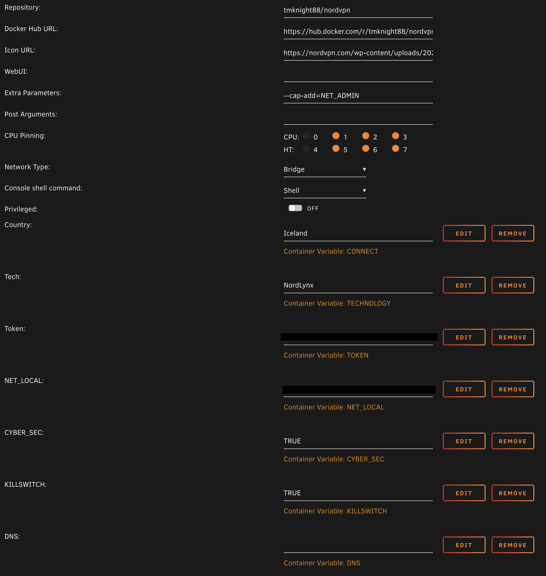

  2. User and Pass no longer works with Nordvpn, at least over docker. It seems they made some changes on their servers. Now you need to go to your Nordvpn account and create a token. Then try use TOKEN="xxx". It should work also on bubuntux/nordvpn as it is included in its "how to use" at Git. But I completely abandoned to use that repository after many constant bugs on every single update. It has been like a year that had been a pain in the ass to use it.
  3. I changed the repository to use Nordvpn on my Unraid server to https://hub.docker.com/r/tmknight88/nordvpn/ Now it seems to be necessary to use the Token value instead of User and Password, but this repository seems to work perfect, at least for me. Here is the most important environment variables I put to get it to work: but in his github there are also other environment variables that you can use. https://github.com/tmknight/docker-nordvpn And if anyone want to add the icon URL, I used this one: Logo
