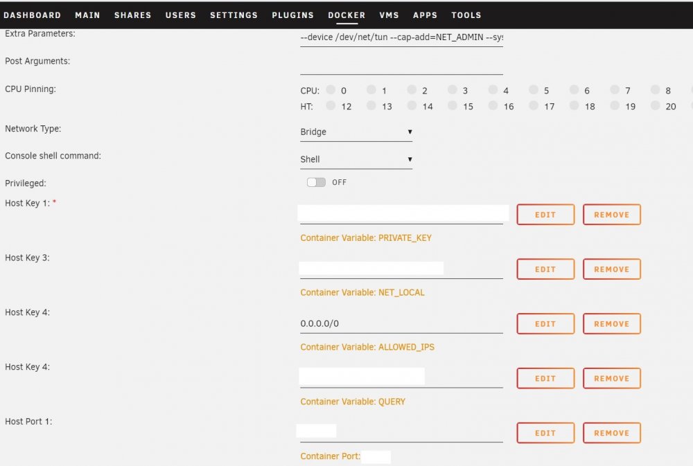

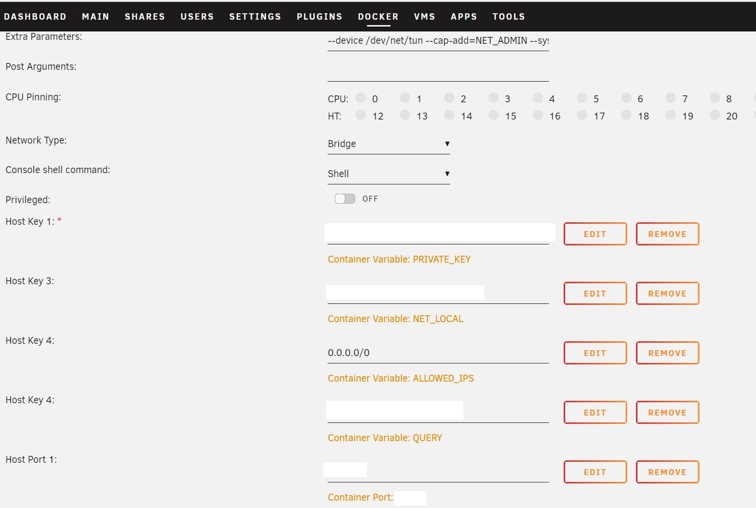

Do you fancy sharing a screenshot of your container settings (minus the private key of course)
Thanks
set repository to
ghcr.io/bubuntux/nordlynx
in extra parameters add (the part after --sysctl is if you dont use ipv6)
--device /dev/net/tun --cap-add=NET_ADMIN --sysctl net.ipv6.conf.all.disable_ipv6=1
add your private key variable
add networks in CDIR you want to be able to acces the vpn from (ex 192.168.0.0/24)
under allowed ip set filters or leave as is for all ip
under query add any filters you want if needed (p2p obfuscsted specific country etc. as per NORDVPN API)
for example for p2p servers
filters\[servers_groups\]\[identifier\]=legacy_p2p
add  any ports you want to be able to acces from lan

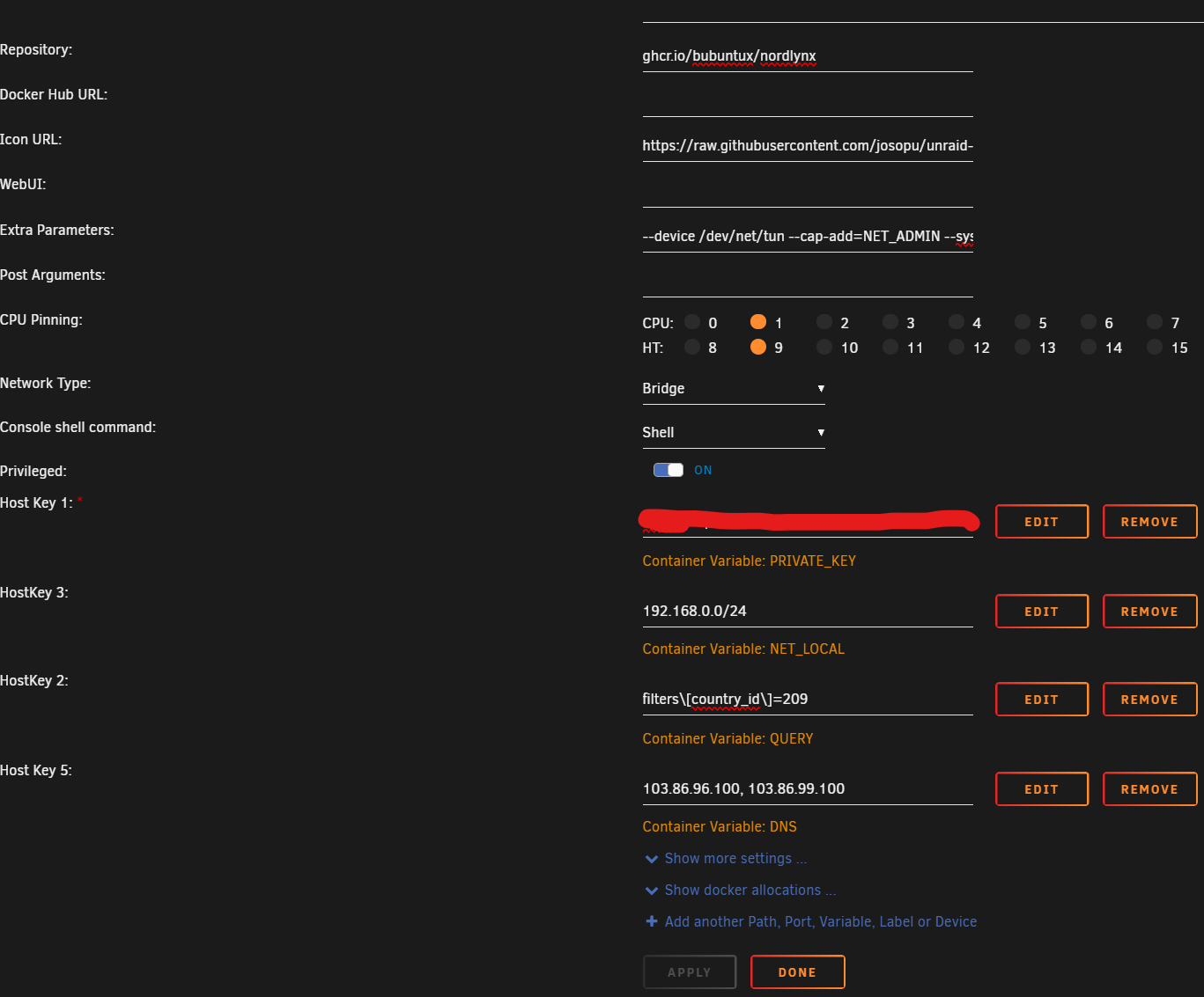

Hi everyone, I have followed Akagami information (thank you).
It all went well and I can see that I am connected to the NordVPN country I wanted to.
I have issue with the DNS resolution however:
I can't ping anything on the Internet (LAN ping works fine). I get "ping: bad address 'www.google.com'.
Same with curl ifconfig.io, I keep getting: "curl: (6) Could not resolve host: ifconfig.io.
I have checked /etc/resolv.conf and it all looks fine (nameserver 103.86.96.100 and 103.86.99.100).
Here is my extra parameters:
NET_LOCAL is my LAN subnet so this shouldn't be a problem either.
Please let me know if you think of anything I could have missed for the DNS resolution.
Thanks
