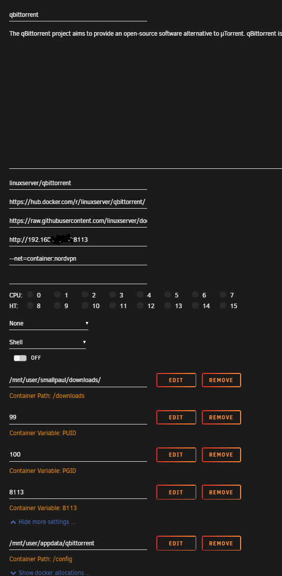

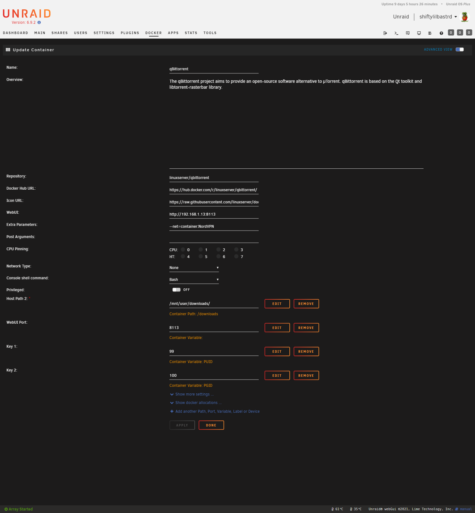

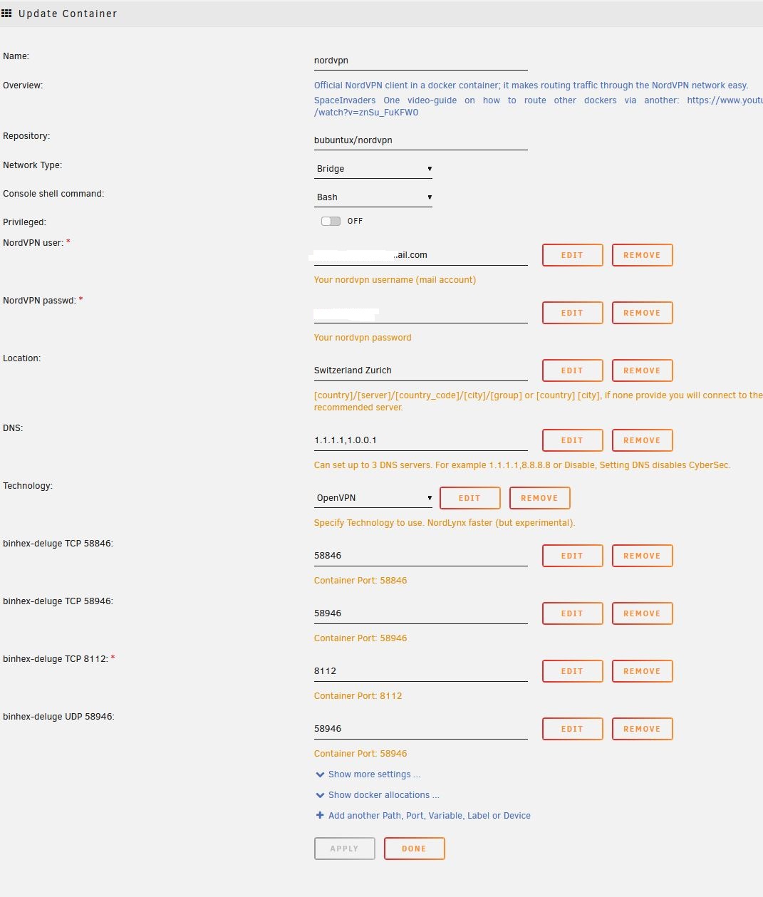

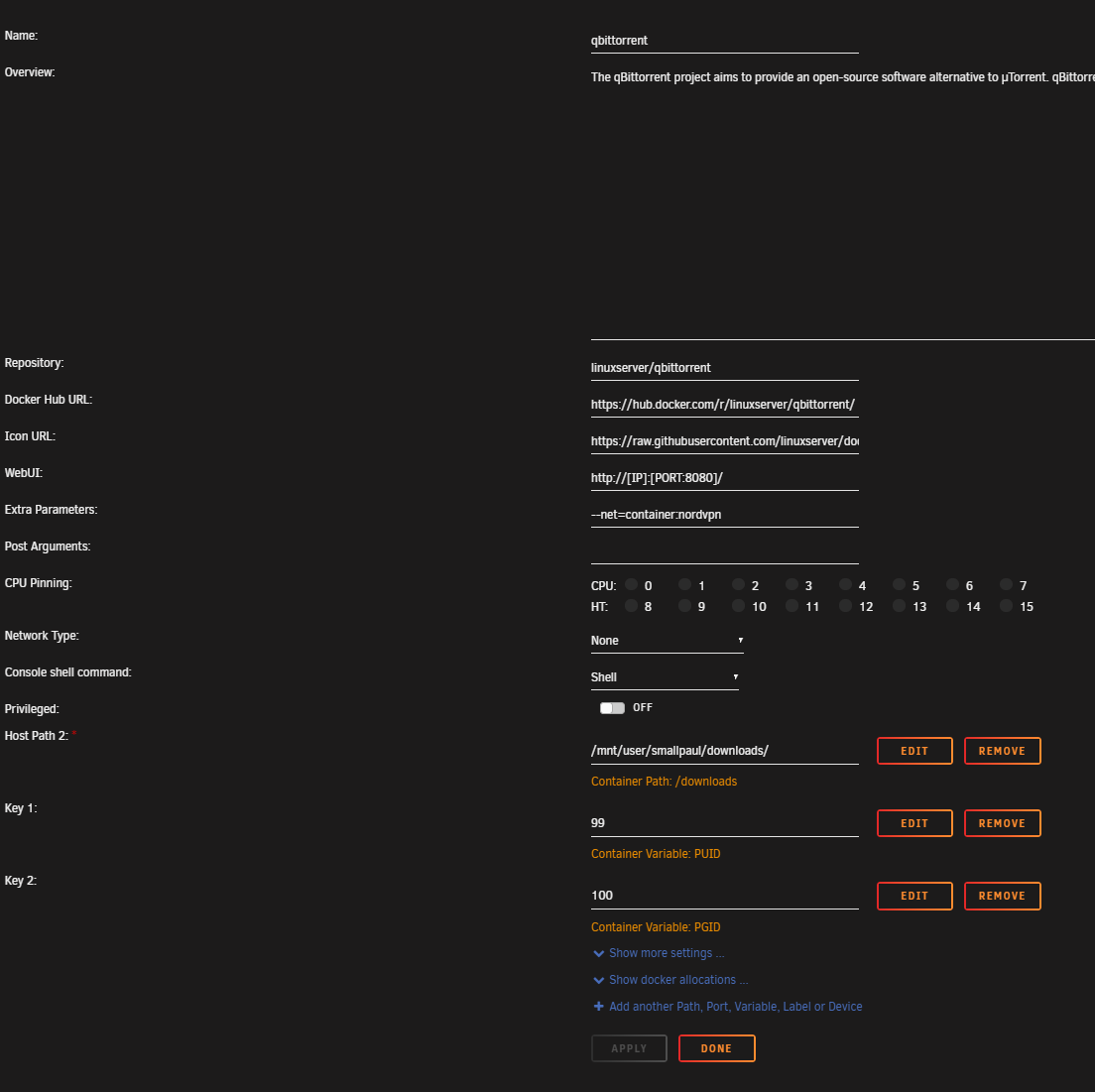

Notice the ports on the vpn container, those are actually the ports required for qBittorrent. Also note that qBit is set to network none and then has the extra parameter
--net=container:nordvpn
(or whatever you have your vpn container named). This will force a rebuild of any dependent containers when there’s a change to the vpn container.

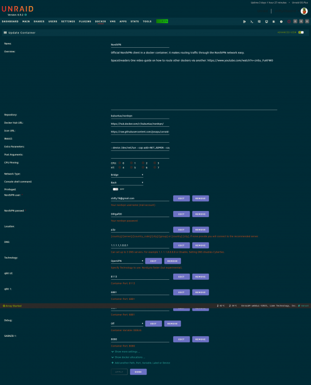

You Nord configure should resemble this except leave location blank unless you have a preference
Also 6881 ports are for qBit?
What do you have after "--device /dev/net/tun --cap-add=NET_ADMIN"? I only have this two entries, not a third one like you.
After configuring like your settings, its hanging at "connecting..." for about 10 minutes or so. Tried both NordLynx and OpenVPN.
Edited by aurevo
--device /dev/net/tun --cap-add=NET_ADMIN --cap-add=SYS_ADMIN --sysctl net.ipv4.conf.all.rp_filter=2
you only need
If I remember correctly. The rest is me trying to get nordlynx working

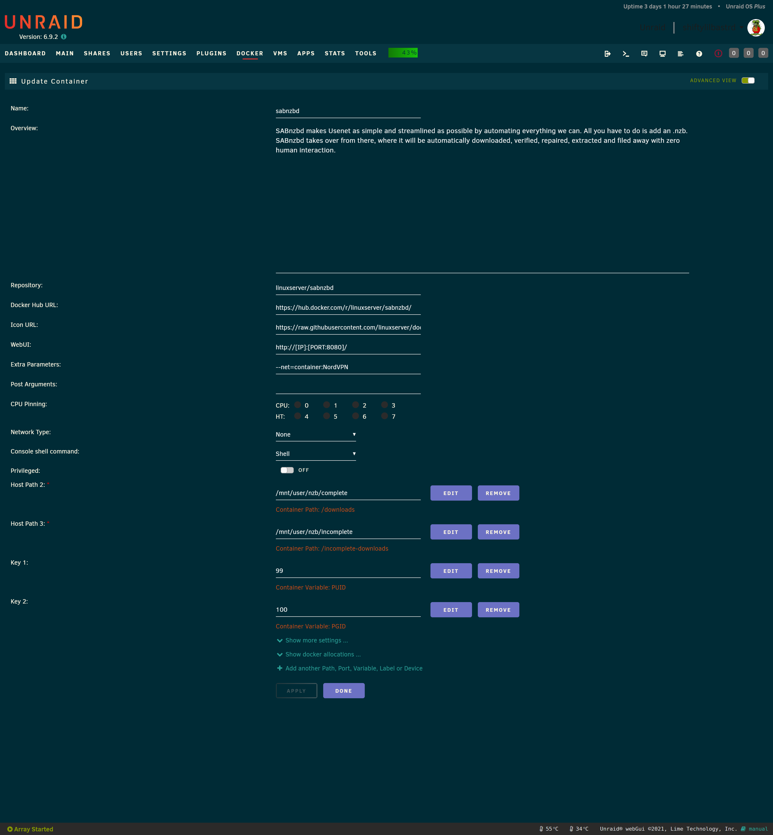

I have nordvpn setup and working and have sabnzb running though it but I cannot connect via browser server address:8080 ? I tested with Radar and was successful.  Thanks
sabnzb
nordvpn
Edited by Kodiak51103
i have configured my settings for both nordvpn and qbittorrent as @shiftylilbastrd has shown, and can confirm qbit is connecting through nordvpns ip but i cannot access the webui at all. or any docker i route through nordvpn. i have been troubleshooting for a few hours and not sure what to do here, any suggestions?

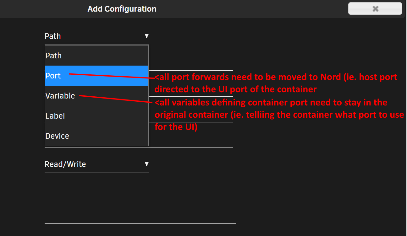

@Kodiak51103
All ports need to be removed from the nzb container and added to the Nord container. Only exception is if it’s a config variable telling the container which port to listen to.

@Kodiak51103

Removed the 2 ports 8080,8089 from SABNZB added them to nordvpn still cannot access the  UI via browers serveraddress:8080 or 8089? Thanks!
SABNZB
NordVPN
I have the same problem, can't acces GUI.
ip is good on both sides, port have been moved to NordVPN (and deleted in other container)
I even tried the required field in ports menu, but no luck.

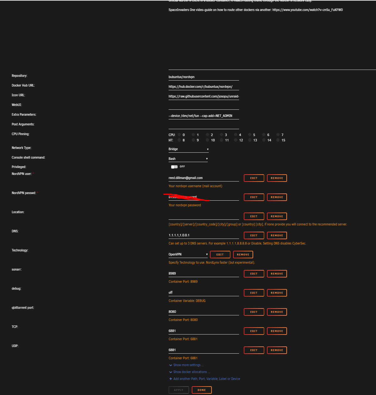

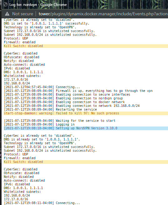

i believe all of my settings are identical to the screenshots you have shown @shiftylilbastrd, but i have been staring at these images so long i could be wrong lol. nord also seems to hang on "connecting" though when i use curl ifconfig.io on qbit it shows to have the same IP as nordvpn so i think its working? still getting "this site can't be reached, IP took too long to respond" instead of webui

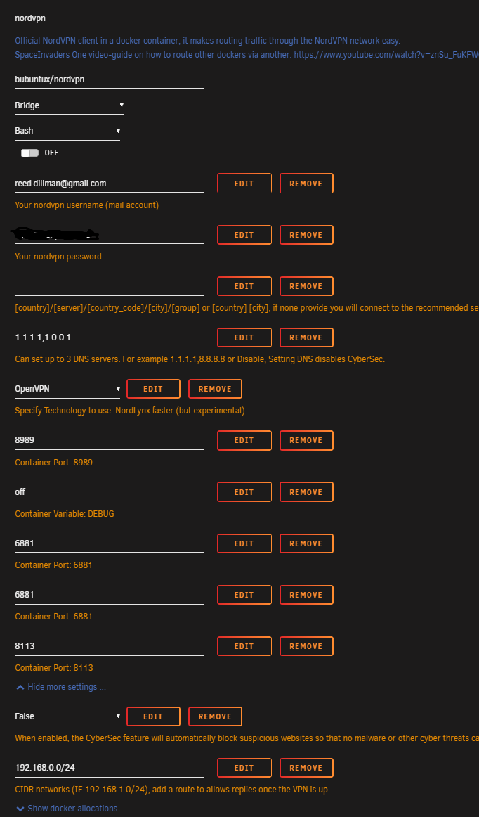

@Kodiak51103So the second port is 8090 not 8089, but that wouldn't be the problem. Show me your entire config page for both.
@Renaldo Not exactly sure what's up with yours. I do see you removed the variable that sets the webUI port in qBit (8113 by default). Suggest you add that back and then add a port in Nord to pass that through.

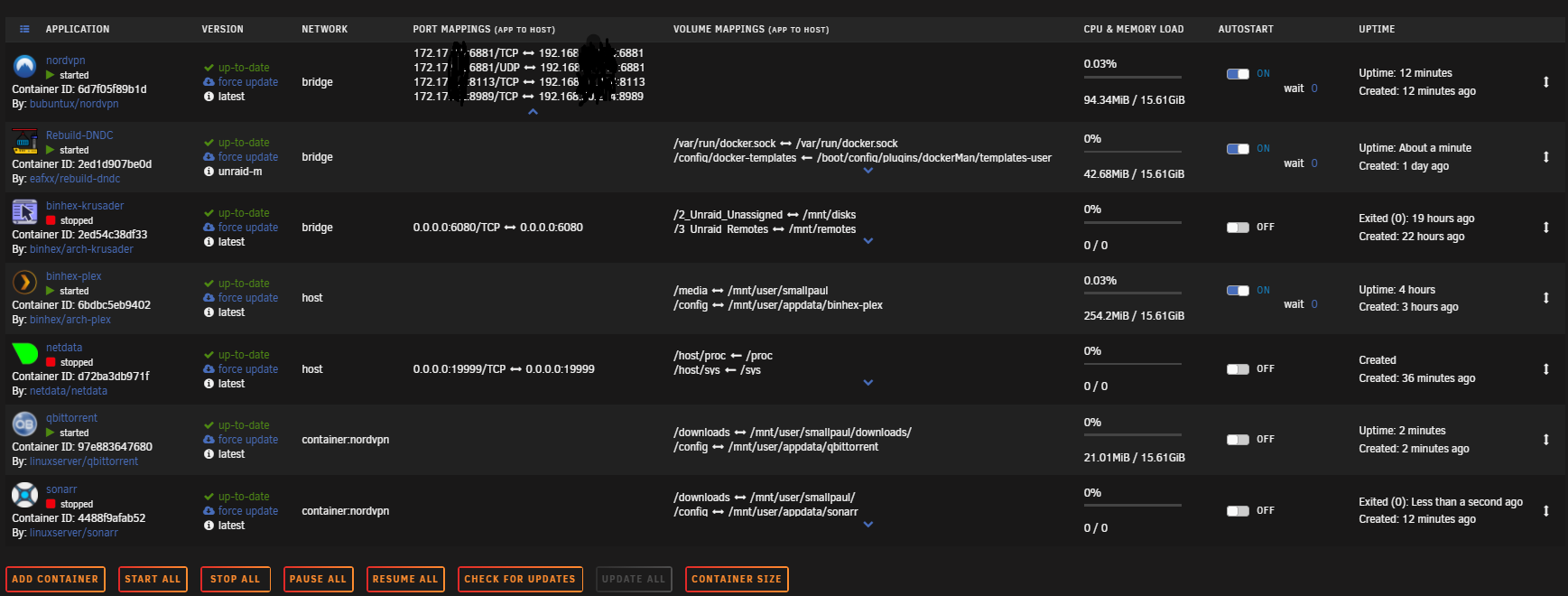

@shiftylilbastrd so here are my current settings, my default was 8080 but i have sinced changed it to 8113. i believe everything is connected as it should be i just can't access the webui, i'm copying the link directly from qbit settings into my browser and getting "address took too long to respond". i appreciate all of your help and time reading through this so far.
 1509480333_currentdockers.thumb.png.d18d28c4920524852ecf460d96cc4d3d.png676734313_currentqbit.thumb.png.769c1128b43690010c9b4c56e6df6d42.png1342250065_nordcurrent.thumb.png.916177de82ef439a69c0687d90d1b711.png
@RenaldoI see you have Sonarr routed through there too. Can you access it's UI?

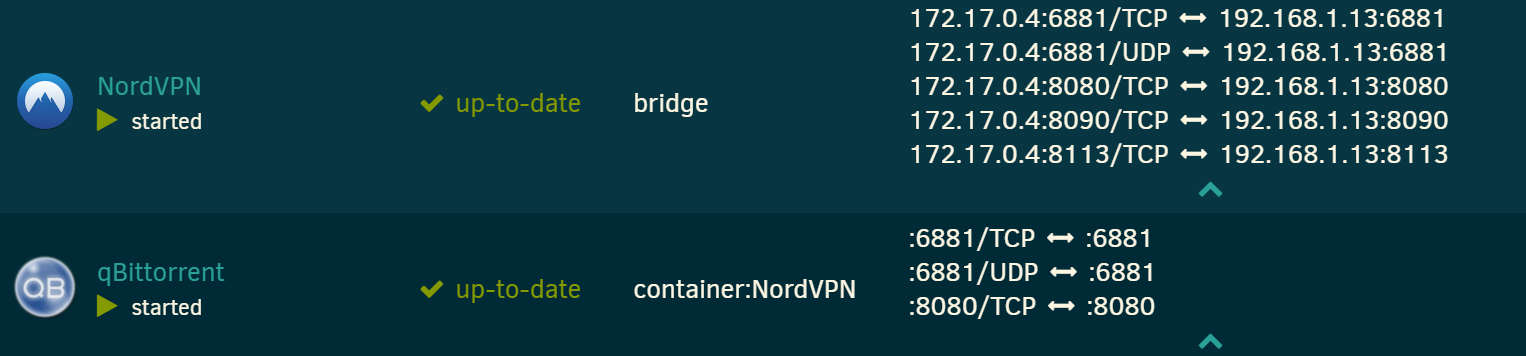

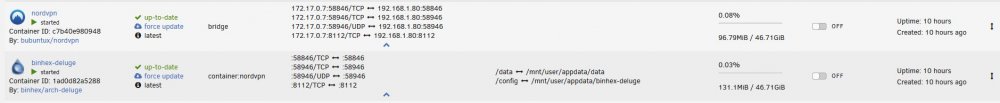

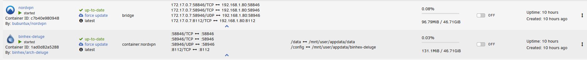

I do notice one thing. Even though I've removed the port mappings it still looks like below. All my containers show the ports they're using but I don't see that on yours. What version of Unraid are you running?

@shiftylilbastrd no, i can't access sonarr UI either. i'm on 6.9.2, i only just installed unraid for the first time this week. got most things i need working but this is stumping me.
