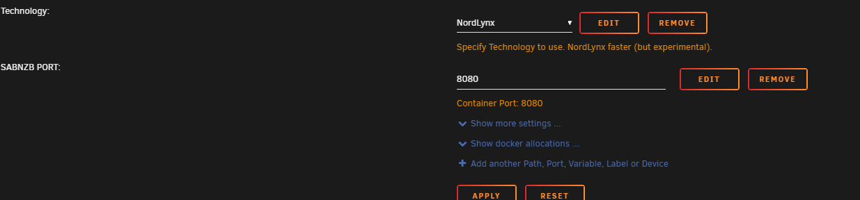

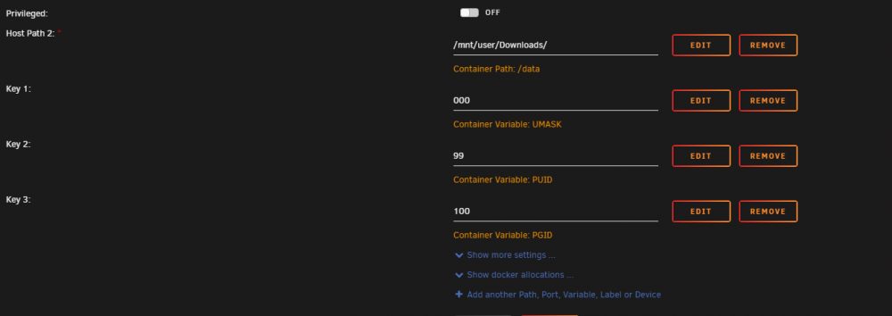

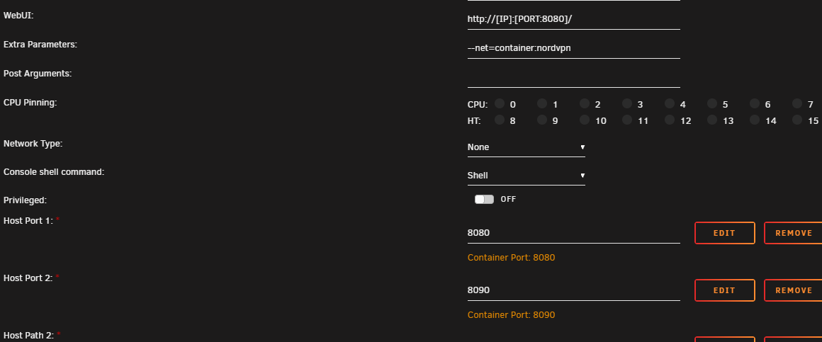

    Hello, Setting up the nordvpn docker and it's working when i do the curl ifconfig.io it is going though the VPN but nothing else is. when I go to the logs it's stuck at connecting? Thanks

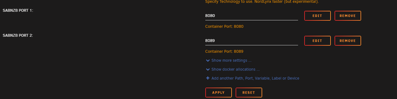

  2. Yes im using my server IP 10.1.x.x and typing 10.1.x.x:8080? Also :8089 same results

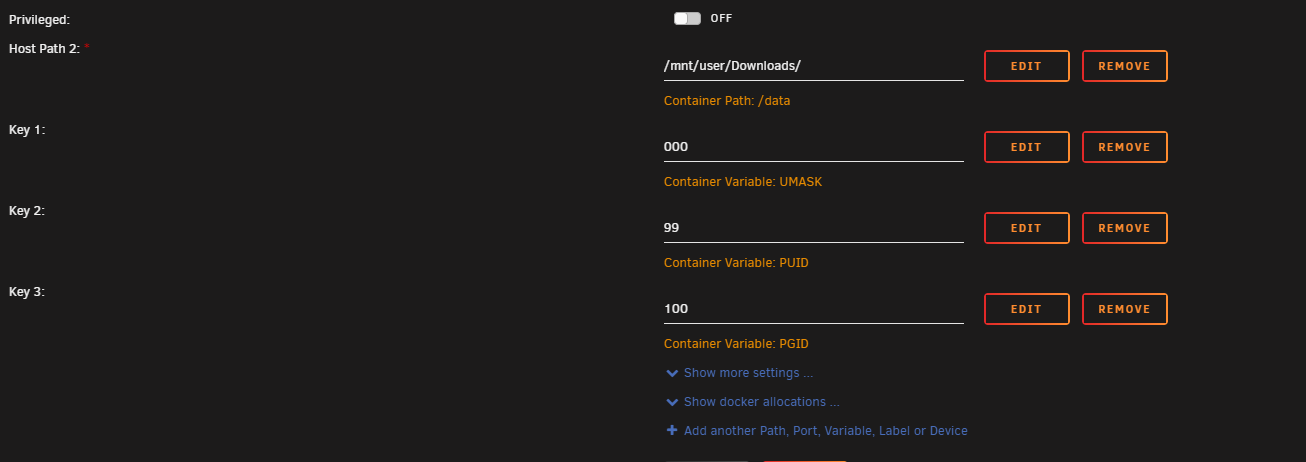

  3. Removed the 2 ports 8080,8089 from SABNZB added them to nordvpn still cannot access the UI via browers serveraddress:8080 or 8089? Thanks! SABNZB NordVPN
  4. I have nordvpn setup and working and have sabnzb running though it but I cannot connect via browser server address:8080 ? I tested with Radar and was successful. Thanks sabnzb nordvpn

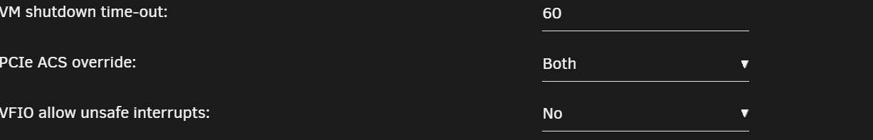

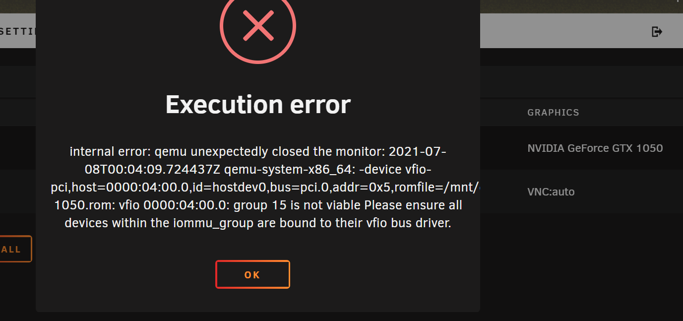

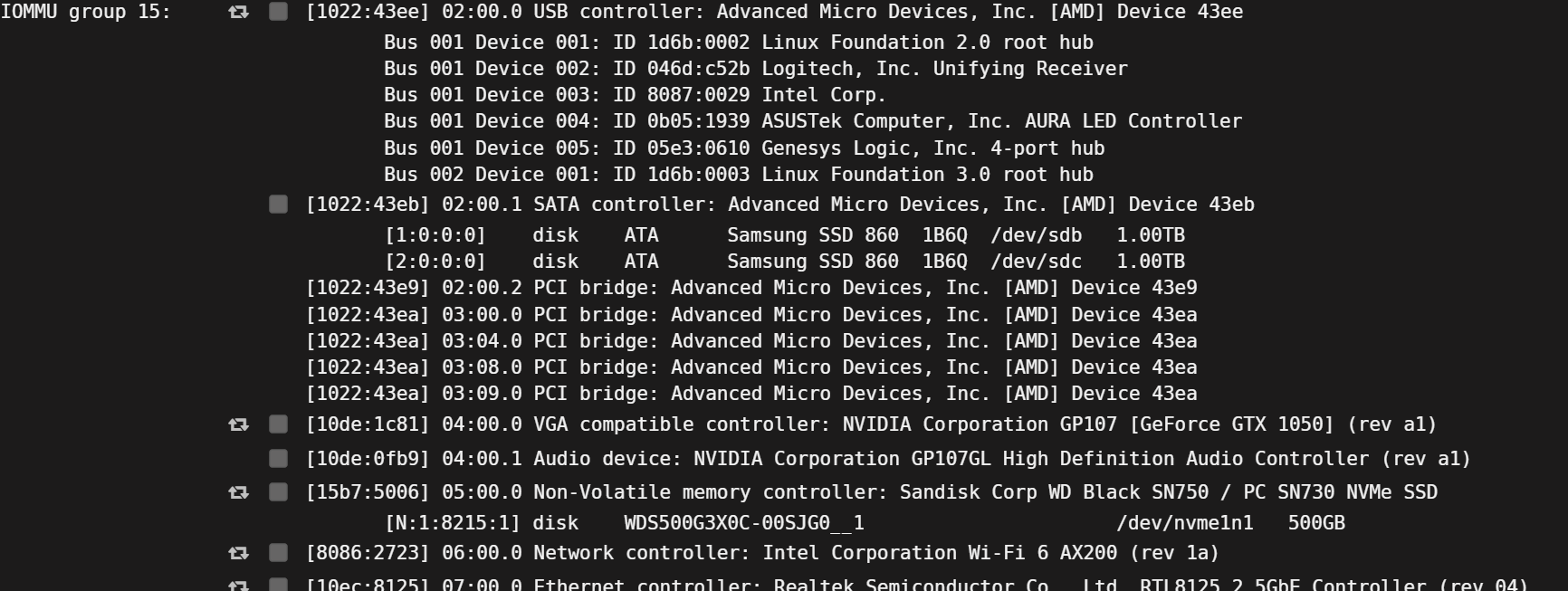

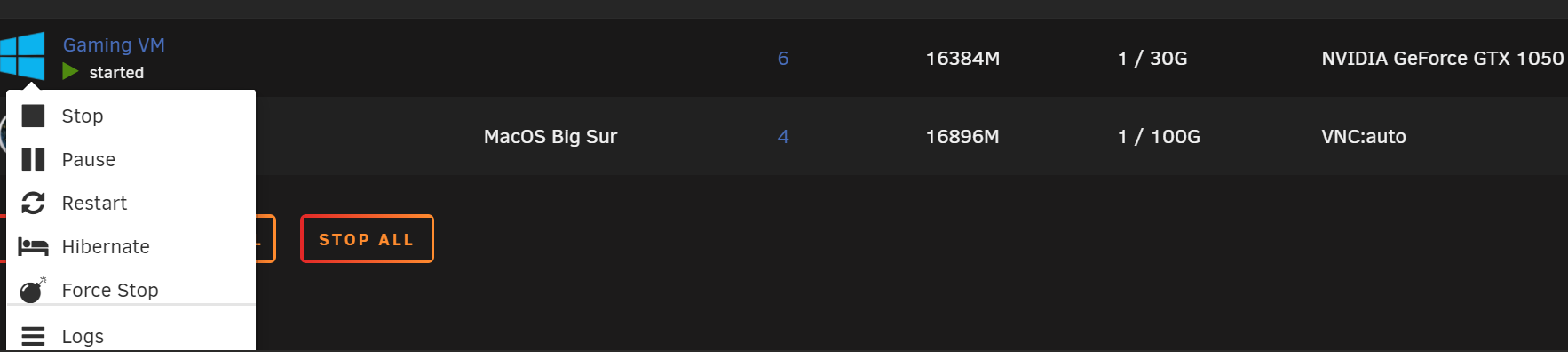

  9. Sorry about that. Now it's enabled I reran the vbios dump said to bind gpu to vfio did that (rebooted) but getiing new error when running it? Also VM will start but cannot open it? Okay dumping vbios file named to the location /mnt/user/isos/vbios/ /tmp/user.scripts/tmpScripts/VBIOS Dump/script: line 301: /mnt/user/isos/vbios/: Is a directory Um.... somethings gone wrong and I couldn't dump the vbios for some reason Sometimes when this happens all we need to do to fix this is 'stub' or 'bind to the vfio' the gpu and reboot the server This can be done in Unraid 6.8.3 with the use of the vfio config plugin or if you are on Unraid 6.9 or above it can be done directly from the gui in Tools/System Devices .....So please do this and run the script again
  10. Made the changes but still not working same error msg. Did I miss something? <hostdev mode='subsystem' type='pci' managed='yes'> <driver name='vfio'/> <source> <address domain='0x0000' bus='0x04' slot='0x00' function='0x0'/> </source> <rom file='/mnt/user/isos/vbios/GTX 1050.rom'/> <address type='pci' domain='0x0000' bus='0x00' slot='0x05' function='0x0' multifunction='on'/> </hostdev> <hostdev mode='subsystem' type='pci' managed='yes'> <driver name='vfio'/> <source> <address domain='0x0000' bus='0x04' slot='0x00' function='0x1'/> </source> <address type='pci' domain='0x0000' bus='0x00' slot='0x05' function='0x1'/> </hostdev>

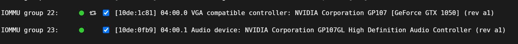

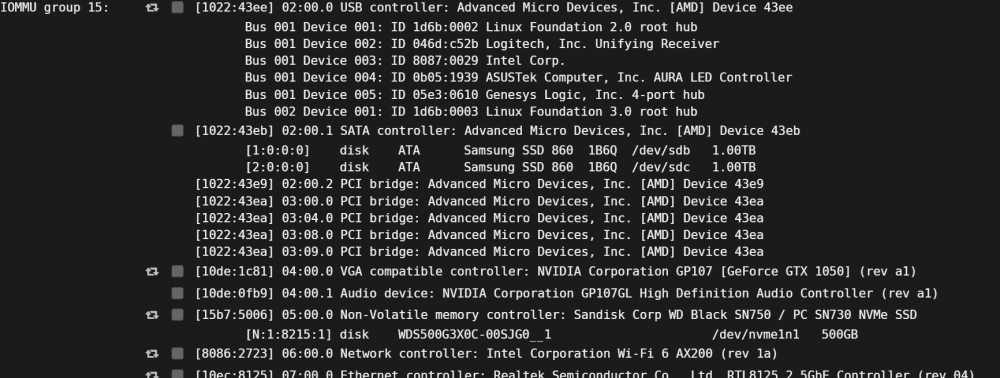

  11. Hello, Trying to passthough a gtx 1050 loaded the nvida driver app for unraid used spaceinvaderone vbios dump to get the vbios have the card and vbios in the VM getting this error also getting error? The GTX is in grp 15 but don't understand the rest? The box to bind VFIO to boot is greyed out if that matters. ASUS TUF Gamining B550-PLUS MB Ryzen 7-3700x deathstar-diagnostics-20210707-2134.zip

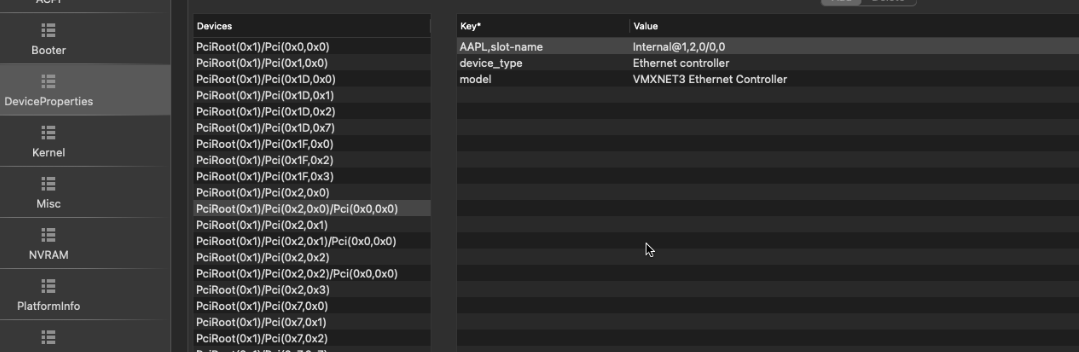

  12. Clearly i'm a idiot Nothing is showing up in xcode?
  13. What app do i open the config.plist in? I tried opencore but dosen't match you pic I tried to added but it did nothing. Sorry I'm blindly following you.

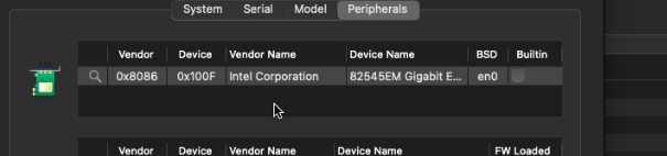

  14. Ok i have EN0 but the bulitin is not checked nor can i check it so I ran the 2 commands sudo rm /Library/Preferences/SystemConfiguration/NetworkInterfaces.plist sudo rm /Library/Preferences/SystemConfiguration/preferences.plist rebooted the Vm still uncheck do i need to continue with the next step? Dosen't say anything about having EN0 and box not checked. Don't want to make things worse. Thanks Once done reboot and check again. If this doesn't work, add NullEthernet.kext (opens new window)and ssdt-rmne.aml (opens new window)to your EFI and config.plist under Kernel -> Add and ACPI -> Add respectively. The SSDT is precompiled so no extra work needed, reminder compiled files have a .aml extension and .dsl can be seen as source code.
