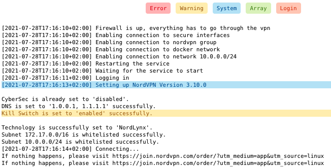

Anyone else having problems with getting stuck in "Connecting..."? It appears that a VPN connection is still established successfully, as when I route all traffic from a Firefox Docker through the NordVPN container and visit https://nordvpn.com/de/what-is-my-ip/ it tells me that I am protected and the IP address and the geolocation differs from my actual ip address/location.
Though if I manually specify a preferred server (CONNECT), then no docker container is connected to the Internet (as I enabled KILLSWITCH).

I have the same issue, stuck on connecting.
Try to change the protocol to "openVPN" instead of NordLynx
Did not help, still stuck on "Connecting..." 😕
Yes last line in the logs should be "Connecting...", but it will work
Mine is stuck on connecting but works (where it didn't before)
The container dies every now and then though. sometimes it takes an hour, sometimes 3 days
Yes I can confirm that it works although it shows "Connecting...". But this is not the expected behaviour is it? Nevertheless, at least it does work :D

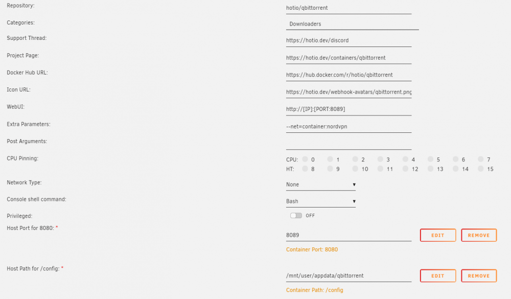

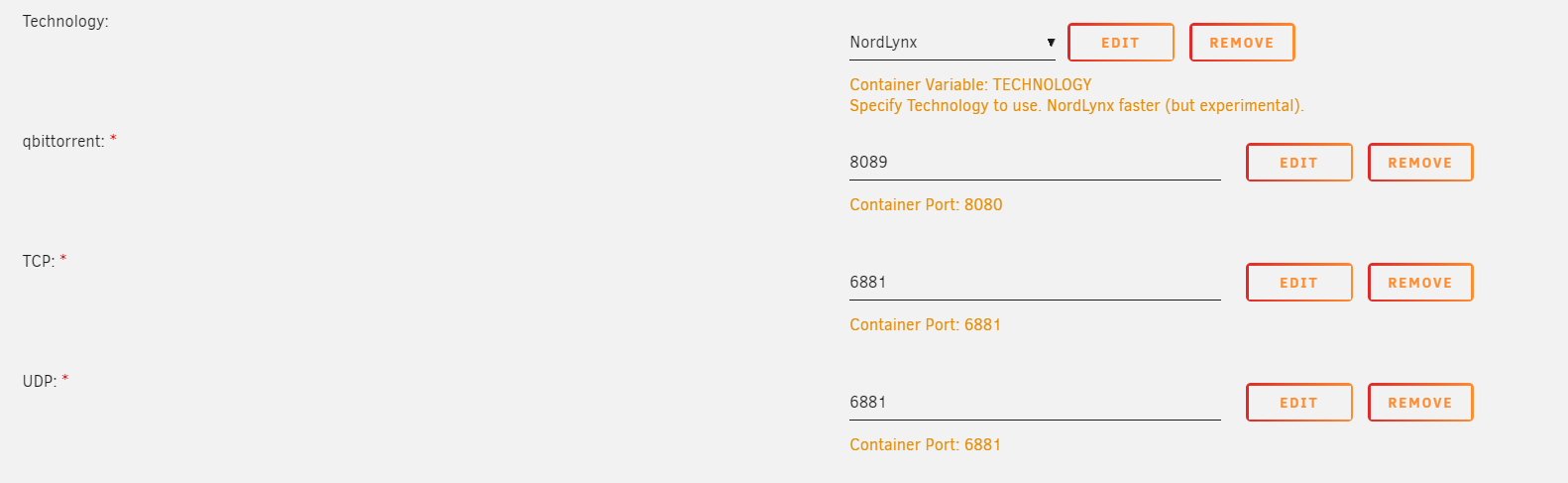

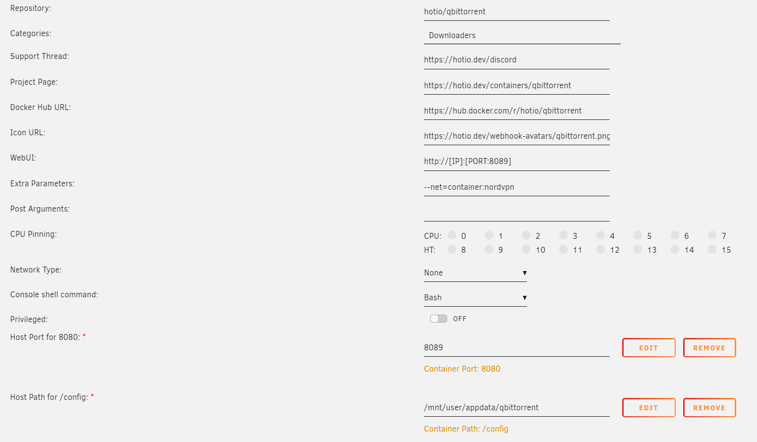

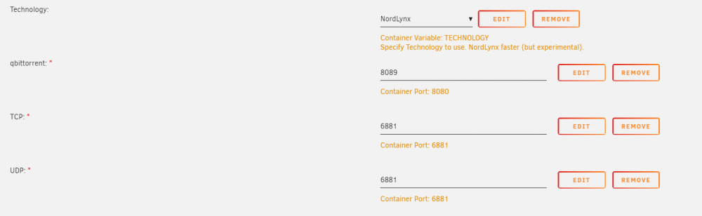

Still having trouble with this?  It looks to me like you changed the container port for qbitttorent.  I am using hotio's docker template, but should be similar for you.
qbitttorent's container typically uses port 8080.  This port is already occupied on my setup, so I modified it to 8089, but you need to leave the container port as 8080.  See attached screenshot.
Then in the nordvpn container you have to map the host port 8089 to container port 8080.  See attached.
You should then be able to access the webui by using unraid's ip and port 8089.  You can verify traffic is being routed through the nordvpn container by bashing into qbittorent and using curl ifconfig.io.

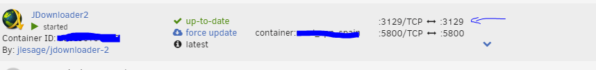

I am having a problem at the moment of setting up Oscam container, running through nordvpn app.
When I try to define the container ports in Oscam docker, I can not map 9000 (dvbapi port, needed by tvheadend to connect with it).
Running Oscam alone (custom network), port 9000 is mapped correctly, but when running through nordvpn it does not appear mapped in unraid docker´s webpage. Only 8888 (webui) appears as mapped 🙂8888/TCP <->:8888).
I have also JDownloaded setup to connect through nordvpn with 3 different ports openned with no issues.
Any idea?

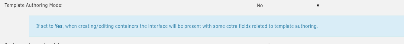

If it does not give you the option to map both the container and host port, try turning on Template Authoring Mode.  Go to settings --> docker -->enable docker = no-->apply.  Then turn on Template Authoring Mode and start docker back up.
Sorry, I am not undestanding, what do you mean with start docker back up?
If it means "enable docker", I tryed but everything continues the same. only :8888 showed as mapped.

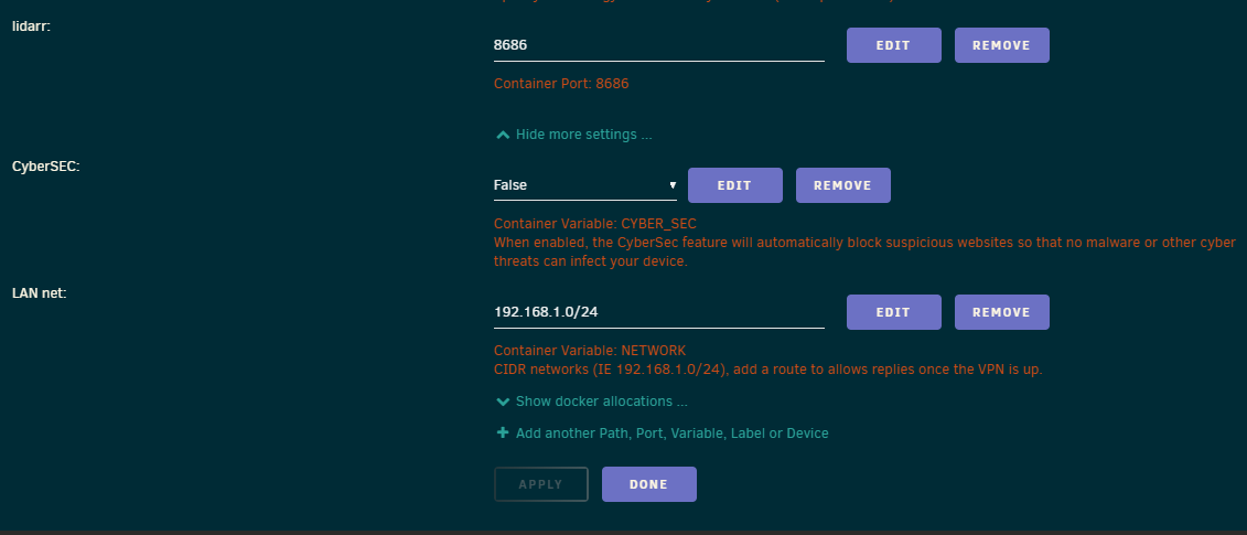

On 8/19/2021 at 1:16 AM, SimpleDino said:
@Zotarios
Just like some of the people here I can not access the webui of the docker that has been routed through the NordVPN container.
  1. NordVPN - NordLyx: Works fine, Confirmed it via console and getting correct ip for specific country requested in template (even though logs show at the end ...connecting...)
  2. Lidarr with port :8685 - network type has been set to None and extra parameter to --net=container:nordvpn
  3. NordVPN - Lidarr port 8686 has been added (also tried setting requested to yes but to no veil)
  4. trying to access webui with [UnRAID IP]:8686 but still no success
Followed these step per SP1's instruction but can't any to work! Need help solving this?
A follow up question, is it possible to download in speedtest-cli in the container? if yes, then what linux command should be used here? because sudo doesnt work and this is not an archlinux so no pacman.
Does Lidarr container show the port :8686 mapped in unraid docker webpage?
On 8/20/2021 at 12:07 PM, SimpleDino said:
Yes, it does.
I had the same problem and finally realized I wasn't reading the nordvpn container's NETWORK variable closely enough (under 'more settings'). The default LAN it specifies is 192.168.0.0/24 and my LAN is 192.168.1.0/24
As soon as I changed it I could access lidarr through the web ui. I hope this easy change works for you too!
14 minutes ago, SimpleDino said:
Okay, then that means I have to add a route (192.168.1.0/24) in network settings - Route settings, correct? if the connecting is up!
I just changed it in the nordvpn docker config like shown in my screenshot. Click on 'Show more settings' and if the IP range listed on the 'LAN net' section doesn't match your server, change it to the correct one. If it already matches, then you have a different problem and my fix won't help.

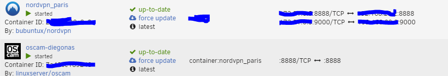

Any idea about this?
I have also tryed creating both nordvpn and oscam containers using docker-compose (both in the same .yml file) but it results in the same issue.
Only mapping in the .yml file the ports 8889 and 9000; nordvpn is creating correctly (with this both ports) but oscam container is created only with port 8888 (even when I haven't created it as an ENVIRONMENT variable)
It seems like the container is primary builded and the image only accept port 8888 in this network mode.
Edited by dellorianes
OK. Thanks for sharing. Helped me to solve the problem. Was looking a long time for a solution now. The setting should not be on Advanced settings => should be on top of Basic settings. However .. sabnzbd is now working like hell with nordvpn and nordlynx protocoll.
yea I agree, if the NETWORK variable was more visible it would probably avoid a lot of confusion. Glad to hear you got it working!
