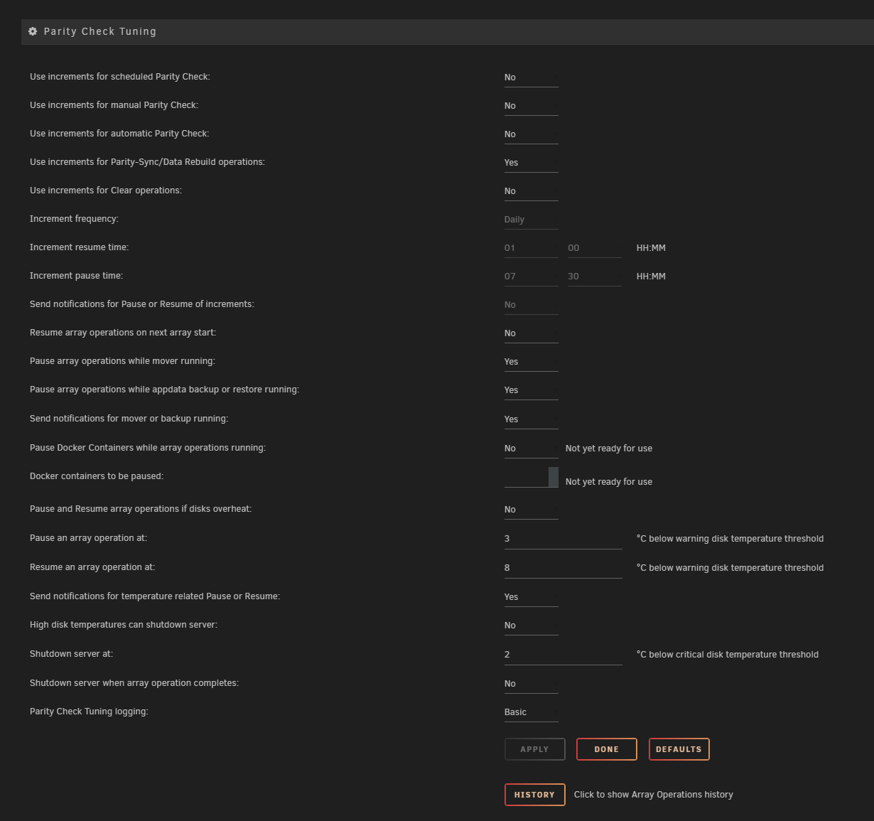

  2. Absolutely did not think about that page. Should I turn of the increment rebuild?
  3. Hello, I have exchanged an 8TB hard disk for a 16TB hard disk to get more storage space. The data rebuild started normally, but was then paused the next day. I was able to start it again, but it was paused again the next day. When I clicked on resume again, the process started all over again. Am I missing something? Attached is the diagnostics file. tower-diagnostics-20240913-1241.zip

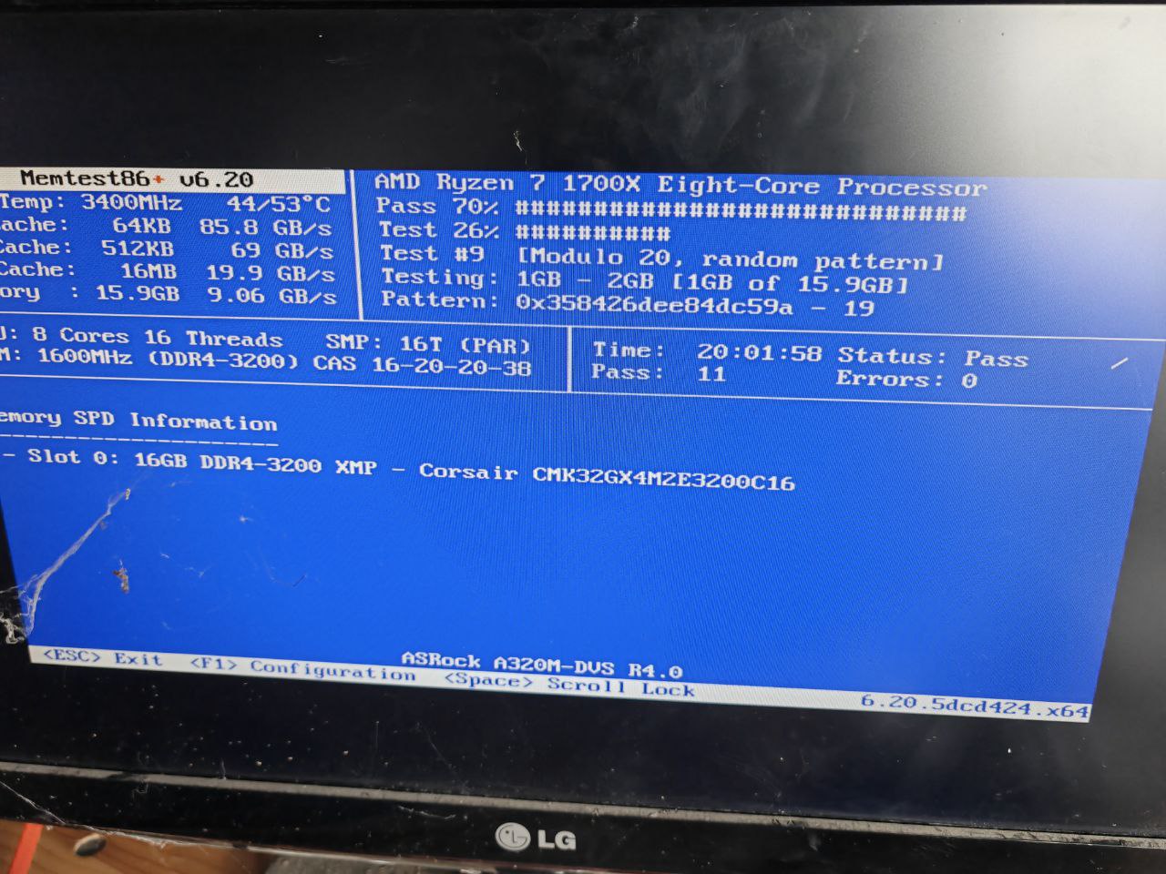

  6. Yes, restarted the server more than one time after hanging and after restart without doing anything else it freezes again. Interesting is, that in the meantime of the memtest nothing everything was okay. But maybe that was coincidence. syslog-10.10.10.21.log
  7. Yes, image attached was the third run. Did the automatic starting run twice and than choose every test that was possible to choose and let it run. Image is from yesterday. It run longer until now and still no errors.
  8. Are there any hints in the logs as to what could be causing the crash or the system hang? The server ran for months without any problems or dropouts, I just installed the same components in a new case and replaced the hard disks. In the course of this I only updated UnRAID to the latest version, but at least I had no problems with this on my other system.
