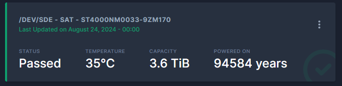

Okay, i think i made progress, but still cant add drives. Both seagate drives are older drives and have been powered on for about 65850hours each, which is more than the 2 byte value maximum of 65536 (2^16) that i believe is causing this issue. So for very old drives, i bet you will see this type of behavior. My theory is there is an overflow issue causing this. I dont have a fix, but maybe increasing the value to 4 bytes for drive power on hours, that could fix this.
I noticed an overflow in the Scrutiny docker that was giving me 94584 years for the drive power on age. So maybe same issue is happening here. When running
'''smartctl -a /dev/sde''',
i get
'''9 Power_On_Hours          0x0032   025   025   000    Old_age   Always       -       65850''' .
As long as smartctl outputs something, Disk Location is quite agnostic to the numbers themselves. If it fails with smartmontools, then there's not much I can do.

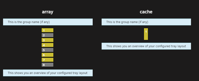

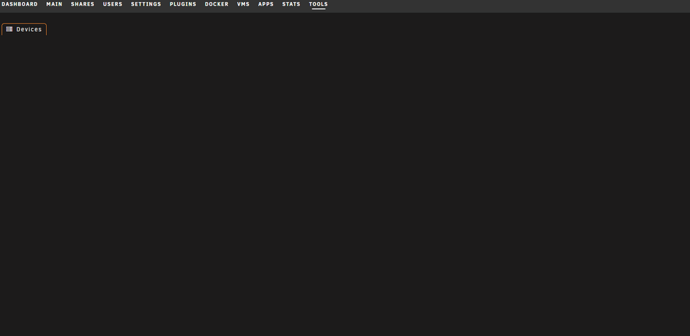

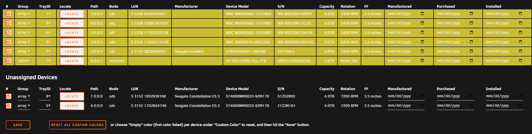

Here is the output. Text file is attached. Gui failed after allocating all drives (specifically the seagate ones)
Before allocating any drives:
sqlite3 /boot/config/plugins/disklocation/disklocation.sqlite "select * from disks WHERE model_name LIKE '%ST4000%';"
1|1:0:0:0|sdb|5 3152 1952939168|Seagate Constellation ES.3|ST4000NM0033-9ZM170|1|S1Z02RXX|38|829121594|273|4000787030016|128|7200|3.5 inches|0|0|0|0|0|512||||||h|||||||||||7188dcf85b0bf9bc5eb9e75e35611f911d8b2b9a9b8fe8672bc78f34a520a769
4|4:0:0:0|sde|5 3152 1702654746|Seagate Constellation ES.3|ST4000NM0033-9ZM170|1|Z1Z2N1B1|37|829121404|250|4000787030016|128|7200|3.5 inches|0|0|0|0|0|512||||||h|||||||||||7a031baba6459e6253cd96f09039e75606346675d18fb0d38def5b7e178a19a6
sqlite3 /boot/config/plugins/disklocation/disklocation.sqlite "select * from location;"
(no output)
sqlite3 /boot/config/plugins/disklocation/disklocation.sqlite "select * from settings_group;"
1|array||column|1|8||h|1|1|400|70
2|cache||column|1|1||h|1|1|400|70
After allocating all drives (gui fails again):
1|1:0:0:0|sdb|5 3152 1952939168|Seagate Constellation ES.3|ST4000NM0033-9ZM170|1|S1Z02RXX|38|829121594|273|4000787030016|128|7200|3.5 inches|0|0|0|0|0|512|||||||||||||||||7188dcf85b0bf9bc5eb9e75e35611f911d8b2b9a9b8fe8672bc78f34a520a769
4|4:0:0:0|sde|5 3152 1702654746|Seagate Constellation ES.3|ST4000NM0033-9ZM170|1|Z1Z2N1B1|37|829121404|250|4000787030016|128|7200|3.5 inches|0|0|0|0|0|512|||||||||||||||||7a031baba6459e6253cd96f09039e75606346675d18fb0d38def5b7e178a19a6
1|1|7188dcf85b0bf9bc5eb9e75e35611f911d8b2b9a9b8fe8672bc78f34a520a769||8
2|1|c34571068a6a2d7be41c5bb8be58f37e4890ccb5e35ac06b745f203eb4b14fe1||7
3|1|79133b9e7b461340c118613acbcc2a7a3da02f40c0174009cd35c59036c571e3||6
4|1|7a031baba6459e6253cd96f09039e75606346675d18fb0d38def5b7e178a19a6||5
5|1|b3e9e72973cf742fee821f8285d22cbce24df1034637fcde4c658c12a8c6b879||4
6|1|e8c9327e867ee3825211a07aa7678ea9d87fd5d0c84af112308ab1487dcd7732||3
7|1|8fe46dbc1ddaa0e5ba2506df07975db8806fed69f75815070730e523ec6f9880||1
8|2|704631c8ba99efd8c0a8992db9d730781e8757956639e975119a545d7f0e6939||1
Thanks again for any help!
I still can't see why this would fail, everything seems to be in order and added as they should. Even after GUI fails.
I think I might need to see a PHP debug:
1) go to Tools -> PHP Settings
2) clear the logs if it contains anything
3) set Error Reporting to "All categories" and "apply"
4) go to Disk Location and setup the drives that fails
5) when GUI fails to load (wait 1 minute or so), delete the database/plugin folder
6) go back to Tools -> PHP Settings
7) view the log and attach it here (check for sensitive data before posting).
8.) set error reporting to "default" and "apply"
