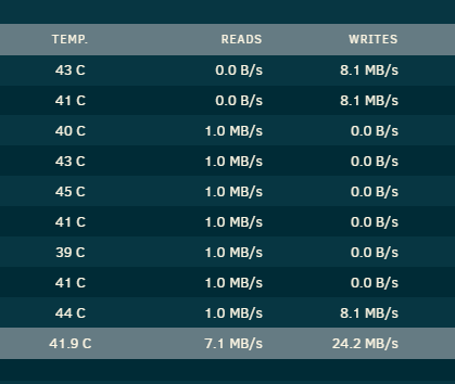

  7. Yes. Exactly that. Even after terminating the dd script I am now seeing writes on the empty drive.

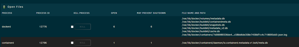

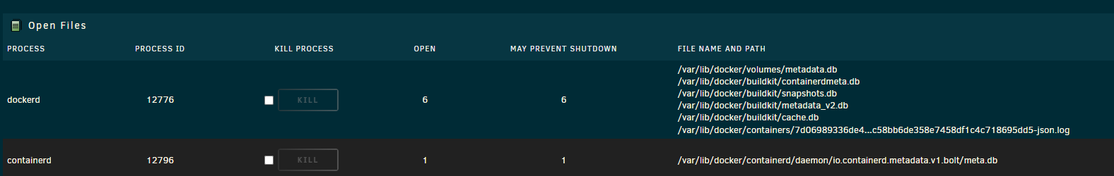

  8. I have stopped Docker services but when I go to Open Files I get this:

  10. So it will be safe for me to cancel the dd command, stop array and go to a new config?
