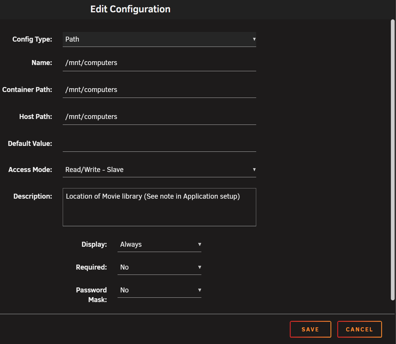

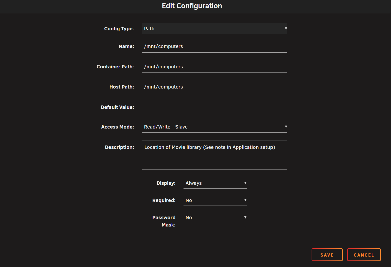

  14. Post your radarr mappings. Post your docker mappings. Make sure the mapping to your mount uses R/W Slave:
