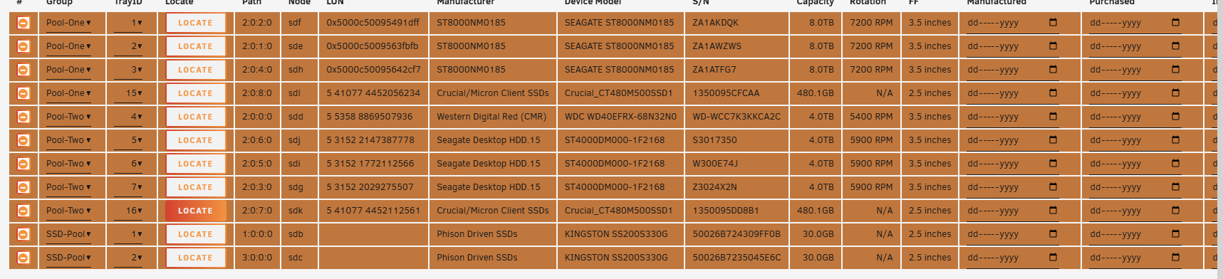

My colors for the drives don't apply.
I want to change the 2 lowest drives to another color.
I select:
Save, and the color is back to the orange one. It does not apply.
What could cause this issue?
I know there's some bugs with the custom colors, however it should mostly work.
You can first try to press "Reset all custom colors", then you must make sure you don't use the same colors as defined under "Common configuration" for custom colors under "Tray allocations". They can also NOT be in "heat map" mode.
