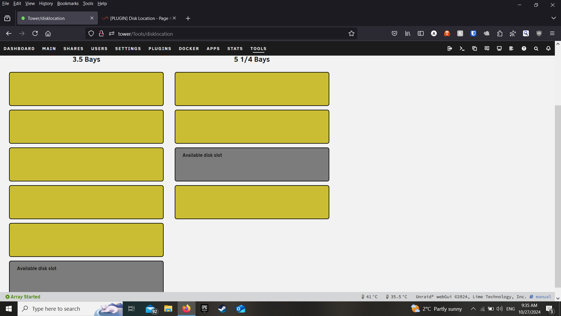

@FlamongOle Is it possible that the Unraid dashboard is a white page without showning anything after the latest plugin update?
OK, restoring database from old version did not the trick, but as SuperMario86 suggested, the led style change did return the dashboard to normal behaviour.
Edited by CHAU

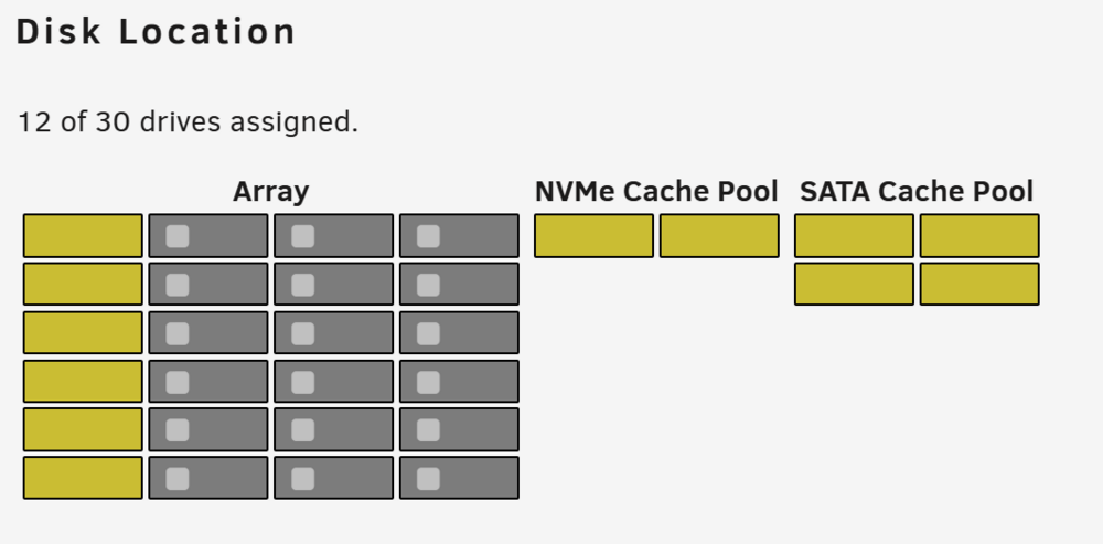

My dashboard is back.  It looks like by drive data is there under information but they show blank on the tray screen.
Same here.
Just go into the plugin on the configuration tab and pick  any boxes to be displayed from "Visible Frontpage Information" be sure to save to take effect.
Edited by Gragorg
That did the trick.  Many thanks!!
