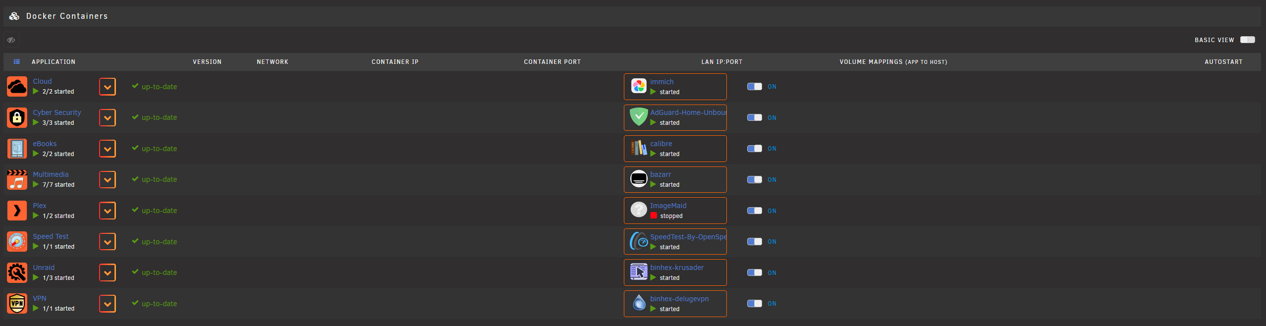

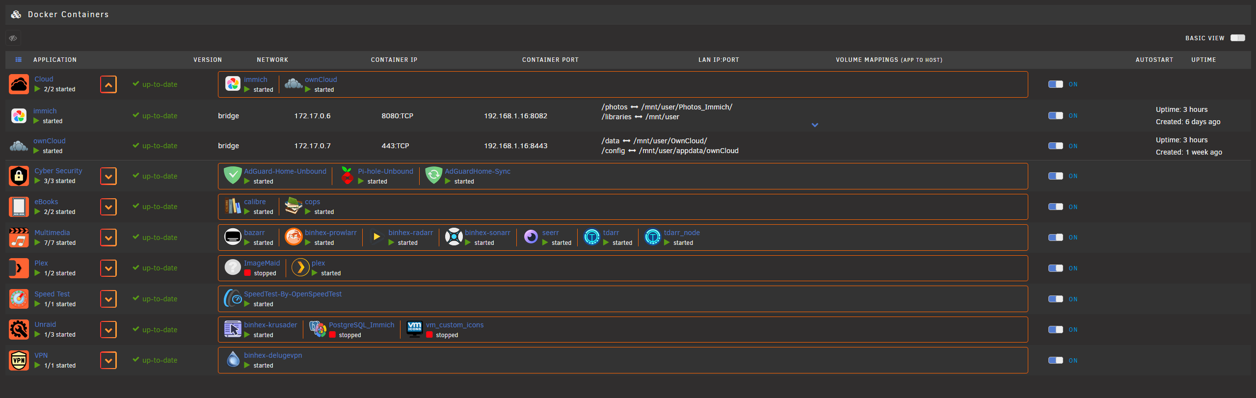

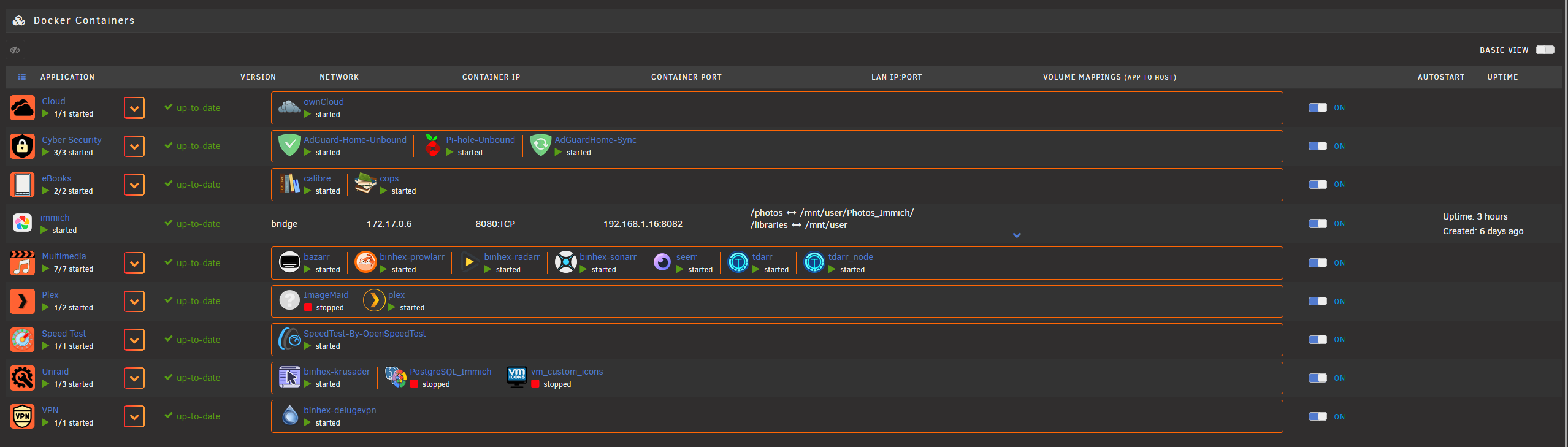

  3. FolderView 3 fresh install I'm experiencing this bug : When I finish adding an app to a folder the preview is truncated. The only way to see the entire folder preview is to leave an app outside a folder or to expand the content with the arrow down on the left side. I don't have any other app that may interfere with folderview3. I create the folder as I did on folderview 2 so, nothing out of the ordinary. What is wrong here? Please help.
