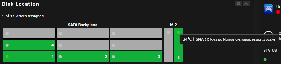

  • Commit #274 - ISSUE: As some or all NVMe devices does not output standby mode on SMART info, I have set the drive to be overridden as "ACTIVE" regardless as long as it is a  NVMe device and is detected by SMART and the system at all.
@mikeyosm you can try to update the plugin now and see if it helps.

11 hours ago, FlamongOle said:
Update 2024.02.19
Updated, did a force scan all, refreshed but unfortunately no change 😞

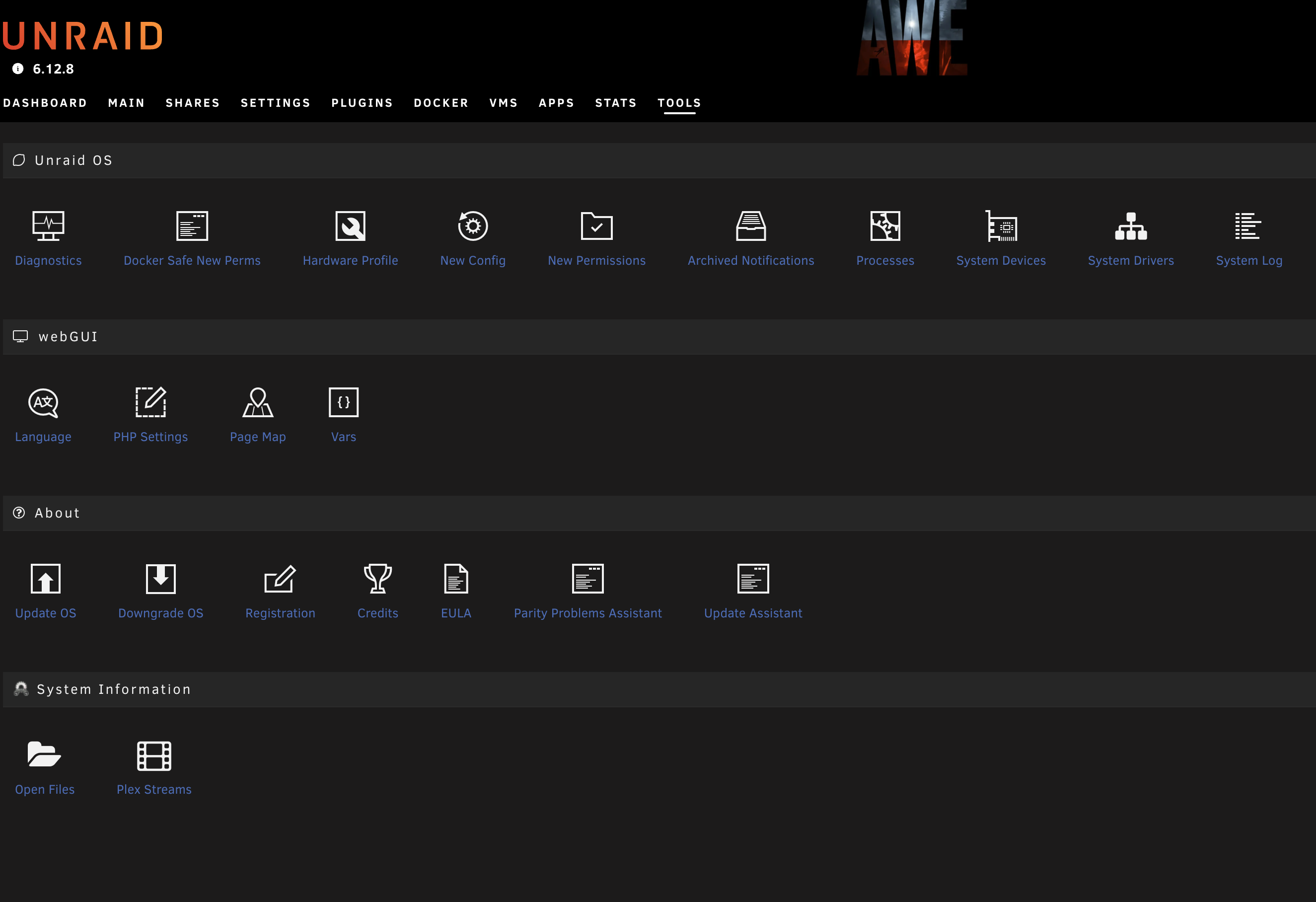

Updated and can't find it in Tools :/ even after a reboot
Both of my servers shows up in Tools -> Disk Utilities. Reboots will "never" be required
Edited by FlamongOle
Reboot was because of another thing but it still doesn't show up. No Disk Utilities at all.
672581535_CleanShot2024-02-23at08_58.03@2x.thumb.png.6e7a08a67a37e84b81e0bceffa1513aa.png
Edited by Sptz87
I'm seeing what's going on now. I thought "Disk Utilities" was a default Unraid section, but it was created by "Pre-clear" plugin.
You can still access the plugin via "Plugins", then I'll sort something out soon-ish.
Just include the exact same page file preclear is to create that section
Yes, just did. Thanks ;)

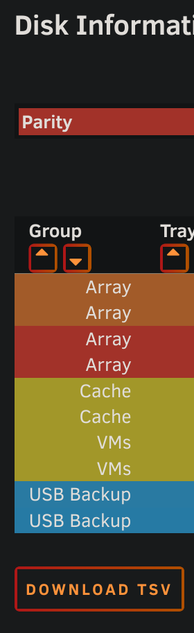

TSV is correct? Or CSV?Screenshot_20240224-211559_Firefox.thumb.png.63c37cf8d130934579604a3c5d9a3233.png
TSV stands for Tab Separated Value. TSV file is a flat file, which uses the Tab character to delimit data and reports one time-series per line. CSV stands for Comma Separated Value. CSV file is a flat file, which uses the comma (,) character to delimit data and reports one observation per line.
https://wikis.ec.europa.eu/display/EUROSTATHELP/Which+are+the+available+formats#:~:text=TSV stands for Tab Separated,reports one observation per line.
So: yes, it is TSV
