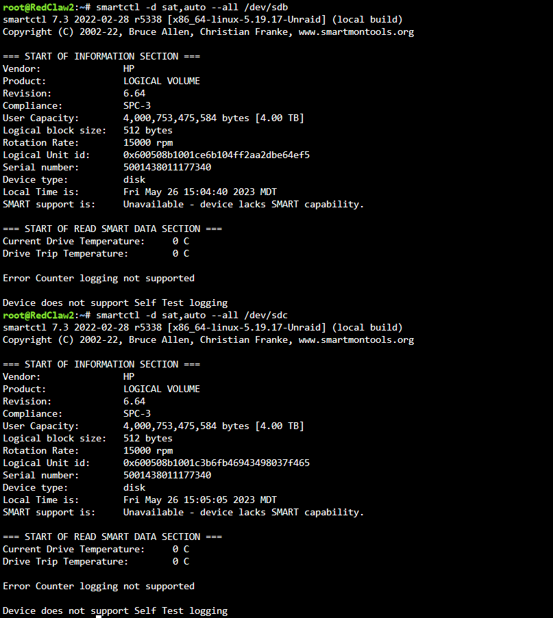

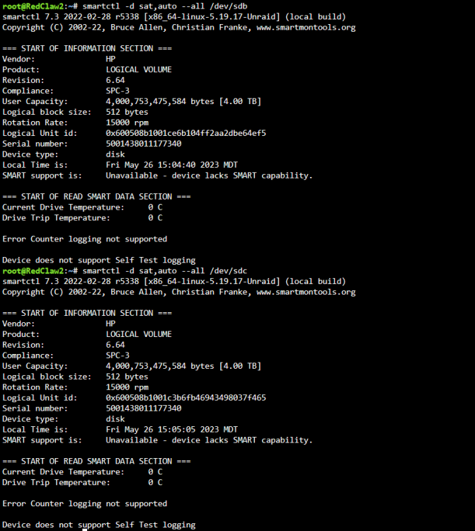

21 hours ago, Parsival said:
Does the logical volumes generate two unique serial numbers? you can probably check that with
smartctl -x /dev/sdb
smartctl -x /dev/sdc
Unfortunately it appears it does not even though there are 2 physical drives.
Then that's the reason, maybe there's a setting to change serial number on the controller or whatever system that is. Maybe bypass logical volumes if possible and run the drives directly? the plugin heavily depend on unique serial numbers, and I never thought this would even be possible.
I will have to get into the controller set up to see if it is possible. It is on a Dl380 G7 server I410 HP Raid controller.
It's been reported problems with maybe a similar controller here:
https://github.com/olehj/disklocation/issues/191
Raid P410 controller, maybe it suffers from the same thing. If it's not reachable with the commandos I gave and cant provide unique serial numbers, then I can't do anything about it.
