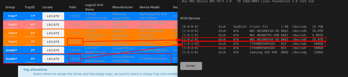

What can i do, when Drives has the wrong Path? The WD Red 10TB and one of my MX500 are swapped.
Tried "Force Scan All"?
interesting. i did this, bevor i posted this here. now i did it again and it should work. looks good now. thanks
