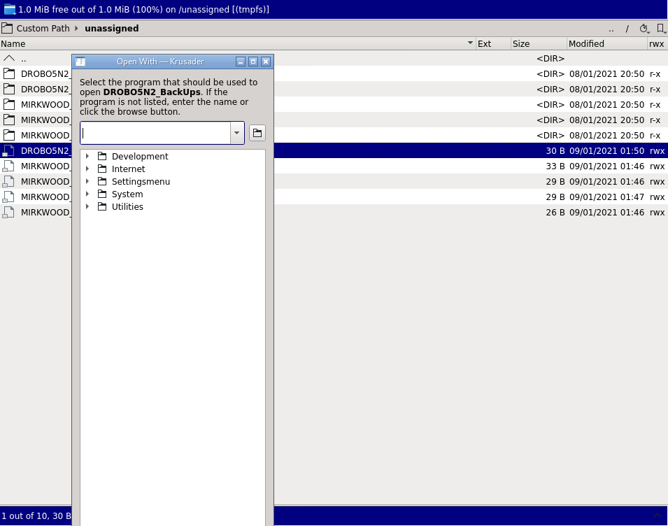

  9. I've successfully installed and configured the UUD using the excellent The ULTIMATE UnRAID Dashboard! video series by Nate Harris however I do have a question about reporting information. I've tried searching the the answer to this but I've not had good luck so I'm just going to ask. I have two Tautulli instances, tautulli-1 and tautulli-2 configured in Varken, reporting on two different Plex servers. My question is how to I distinguish between the two servers while reporting information? As an example Current Streams, Current Transcode Streams, etc are reporting the current streams from one Tautulli server but not the other. How do I select which Tautulli instance the information is coming from? As far as I know Varken is setup correctly and I can pull certain information from each but I can't figure out the Streams issue.
  10. Updating UD and rebooting my server fixed the problem with the symbolic links. Thanks again for your help.
  11. @dlandon, I had already done that and the symbolic links were still there. Just to be sure I made sure that Unassigned Devices had legacy mode turned off and I unmounted and remounted the shares. The symbolic links are still showing up. Maybe the unRAID 6.9.0 upgrade will come out soon and I can reboot the server then and see if that fixes the problem. Thanks again for your help.
  12. Okay, I decided to not fight the system as it were and went in and updated everything to /mnt/remotes/shareName and now everything seems to be working fine with two exceptions. I still have five symbolic links in /mnt/disks and I misentered /mnt/remote instead of /mntremotes with an S in a couple of places and now have a couple of symbolic links there too. Is there a way to get rid of these? I have an app I run in a Docker Container called taskcafe which had it's own taskcafe network listed under network instead of br0 or bridge. I can't remember how I got that initially setup, I haven't gone looking for the solution yet but if you happen to know off the top of your head that would be great. Regardless, thank you all for your help. Linux is not my native OS and when things go sideways on me I can only go so far before way out in the weeds.
  13. Okay, going along on this theme I decided to rename one of the Unassigned Devices Mount Point names. I changed DROBO5N2_Music to DROBO_Music. Krusader still showed it as a file and wouldn't do anything but pop up the dialogue box on what app to open it with however in the Terminal command line I was able to navigate to /mnt/disks and do a directory. I could still see the DROBO5N2_Music which should have gone away I would have though and I also saw the new DROBO_Music@ with an "@" at the end of it. However, I was still able to /mnt/disks/DROBO_Music, get a directory and see everything like I should. So it's looking like the Unassigned Devices data has gotten corrupt maybe and I don't know where to go clear that out so that I can recreate these shares?
  14. @trurl, so I went in and checked and turned on Legacy Mount Point Compatibility although I don't ever remember having to do that before but it did give me different results from what I was seeing before so progress I guess? Now all 10 SMB Shares that show up in Unassigned Devices are showing up in Krusader BUT half of them are showing up as directories and half of them are showing up as files. The ones that are showing up as directories are still empty and the ones that are files ask me what I want to use to open them when I click on them. I've enclosed a PIC of what I'm seeing below.
