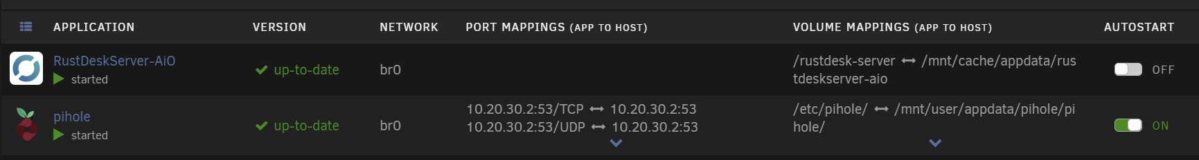

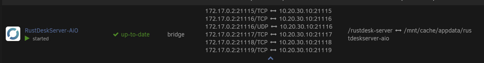

  7. How can the ports be mapped using the RustDeskServer-AiO container? I'm trying to specify an ip on my custom network, like normal when setting up containers. The ports are only mapped when using the Bridge network, and those are internal docker ips. Also, using network Host doesn't map ports. Edit: Well, it works using host even without ports mapped, but doesn't with custom bridges.
