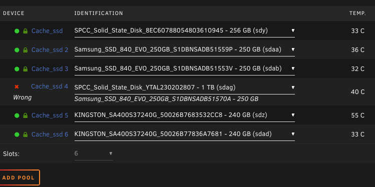

  2. Got ya... Well since those drives were all very old anyway. I removed the old cache_ssd pool and created a new one with 2 new 1TB SSDs. Now that its back up with the new pool I guess I just need to edit my share "logic" to include the new ssd_cache pool where I desire it. Then I'll let it run a bit to see if any more issues come up. Its using the same controller + cables + power cables as before, so if it was a drive it should be fixed. If it is a power cable or such I would expect to see the same issue. *fingers crossed*
  3. Oh my! I assume by "single profile" you mean I was not using btfs version of Raid1 or higher. So I had no redundancy... How did I do that I could have sworn this was setup with at least one spare drive guess I'm wrong. My only option then I guess is to create a new pool. Trying to do that via the GUI I don't see a way to remove the old cache_ssd pool though how can I do that after I remove all the disks and create the new pool?

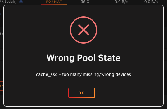

  4. I pulled that drive suspecting it has failed they are old ssds at this point. I was able to replace it with a new larger SSD and I can insert that into the cache pool But when I try to start the array I get an error about the pool. Could have sworn when I did this a few years back it prompted me to format the disk and then rebuild the array.

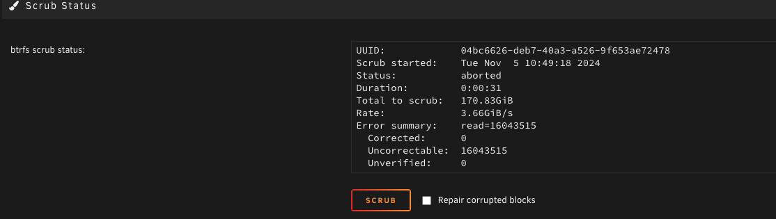

  5. I was able to start the scrub but it quickly aborted Is there one specific drive that is causing an issue? Other than the Hitachi HDD that is unassigned, I need to just remove that after the next reboot I was just testing that drive a while ago. phoenix-diagnostics-20241105-1051.zip

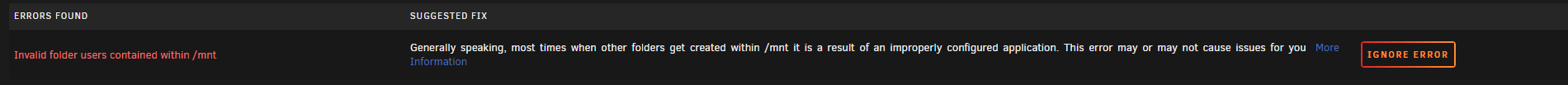

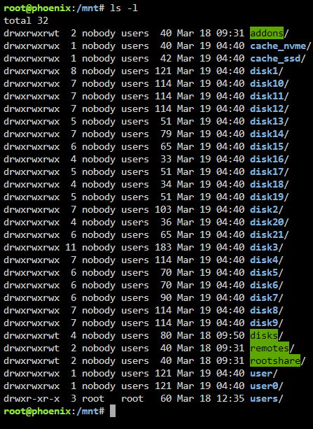

  9. I recently made changes to my Unraid system to use the "new" cache pool options. Creating one for an NVME drive to put docker and VMs on and a second a pool of SSDs for the array. I noticed this error this morning. I'm guessing I setup something wrong with those cache pools? phoenix-diagnostics-20240319-0834.zip

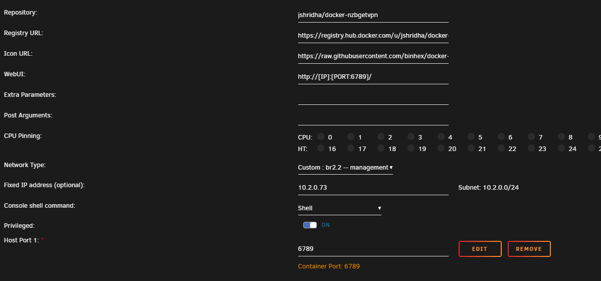

  12. What I'm trying to do I recently did a network upgrade and installed a 10gig NIC in my unraid server. My intention is to separate my network into several VLANs. I have all the networking stuff working, router + switches etc. I believe I have setup the networking in unraid as I should. Settings > Networking I can reach the unraid server on that VLAN (2) as expected. I would like to be able to assign a given Docker Container (or VM but troubleshooting just docker here) to that VLAN. I started with the defaults I already head in the docker settings Docker custom network type: ipvlan Host access to custom networks: Disabled But added a new custom network on interface br2.2. And removed the previous custom network I made sure my local physical DHCP server was passing out IP address in a different range on the same subnet than the DHCP pool configured in docker settings. Then in each container I had running I changed, the network type and set a fixed ip address. For several of my docker containers this seemed to work as expected. However I have two issues that I can't seem to explain. Issue 1 I have an nzbgetvpn container running, when it starts logs indicate its working as normal. I can ping the containers fixed IP address. But when I attempt to connect to the web interface on its ip + port the connection times out. Digging deeper looking at wireshark I can see the containers IP respond as expected to ICMP ping requests, but it doesn't respond at all to TCP traffic to the port for the web interface. During my troubleshooting I change that containers network type, back to "bridge" When I do so in the docker page I see it now has this IP address To my knowledge I don't have anything on my network using a 172.17.x.x address so I have no idea where it is getting that from..... On top of that if I then try to access http://10.2.0.16:6789 I can pull up the web interface of the container??? (Thats the IP address of the unraid host on VLAN2 + the port of the web interface of the container). Issue 2 Moving on to another container... I am running "nut-influxdb-exporter" which tries to connect to the unraid host running the NUT plugin (UPS power stuff) on port :3493 I had this container running with the same custom network I just setup When the container boots I see errors that I can't connect to the unraid host. Dropping into a console for the container I noticed that it can successfully ping other docker containers configured on the same network (10.2.0.68 for example is my InfluxDB container) and it can ping other hosts on that network 10.2.0.1 for example my physical routers interface on this VLAN. But it can't ping 10.2.0.16 the IP of the Unraid host on that VLAN. Even with all my searching over the last week I suspect I'm missing something fundamental about how to get this type of configuration correct. Might anyone be able to point me in the right direction? phoenix-diagnostics-20240311-0624.zip
  13. Well... I think I fixed it... but I haven't a clue how... I change the docker container from the above network type to give it an IP address on my VLAN interface (br2.2) to the "Bridge" network type. after doing this The UI reports the container has an IP of 172. something.... I have nothing on my network or unraid server using that IP range to my knowledge.... But I happen to try putting in the IP address of my unraid server and the nzbget port in the browser and ... there it is working at 10.2.0.16:6789... No idea what that did or how its working unfortunately ...
  14. I think my nzbgetvpn container may have stopped working sometime ago. I got back to doing some upgrades to my home lab. I've setup Unraid with multiple VLANs. I've just moved all my docker containers to one of the new VLANS. "Network br2.2" I can't seem to access the nzbget web ui. When I look at the logs 2024-03-09 12:57:09,145 DEBG 'start-script' stdout output: [info] Successfully assigned and bound incoming port '25361' 2024-03-09 12:57:39,435 DEBG 'watchdog-script' stdout output: [info] nzbget not running 2024-03-09 12:57:39,435 DEBG 'watchdog-script' stdout output: [info] Nzbget config file already exists, skipping copy 2024-03-09 12:57:39,447 DEBG 'watchdog-script' stdout output: [info] Attempting to start nzbget... 2024-03-09 12:57:39,456 DEBG 'watchdog-script' stdout output: [info] Nzbget process started [info] Waiting for Nzbget process to start listening on port 6789... 2024-03-09 12:57:39,460 DEBG 'watchdog-script' stdout output: [info] Nzbget process is listening on port 6789 The service seems to be listening on the port. and I did update the LAN_NETWORK variable and added all my local networks. I can ping the docker containers IP address (10.2.0.73) and get a response but I get no response at all when trying to access the webgui. Looking at wireshark, when I try to connect to the webui there's not return traffic at all from the container. Any ideas what might be wrong here?
