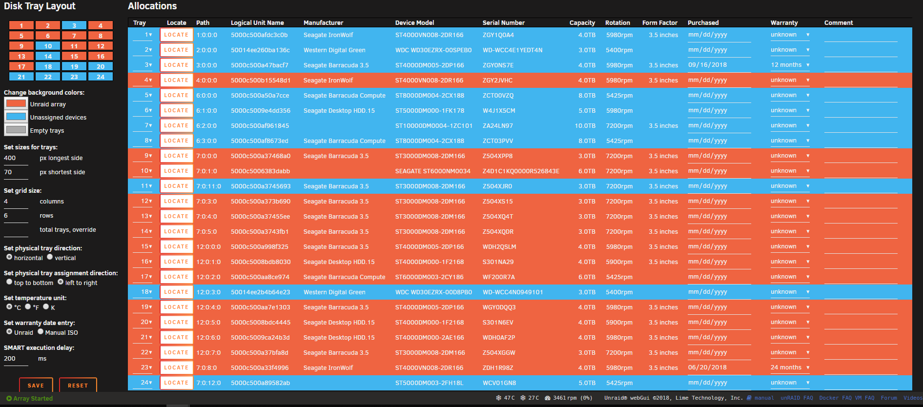

I just installed this plugin and i am unable to make my settings changes stick. I hit save and screen refreshes after 15-20 seconds and nothing has changed from the default. For example i am changing to 4 columns, 4 rows, physical tray assignment direction -left to right and temp in Fahrenheit. When i hit save its still at the defaults.
I am running Unraid 6.7.0-rc2
Any ideas what may be going on?
You are absolutely right, and I know why! It happens only for newly created databases. To fix it before next update, do following in the terminal:
# Download the new development file:
wget https://raw.githubusercontent.com/olehj/disklocation/devel/disklocation/pages/system.php
# And overwrite file with existing:
mv system.php /usr/local/emhttp/plugins/disklocation/pages/system.php
Refresh the plugin/browser and save! ..or wait for the next update release.
worked perfectly! Thank you!
