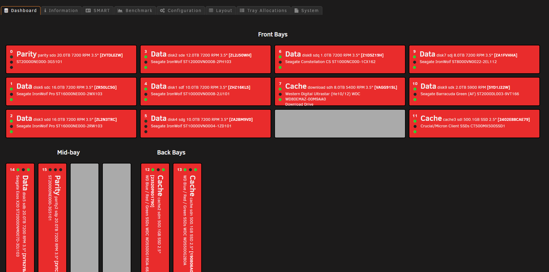

6 hours ago, edival said:
I'm seeing this too. I'm getting everything flashing red with a "S.M.A.R.T. FAILED!" error for every drive (when SMART passes them all perfectly.
Normally, this should give you a text telling you to do a "SMART" update, I don't know why this happen yet. I haven't been able to reproduce this issue myself yet. But if you do a SMART update, (not SMART+DB), does it help? I don't know why yet it should make a difference between SMART and SMART+DB as SMART+DB should be SMART and +DB .. sorry for the confusing text hihi :P

9 hours ago, PsykoNeko said:
Good afternoon, I updated the app and ran force smart+db as it instructed and now all my drive are flashing smart warning. Did I miss a step?
No, that should have resolved it. But as others report, doing just a SMART update might work. Can you try that and report back?
I don't know why that is the case yet, but it's obviously a bug :P
I did that a couple of times. No change.
8 minutes ago, FlamongOle said:
Can you please give me the PHP log for the system page problem? Tools -> PHP -> enable log and set logging to "all" or something. Then give me everything related to "disklocation", sounds like a parse/syntax issue somewhere in a specific situation.
What I immediately found in the PHP log may give you what you need:
text  error  warn  system  array  login

Does that explain what's happening?  Let me know what else you need.

Can you go to "System" tab, click enable "debugging", then right away click disable. Download the log that appears, then give it to me? It do consist of serial numbers and comments etc. (everything store din Disk Location). Feel free to send me as private message.
Also, can you give me the contents of, in terminal:
ls -la /tmp/disklocation/*
ls -la /tmp/disklocation/smart/*
Won't have time to look at it now, but tomorrow/sunday or so. Thanks
Here you go.

#1 /usr/local/emhttp/plugins/disklocation/pages/page_system.php(423): disklocation_system('backup', 'list')
#2 /usr/local/emhttp/plugins/dynamix/include/DefaultPageLayout.php(778) : eval()'d code(5): require_once('/usr/local/emht...')
#3 /usr/local/emhttp/plugins/dynamix/include/DefaultPageLayout.php(778): eval()
#4 /usr/local/emhttp/plugins/dynamix/template.php(94): require_once('/usr/local/emht...')
#5 {main}
  thrown in /usr/local/emhttp/plugins/disklocation/pages/page_system.php on line 211
[14-Feb-2025 18:51:43 America/New_York] PHP Fatal error:  Uncaught TypeError: array_diff(): Argument #1 ($array) must be of type array, false given in /usr/local/emhttp/plugins/disklocation/pages/page_system.php:211
Stack trace:
#0 /usr/local/emhttp/plugins/disklocation/pages/page_system.php(211): array_diff(false, Array)
#5 {main}

Configuration help… Installed on Unraid 7.0.0. Under “System” tab there is no Force SMART+DB option….. the tab is blank? Is this an issue with unraid 7.0.0 or am I missing something?
I have the same issue as @farberm. Empty tab under "System". In addition, if i try to save a setting under the Configuration tab i get this error in the system log:
Feb 15 15:34:08 Tower webGUI: error: /Tools/disklocation - missing csrf_token
Feb 15 15:34:12 Tower webGUI: error: /webGui/include/InitCharts.php - wrong csrf_token
Feb 15 15:34:40 Tower webGUI: error: /Tools/disklocation - missing csrf_token
In PHP log i get this:
[15-Feb-2025 15:19:29 Europe/Berlin] PHP Warning:  Undefined array key 0 in /usr/local/emhttp/plugins/disklocation/pages/page_system.php on line 244
[15-Feb-2025 15:19:29 Europe/Berlin] PHP Warning:  Trying to access array offset on null in /usr/local/emhttp/plugins/disklocation/pages/page_system.php on line 244
[15-Feb-2025 15:19:29 Europe/Berlin] PHP Fatal error:  Uncaught TypeError: array_merge(): Argument #2 must be of type array, false given in /usr/local/emhttp/plugins/disklocation/pages/page_system.php:106
Stack trace:
#0 /usr/local/emhttp/plugins/disklocation/pages/page_system.php(106): array_merge(Array, false)
#1 {main}
  thrown in /usr/local/emhttp/plugins/disklocation/pages/page_system.php on line 106
[15-Feb-2025 15:29:51 Europe/Berlin] PHP Fatal error:  Uncaught TypeError: array_merge(): Argument #2 must be of type array, false given in /usr/local/emhttp/plugins/disklocation/pages/page_system.php:106
Stack trace:
#1 /usr/local/emhttp/plugins/dynamix/include/DefaultPageLayout.php(778) : eval()'d code(5): require_once('/usr/local/emht...')
#2 /usr/local/emhttp/plugins/dynamix/include/DefaultPageLayout.php(778): eval()
#3 /usr/local/emhttp/plugins/dynamix/template.php(94): require_once('/usr/local/emht...')
#4 {main}
[15-Feb-2025 15:34:29 Europe/Berlin] PHP Fatal error:  Uncaught TypeError: array_merge(): Argument #2 must be of type array, false given in /usr/local/emhttp/plugins/disklocation/pages/page_system.php:106
Stack trace:
#4 {main}
[15-Feb-2025 15:38:44 Europe/Berlin] PHP Fatal error:  Uncaught TypeError: array_merge(): Argument #2 must be of type array, false given in /usr/local/emhttp/plugins/disklocation/pages/page_system.php:106
Stack trace:
#4 {main}
I had the exact same thing, came here to investigate. It looks like there was a patch to this plugin released today which fixes it (2025.02.15).
I now have the option again.
There is no patch showing, I removed the plugin, deleted the plugin directory, and reinstalled. The System Tab is blank, did you install the patch manually or is there an update?
When I check for an update all I receive is the following:
Thanks
Edited by Govnah
The system tab is blank on my end as well. I'm on Unraid 7.0.0 and plugin version 2025.02.15.
Thanks
It was an update to the plugin, through the usual method in the plugins tab. You have the same version as me now.
Unfortunately, my System Tab is still blank, guess I'll wait for the devs reply.
Thanks
Thanks
Please go to Tools -> PHP Settings.
Then enable "all categories", press apply.
Go to Disk Location and System tab, then go back to PHP Settings again and look at the log file. Paste me everything related to "disk location" please
