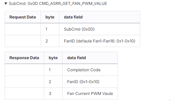

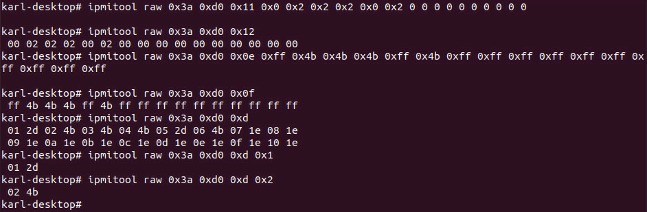

Hi Simon,
Thank you for researching this. The W680D4U (AST2600 BMC) doesn't respond to any of the commands in the manual you provided. I contacted AsRockRack Support. Here is the information they provided:
//get fan current PWM all
ipmitool raw 0x3a 0xd0 0x0d
//get fan current PWM single
ipmitool raw 0x3a 0xd0 0x0d  0x01
//set fan mode
ipmitool raw 0x3a 0xd0 0x11 0x0 0x2 0x2 0x2 0x0 0x2 0x0 0x0 0x0 0x0 0x0 0x0 0x0 0x0 0x0 0x0 0x0
//set fan duty
Note: Unused(non-manual) fans need to be set to 0xff
ipmitool raw 0x3a 0xd0 0x0e 0xff 0x4b 0x4b 0x4b 0xff 0x4b 0xff 0xff 0xff 0xff 0xff 0xff 0xff 0xff 0xff 0xff
For fan mode (speed), usually the 0x0 is for Auto, 0x32 is half way of your fan’s maximum speed, then 0x64 is fan’s full speed.
For fan duty, 0% = 0x00 and 100% = 0xff.
I hope this in information is helpful to you. Please let me know how I can be of further assistance.

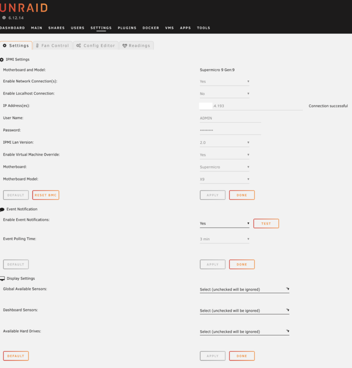

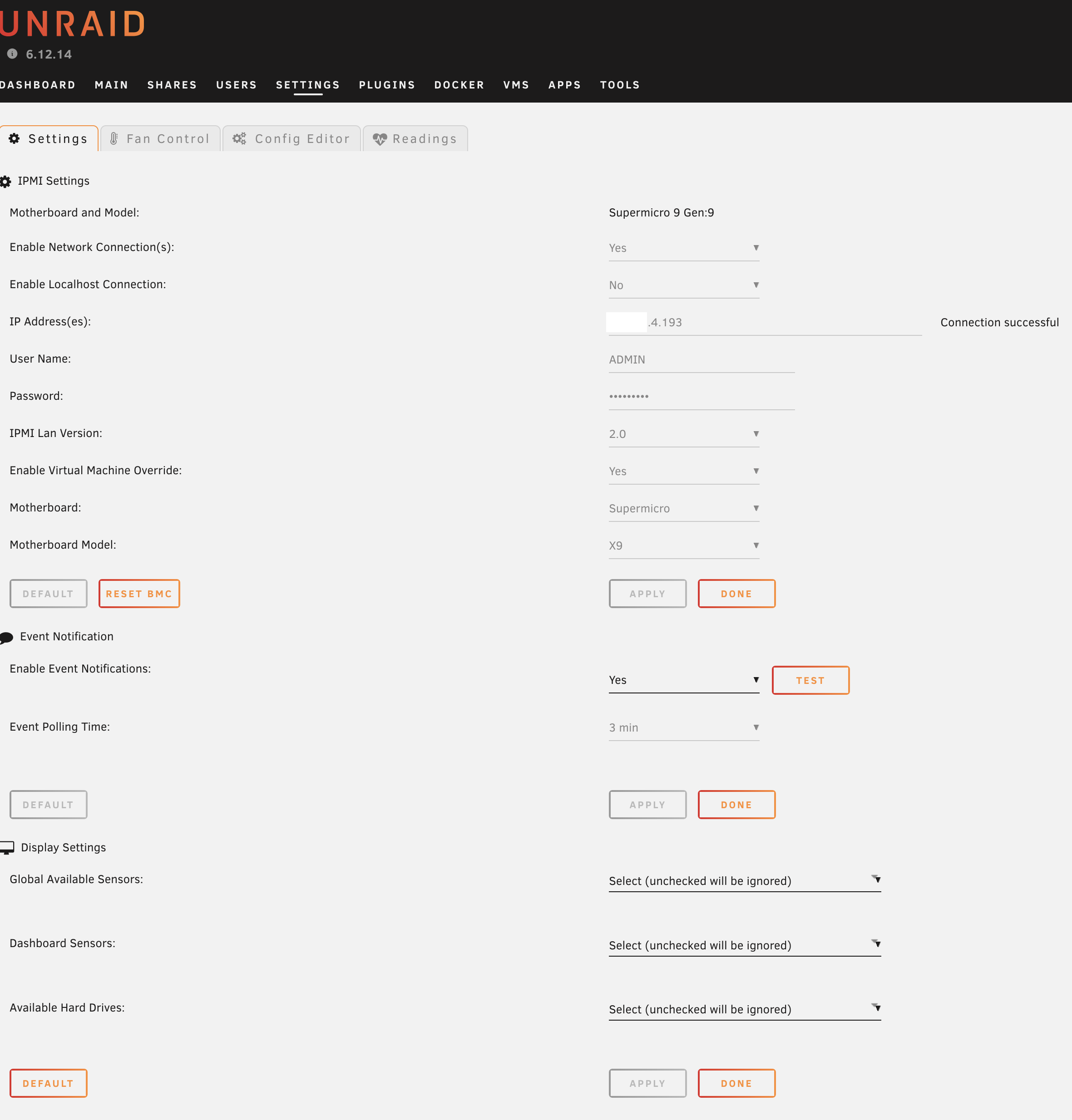

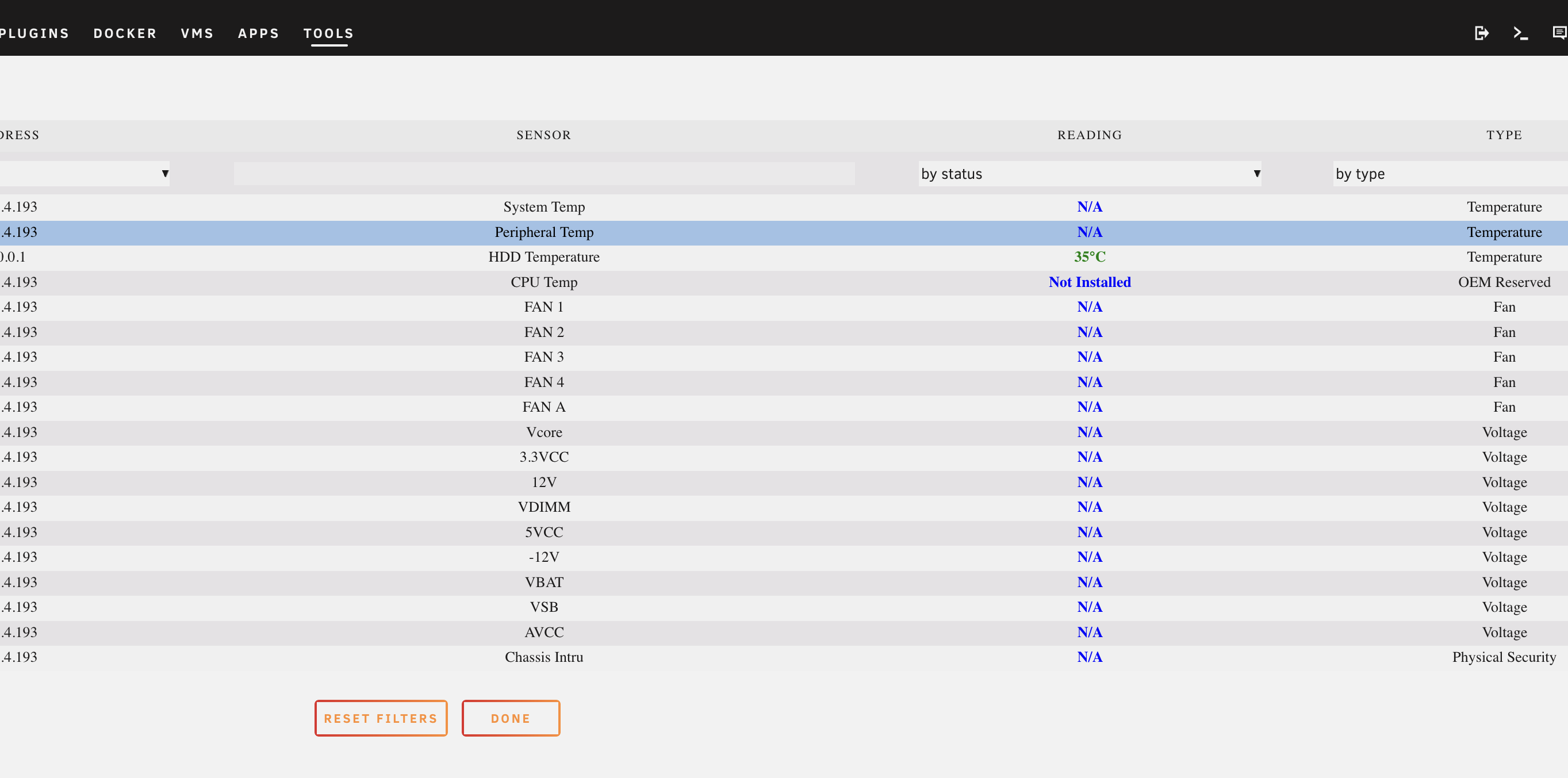

Hello,
I have a Supermicro X9SCA-F and only recently started playing with Unraid 6.12.14.
I installed IPMI Tools 2023.12.12.  IPMI is configured. I can reach the BMC from the subnet and the settings page says "Connection successful".
But in each reboot. sensor readings suddenly disappear (showing na or N/A). It's as if something is blocking the readout and i don't know what it is. When the computer is shut down, the BMC shows all sensor green. The BMC firmware is the latest i found (3.38).
I have installed other plugins like Dynamix System Temp and Dynamix Systems Stats (uninstalling does not really help). Stopping the Netdata docker container also does not change the behavior.
Is the observation known behavior? What can i do? (My ultimate goal is to have sensor readings and then do fan control where i do understand that with my Noctua fans, i will have to play a bit).

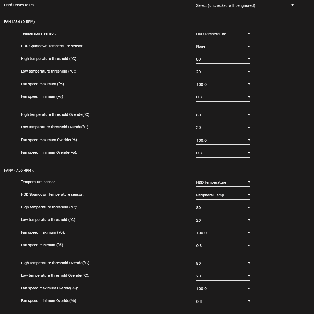

So I had the fans go full tilt again.  It's been 3 days since the last event.  Below are pictures of the log (have not stop/started the fan controls yet), and the fan speed readings.  If there is something else you want me to check, let me know.
On 12/8/2024 at 4:59 PM, spl147 said:
@SimonF can we get a update on this please?
start there till the end
Are you looking for something like this? This is just a display moch up no working code as yet.
yes and the override thresholds follow the spun down sensor
