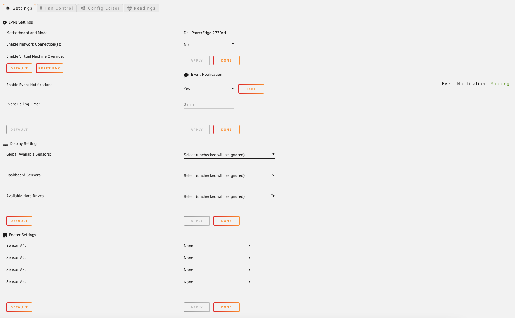

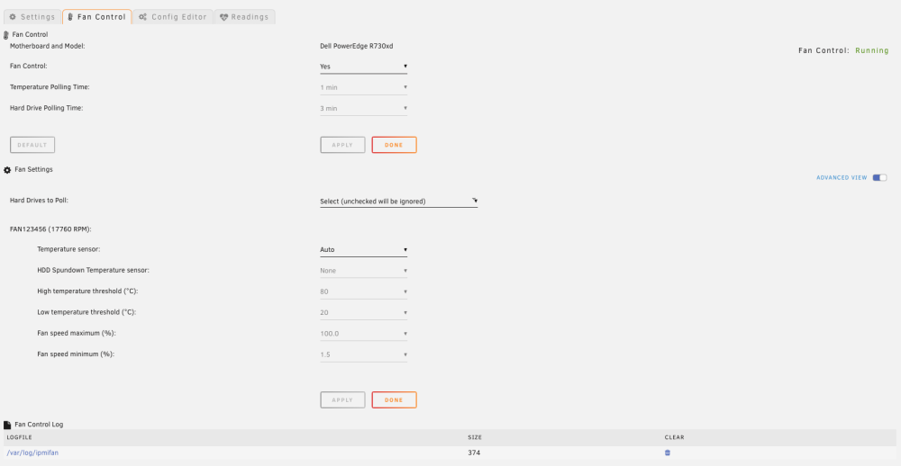

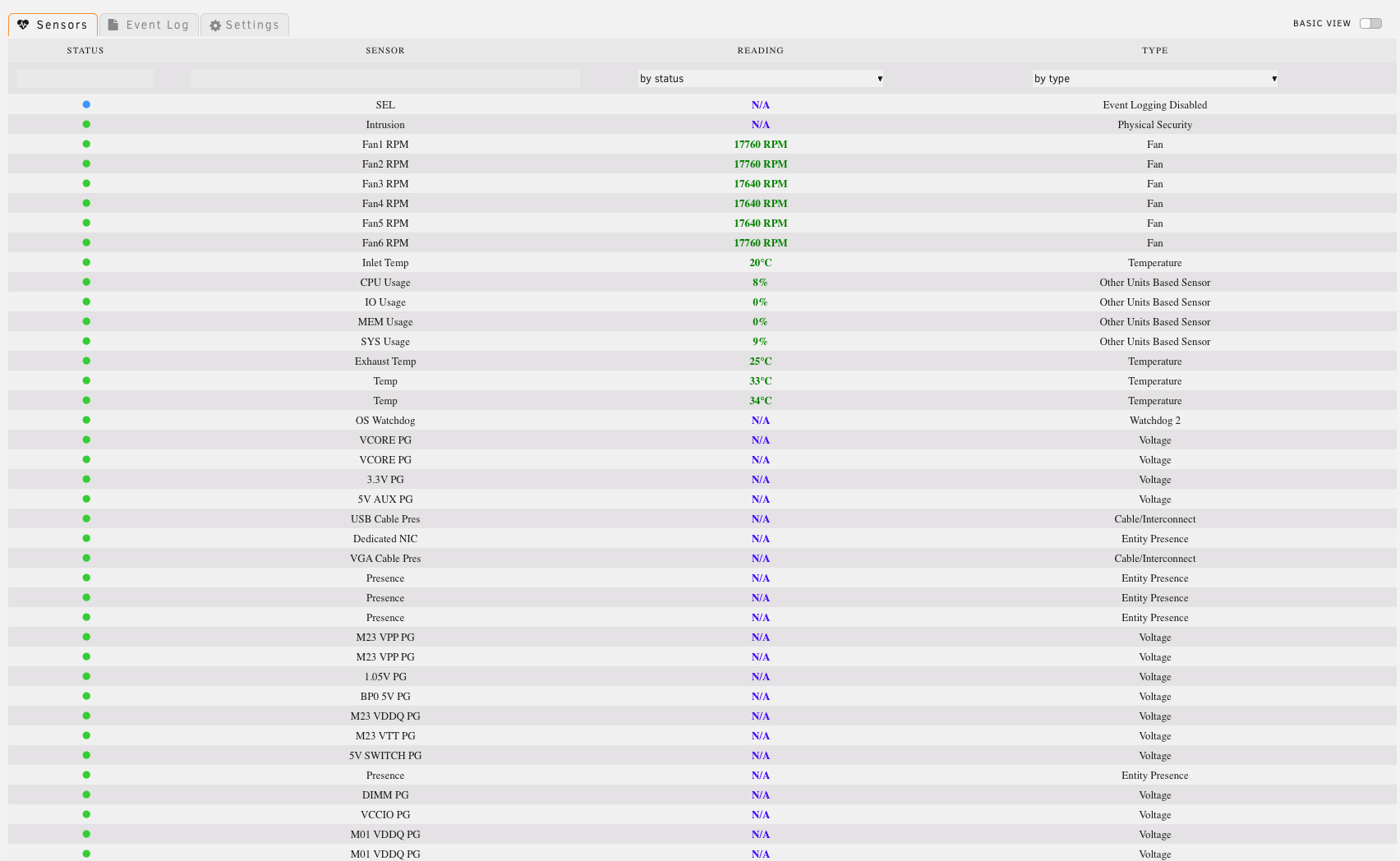

Thanks, I tried that but the fans are still spinning at 17760 RPM.  Is there something else I should be doing?  Thanks
you have not configured the fans at all!
here is mine:

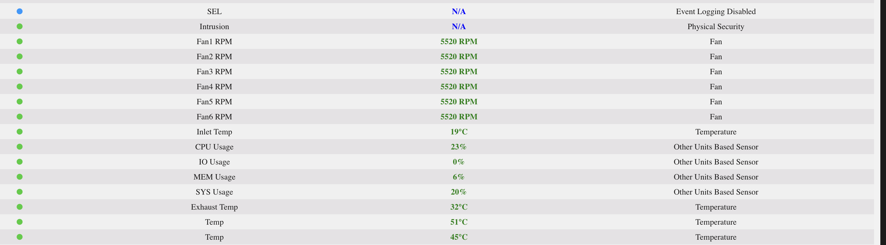

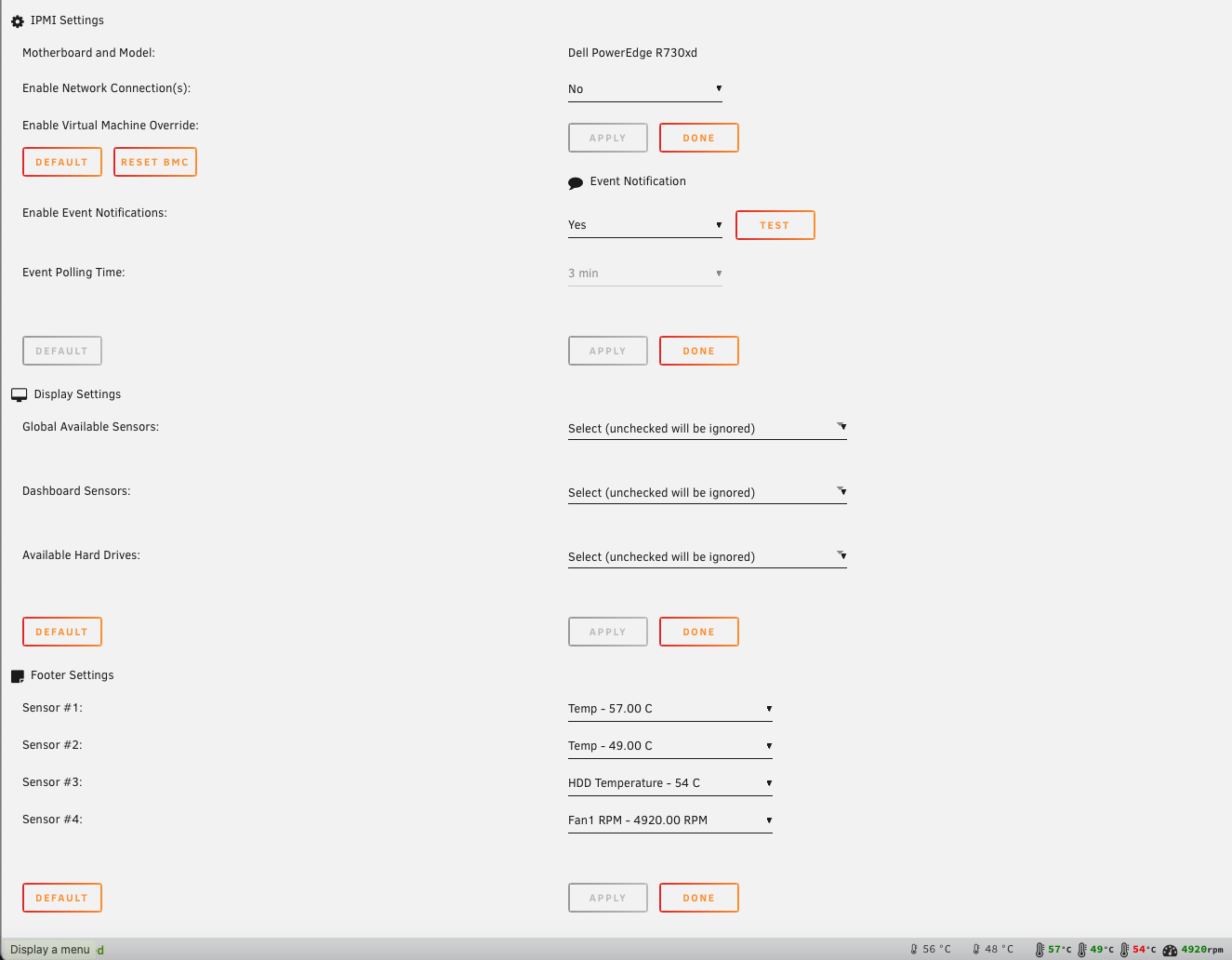

I just discovered this plug-in this morning after migrating to a Supermicro X10DRU-i+ a couple months ago.
I think I have everything configured properly, but only 2 of the fans are spinning down. I have 4 fans total, the stock ones from SuperMicro. My sensors report the last two fans are on FAN7 and FAN8, which is what I selected, but I cannot get them to spin down at all.
I set my fan minimum % to 1.3 and yet the lowest I ever see the fans go is 5250.  Since I am not sure what the ratio between temp and fan speed is, I am curious if this is the lowest they will go?  Thanks.

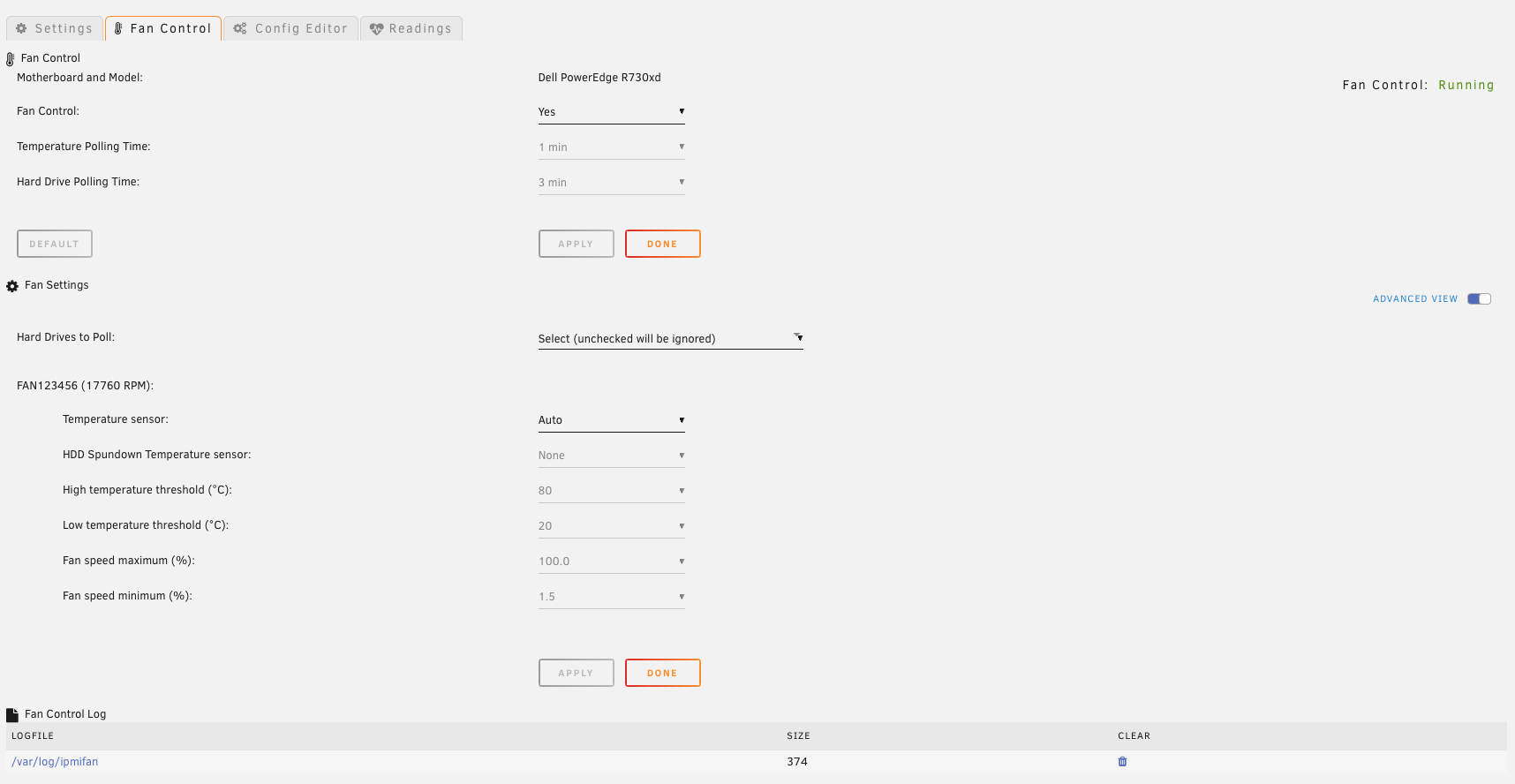

what are your fan settings set to?
post the impifan log (link is at the bottom of the fan control page)
Thats just for display in the footer
Supermicro boards i believe only use the 1st 4 headers
20c is way to low for the low threshold. your hdds will never get that cold, so fans will always be spinning closer to max i would use 30-35c

http://upload.forums.unraid.net/live/monthly_2024_02/image.thumb.png.0d4ead56d580d0fddb673f778ff2b99a.png

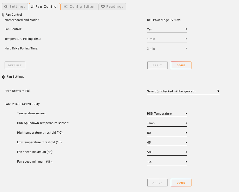

54c is really high! Post a pic of the fan setting page
Here you go:
59 minutes ago, The Transplant said:
Here you go:
80c for high? are you crazy? look up the specs for your drives. most are 55-60c MAX!
i use 30c for low and 55c for high
then once your drives come back down to normal temps, play with max fan speed to keep drives around 40-42c

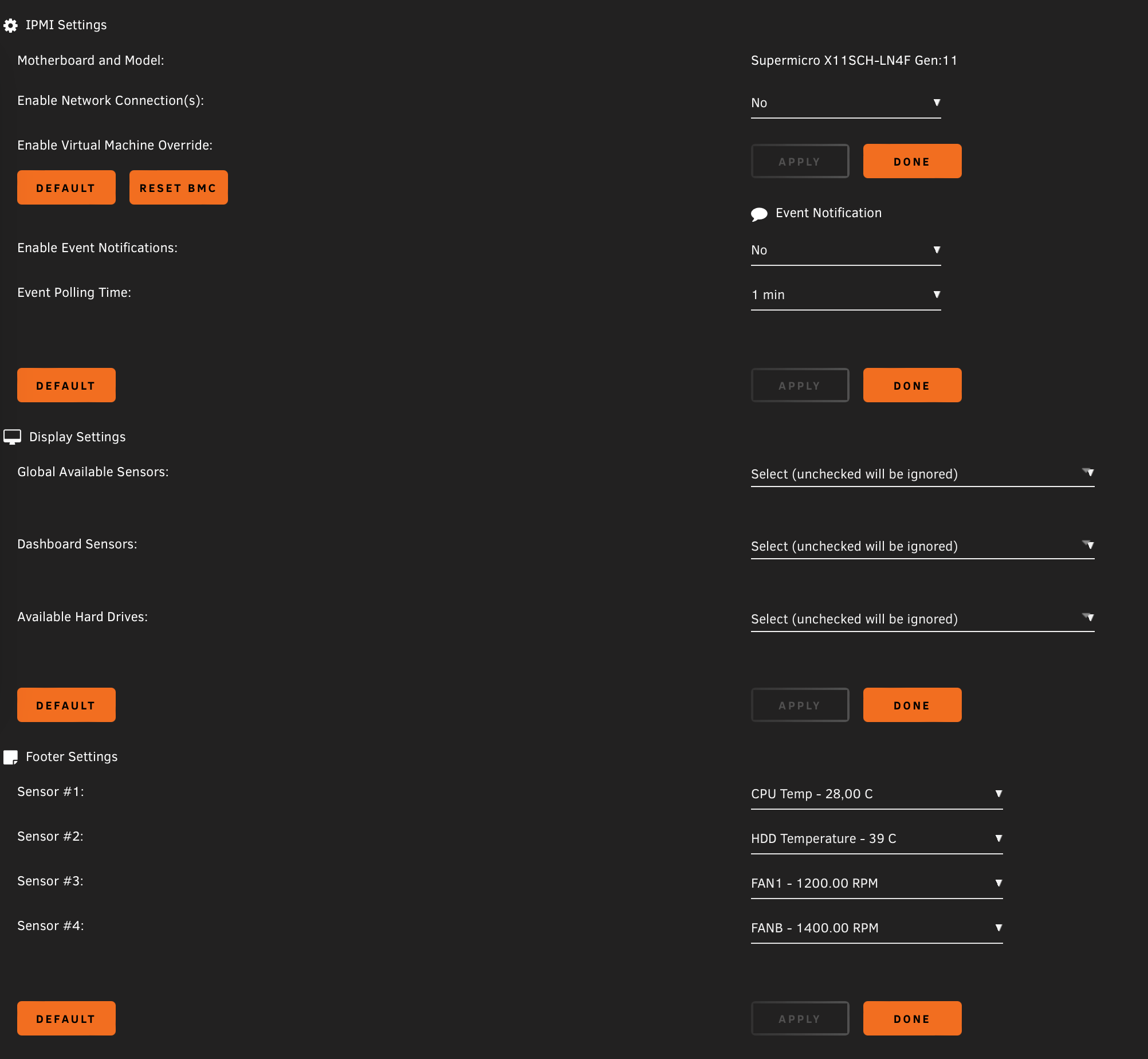

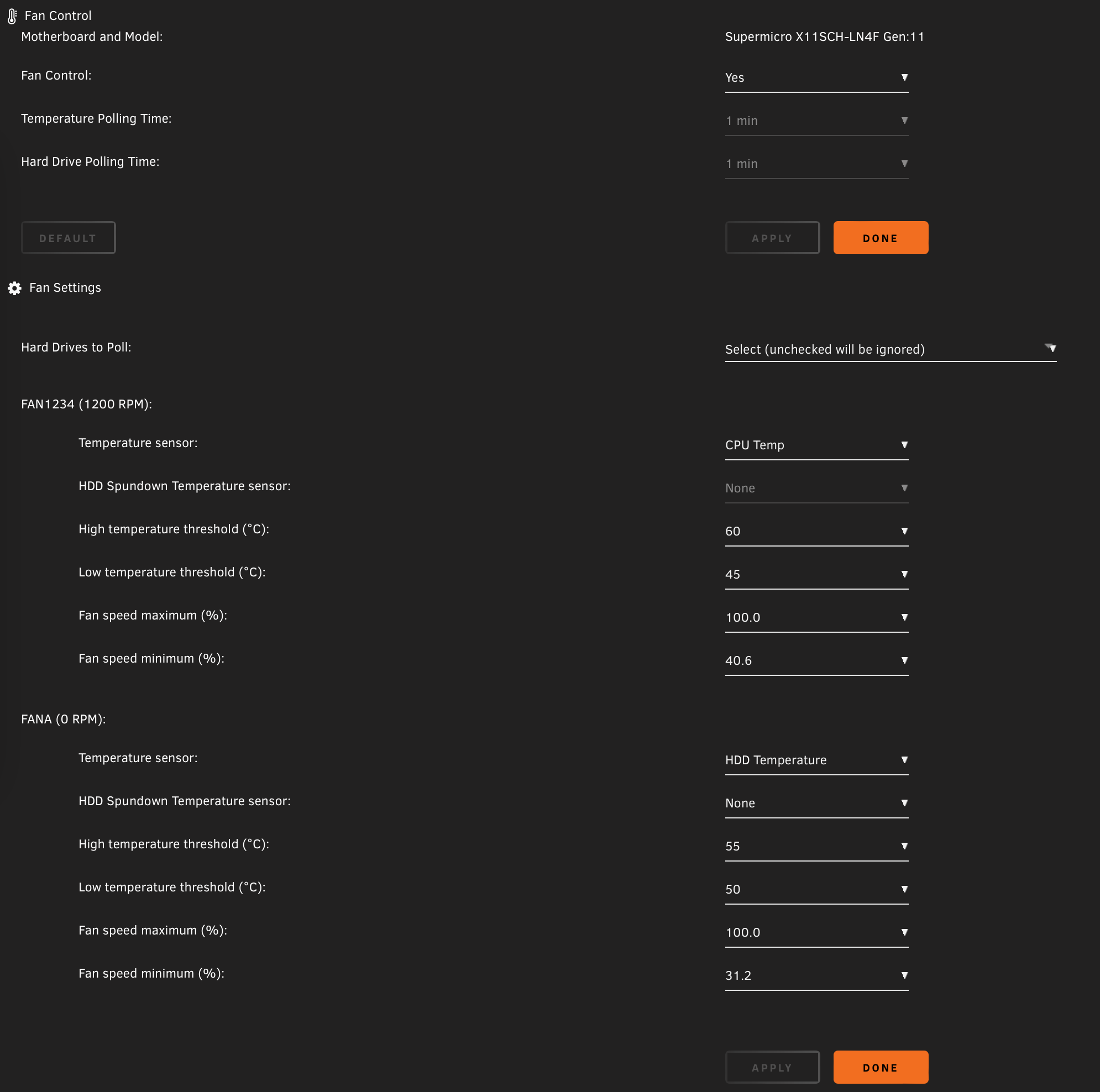

I am also having problems with all my fans running at full speed after upgrading the BIOS and BMC firmware of my Supermicro board today. I already tried stoping and starting fan control, adjusted the minimum fan speed and also did a system reboot. Fan thresholds have been adjusted to match the low rpm of my Noctua fans.
This is the fan log:
2024-02-03 18:37:39 Starting Fan Control
2024-02-03 18:37:39 Board: Supermicro Board Model: X11SCH-LN4F
2024-02-03 18:37:39 SM Board selection: 11
2024-02-03 18:37:39 Setting fans to full speed
2024-02-03 18:37:49 Fan:Temp, FAN1234(33%):CPU Temp(30C), FANA(28%):HDD Temp(Spundown)
2024-02-03 18:41:50 fan control config file updated, reloading settings
2024-02-03 18:41:50 Fan:Temp, FAN1234(41%):CPU Temp(29C), FANA(31%):HDD Temp(31C)
2024-02-03 18:41:51 Stopping Fan Control
2024-02-03 18:41:51 Setting fans to auto
2024-02-03 18:41:56 Starting Fan Control
2024-02-03 18:41:56 Board: Supermicro Board Model: X11SCH-LN4F
2024-02-03 18:41:56 SM Board selection: 11
2024-02-03 18:41:56 Setting fans to full speed
2024-02-03 18:42:06 Fan:Temp, FAN1234(41%):CPU Temp(28C), FANA(31%):HDD Temp(31C)
And these are my settings:
345731802_Bildschirmfoto2024-02-03um18_49_55.thumb.png.e5989b6ca4cfadf2eadc12a9b4687086.png
355274572_Bildschirmfoto2024-02-03um18_46_59.thumb.png.1a112952a198e54ab551c0de80da47d0.png
Edited by kennymc.c
Edit: Solved by resetting the BMC and then restarting fan control
2024-02-03 18:37:39 Starting Fan Control2024-02-03 18:37:39 Board: Supermicro Board Model: X11SCH-LN4F2024-02-03 18:37:39 SM Board selection: 112024-02-03 18:37:39 Setting fans to full speed2024-02-03 18:37:49 Fan:Temp, FAN1234(33%):CPU Temp(30C), FANA(28%):HDD Temp(Spundown)2024-02-03 18:41:50 fan control config file updated, reloading settings2024-02-03 18:41:50 Fan:Temp, FAN1234(41%):CPU Temp(29C), FANA(31%):HDD Temp(31C)2024-02-03 18:41:51 Stopping Fan Control2024-02-03 18:41:51 Setting fans to auto2024-02-03 18:41:56 Starting Fan Control2024-02-03 18:41:56 Board: Supermicro Board Model: X11SCH-LN4F2024-02-03 18:41:56 SM Board selection: 112024-02-03 18:41:56 Setting fans to full speed2024-02-03 18:42:06 Fan:Temp, FAN1234(41%):CPU Temp(28C), FANA(31%):HDD Temp(31C)
http://upload.forums.unraid.net/live/monthly_2024_02/345731802_Bildschirmfoto2024-02-03um18_49_55.thumb.png.e5989b6ca4cfadf2eadc12a9b4687086.png
http://upload.forums.unraid.net/live/monthly_2024_02/355274572_Bildschirmfoto2024-02-03um18_46_59.thumb.png.1a112952a198e54ab551c0de80da47d0.png
Cpu fan should not be controlled by this plugin, and your hdd fan shows 0, i think your config is wrong, check your physical fan header labels
I already solved the problem. See my comment at the top of the post.

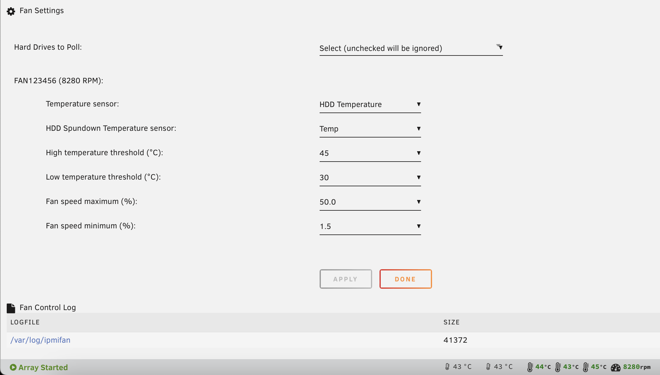

I got the hard drive temp into the green.  I am going to try tweaking it a little to see if I can get fan noise down a bit.  It is sitting in the back of my office.
I don't know actually what the operating temps of my drives are - have to open up the box and check the model numbers - will do that but for now just going with an average range.
One question - I have 6 mechanical drives and 2 SSD.  If I reduced the number of mechanical drives by using less bigger drives would that have much impact on heat?  Thanks.
