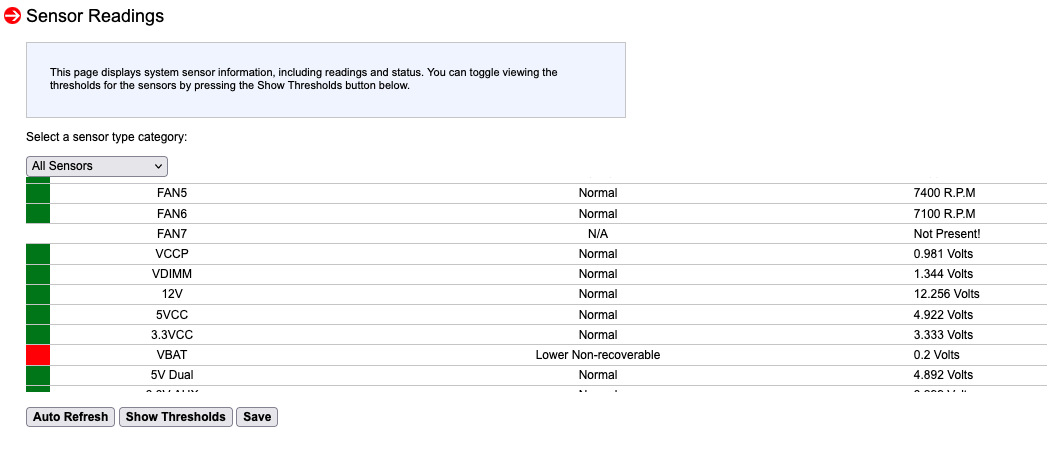

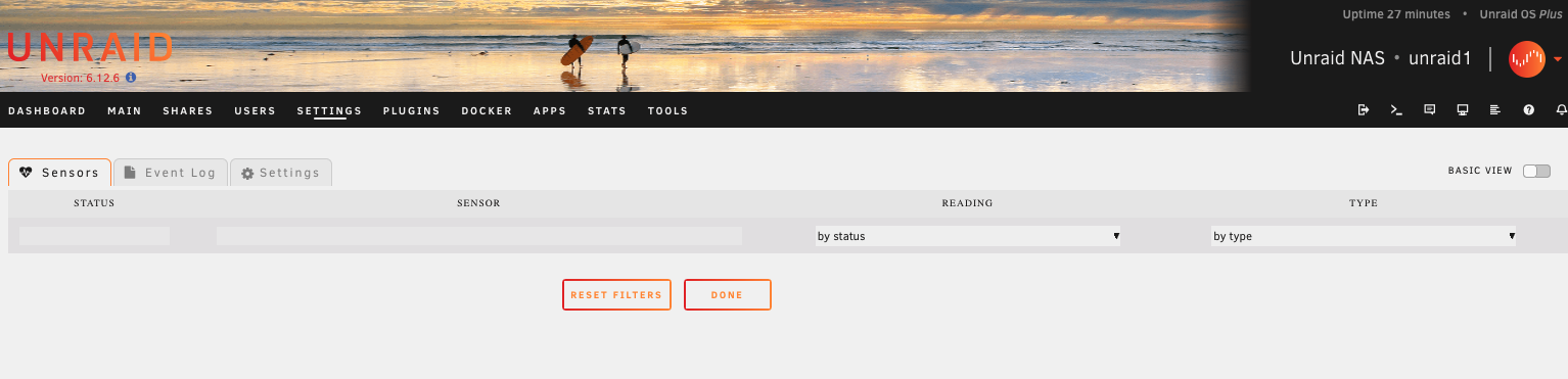

I've been using your great IPMI plugin for years on a Supermicro SuperStorage (5018A-AR12L with a Super A1SA7-2750F motherboard) server with a Aspeed AST 2400 BMC (gen X7). Yesterday after a full power down to move the server the plugin is no longer reporting any sensors and seems to not be able to access IPMI. I'm running Unraid 6.12.6 and did not update just before this happened. The fans do run based on the simple configuration in the IPMI settings ( The IPMI web interface still works, and shows sensors and values. I have reset the IPMI unit from the web interface, and also done a factory reset of it. I have cleared the CMOS while replacing the battery. It seems that the ipmi tools cannot access the IPMI system. Trying tools I get ipmi-detect: Cannot connect to server ipmi-sensors Caching SDR repository information: /root/.freeipmi/sdr-cache/sdr-cache-unraid1.localhost cipmi_sdr_cache_create: internal IPMI error and all the commands other than ipmi-detect seem to time out I've noticed two other odd issues, that seem to have started at the same time, but do not know if they are related. The only red reading is VBAT showing "Lower Non-recoverable", even after replacing the CMOS battery. And the iKVM input (keyboard and mouse) are not working, even using the virtual keyboard. Any other things I should check or do? Has anyone seen this behavior before? Thank you very much. My system does seem to be recognized by the plug in as it says Motherboard and Model: Supermicro A1SA7 Gen:1 Here's some screen shots of my IPMI details and what I'm seeing in the pluginicepic0 started following Project unDAT2012 , [PLUGIN] IPMI for 6.11+ , Fix common problems tells me there are problems with my setup and 2 others- NFS: Read-only file system ?
