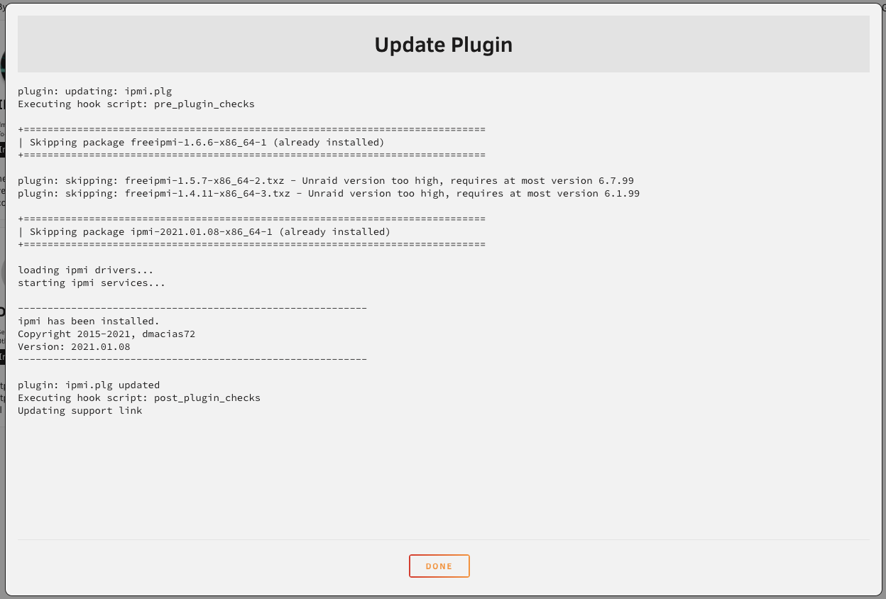

hmm - trying to do the "update" method outlined in the early posts, but it just keeps re-installing the old version by dmacias72. Do I have to be on 6.12 first?

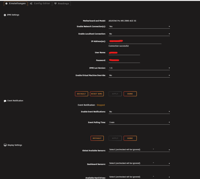

On 6/19/2023 at 12:11 AM, fleondelarosa said:
Ok, one more thing.
Using the IPMI web site of my motherboard, I put the fans at standard speed (quiet), but now they are speeding up and down, looks like if Unraid are forcing them to go at full speed (your software or my wrong ipmifan file) but IPMI web site said, no, you have to be standard speed at quiet level.
I hope this information can help, @SimonF
From the hot Munich city.....
as Froberg wrote, the Noctua fans' minimum speeds need to respected. Perhaps they got messed up in your configuration - as a result, they go to full speed.
The fan speeds going up/down sounds like a wrong setting in your mainboard's fan mode settings - to be able to control them using Unraid's IPMI plugin, they need to be set to "Full Speed".
Edited by Fisherman
typo

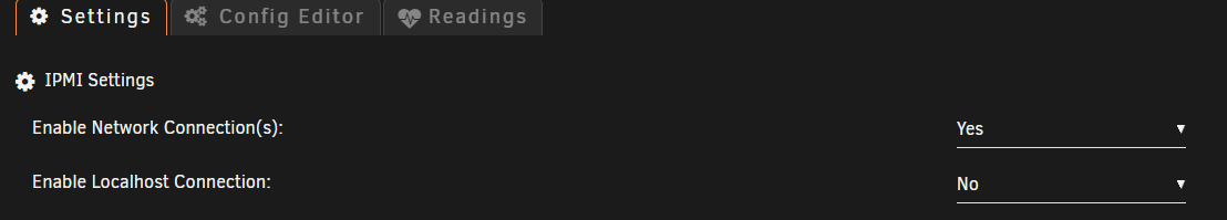

You should be able to find my vers before 6.12
I can find it, but when I hit "update" it installs the dmacias72 version again.
Edited by autumnwalker
You may have to uninstall then install config should be retained.
Thanks, I'll give this a shot.
Appears to have worked. Did the configuration for "enable localhost connection" get removed? I don't see it in settings anymore - but I see sensor values from IMPI so it must be working.

35 minutes ago, autumnwalker said:
Weird ... I don't see it here.
What do you get if you enable Network?
Ahh - that shows the localhost stuff - the old version I had network as "no".
@SimonF, sorry, i was offline some days.
What do you mean with the old ipmfan old version? that it is the one I had from the beginning and it was working before the update to 6.12.
Where can i find the new version.
I did some Gooogle without luck.
And yes, the speed fun issue had it in the past and i solved it, but came back after the update.
In any case, whay the GUI says Fan control stopped when I enable it?
