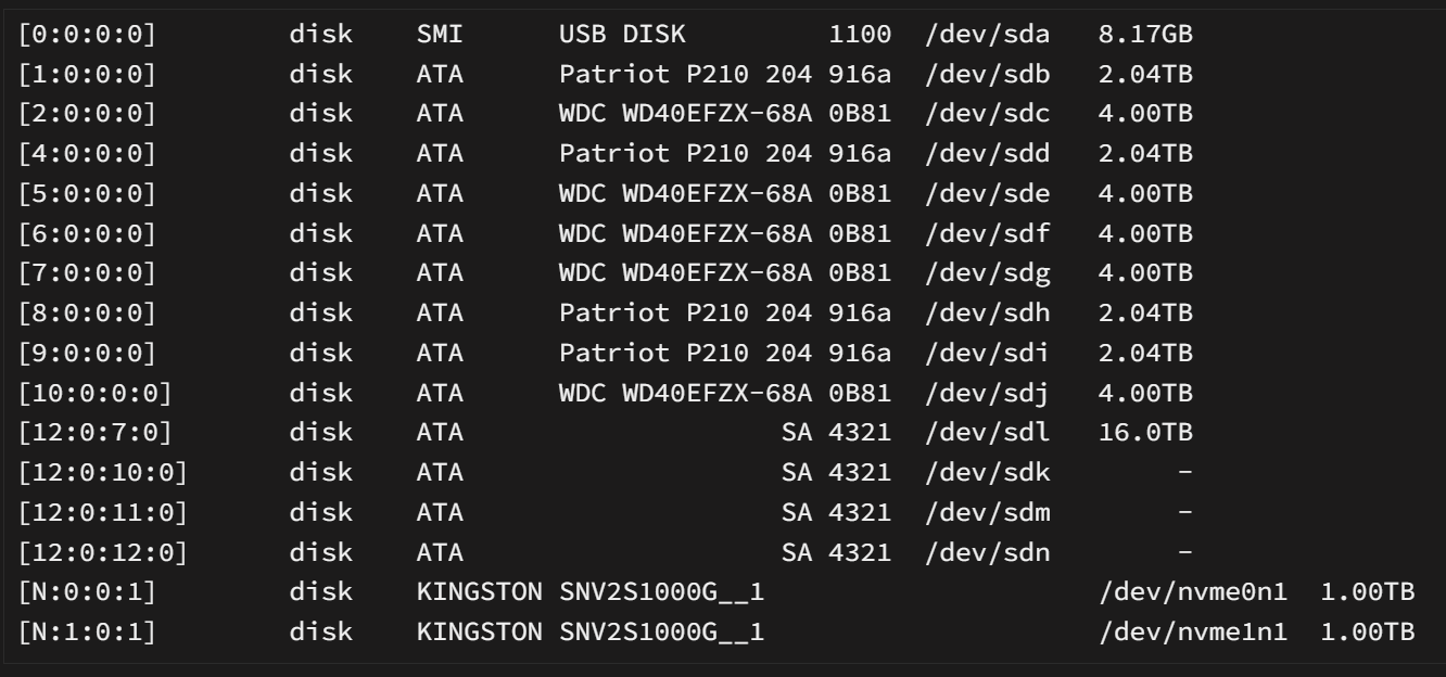

  9. Edit: Here is a screentshot of the system devices tab.
  10. Hello all, I have recently switched from 24x 1TB with SATA to SAS adapters in my NetApp DS4243 to 4x 16TB with SATA to SAS adapters. My issue is, that only one of the 4 Seagate Exos drives show up in the GUI. The other three are listed under system devices, but show "-" as size. When looking at the log, it displays "emhttpd: device /dev/sdk has size zero". What am I missing here? What is wrong? Sidenote: I previously had the diskshelf connected with two SAS-cables, but found out through another post, that multipathing is not supported in Unraid. Interestingly though, when I had the shelf filled up with 1TB disks, it did not through any errors regarding multipathing. There are other errors when Unraid is detecting the drives upon insertion as well. Log file is attached. If you need anything else. Please let me know. Thank you very much in advance. Regards, Niggo storinator-syslog-20231111-1701.zip
