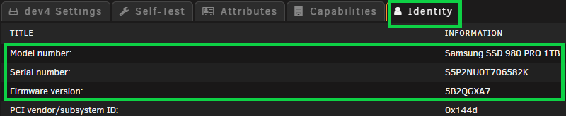

-Note your NVMe/SSD model and firmware version you have.

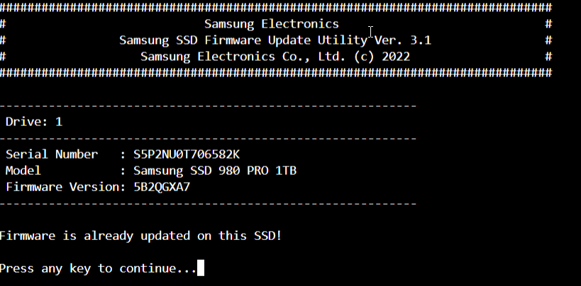

    mine goes straight to exiting when i hit continue, not quite sure what to do about that
  • most likely your firmware is already up to date as the screenshot provided.   'firmware is already updated on this SSD' 'press any key to continue'    should exit you out.

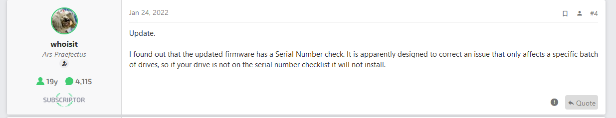

I have not verified the information, but according to a post I found about the 970 evo plus.  The poster of the question said:
I found out that the updated firmware has a Serial Number check. It is apparently designed to correct an issue that only affects a specific batch of drives, so if your drive is not on the serial number checklist it will not install.
I am also having the same message of no supported ssd's for my 970 evo plus.
