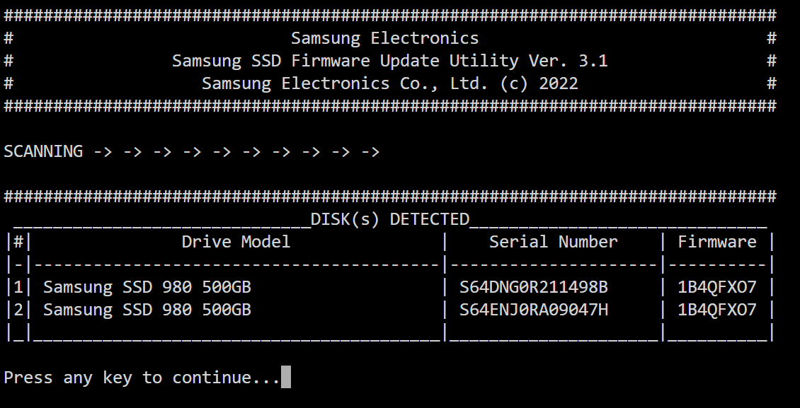

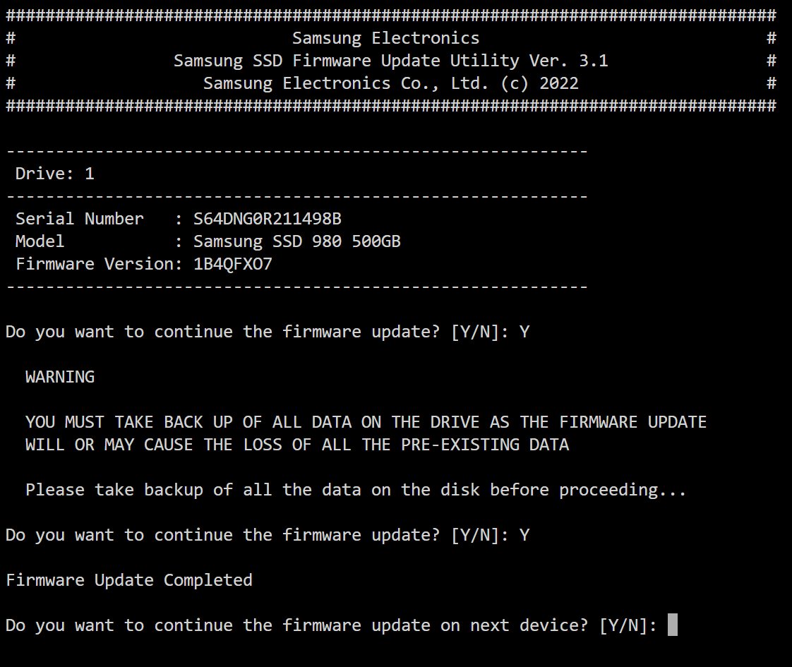

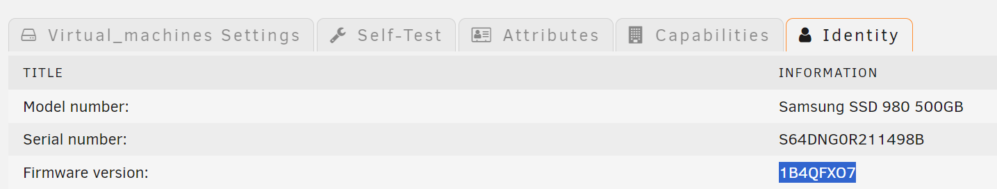

I tried the FW update my 2 980 drives. it correctly finds them, does the update - givess "Firmware update complete" message but FW still previous version (1B4QFXO7) and not new version (3B4QFXO7) for both drives.
Do I have to stop the array and/or reboot?
When I rerun the update the FW is still the "old" 1B4QFXO7 version.
Edited by theone

Not sure it is safer to boot from the Samsung provided ISO and update all devices from the same type at once...
yes, a reboot will refresh the version on the drives. You can also run the SMART info and you should see the latest firmware.

Ha, same happened to me, it appeared the firmware was not updates, but after a reboot it is.
Updated an 990 Pro from 3xxxx to 4xxxx, thanks OP!
#                            Samsung Electronics                             #
#                Samsung SSD Firmware Update Utility Ver. 3.1                #
#                   Samsung Electronics Co., Ltd. (c) 2022                   #
 Drive: 1
 Serial Number   : S73VNJ
 Model           : Samsung SSD 990 PRO 1TB
 Firmware Version: 3B2QJXD7
Do you want to continue the firmware update? [Y/N]: y
  WARNING
  YOU MUST TAKE BACK UP OF ALL DATA ON THE DRIVE AS THE FIRMWARE UPDATE
  WILL OR MAY CAUSE THE LOSS OF ALL THE PRE-EXISTING DATA
  Please take backup of all the data on the disk before proceeding...
After clicking 'Y', it takes a few seconds then a new screen showing to press any key to exit.
Edited by shpitz461

Thanks OP- have just successfully followed your guide to update my 990 Pro With Heatsink.
Can confirm that I needed to reboot before the Unraid UI was showing the updated firmware version.
