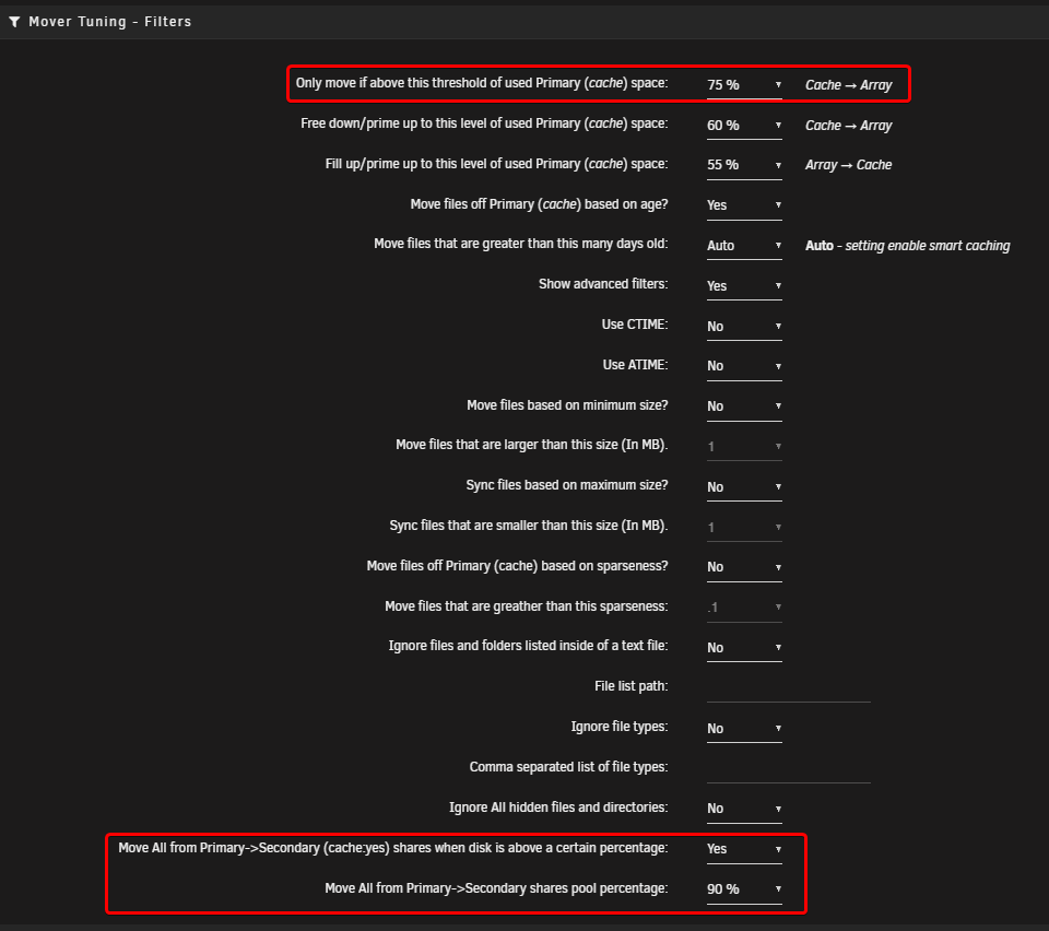

  6. Okay, I've set it to get triggered at 75% and clear till 25% but still nothing gets moved. I wonder if i should just disable the follow rules and just force move everything and then see what will happen

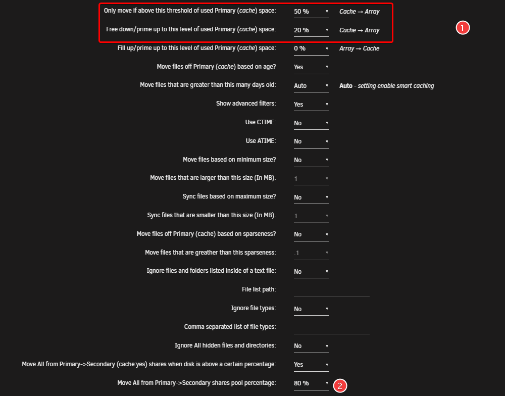

  7. 1. I changed it to 50/20% 2. Shouldn't this option say: screw it, I'm moving it anyway?

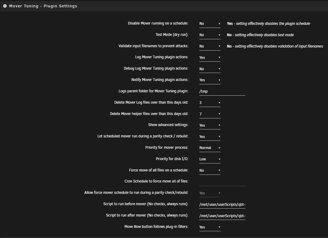

  11. I'm testing something new with this plugin and trying to run a script after the mover tuning started but somehow i get a error that it can't find the script. Fastdrive = another nvme drive i'm using ``` Sep 1 19:46:58 root: Starting Mover Sep 1 19:46:58 root: Forcing turbo write on Sep 1 19:46:58 kernel: mdcmd (92): set md_write_method 1 Sep 1 19:46:58 kernel: Sep 1 19:46:58 root: ionice -c 2 -n 7 nice -n 0 /usr/local/emhttp/plugins/ca.mover.tuning/age_mover start 10 0 0 '' '' '' "/mnt/fastdrive/userScripts/userScripts/mover-after.sh" yes 90 '' '' 30 Sep 1 19:46:58 root: Log Level: 1 Sep 1 19:46:58 root: mover: started Sep 1 19:46:58 root: mover: finished Sep 1 19:46:58 root: /usr/local/emhttp/plugins/ca.mover.tuning/age_mover: line 849: /mnt/fastdrive/userScripts/userScripts/mover-after.sh: cannot execute: required file not found Sep 1 19:46:58 root: Restoring original turbo write mode ``` Solved: CRLF vs LF Left it here for others if they run in to the same issue
