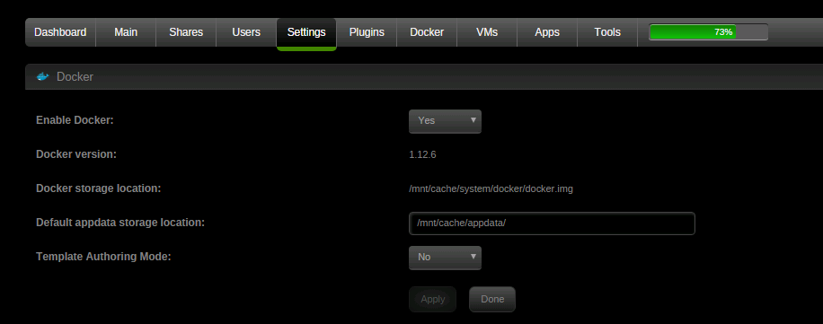

5 minutes ago, Netbug said:
I know, I'm an idiot, but I truly don't know. I usually just follow a tutorial for how to do something and tend to forget why or what I've done. I don't recall the unassigned devices plugin being tied to Sonarr though... I'm pretty sure I installed that to see if I could put stuff directly from the unRAID system onto like a USB stick.
ok see my screenshot, this will tell you where its stored:-
note the 'Docker storage location:' this is where your docker loopback image is stored, this contains all your docker images and containers, but NOT your configuration or downloaded stuff, that is defined per container.
Edited by binhex
Ok. Got it. (Sorry I cannot screenshot when I'm remote)
Docker Version: 1.12.6
Docker storage location: /mnt/disk1/docker.img
Docker appdata storage location: /mnt/user/appdata
Template Authoring Mode: No
Edited by Netbug
fine, so yeah its stored on a disk share on the array, so assuming you dont have a disk issue (and yes you could have) then it could be simple corruption of the docker loop image, as in  the file:-

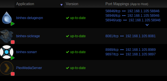

Hi All ,
I just installed the app. But I cannot access the webgui. ex: 192.168.1.105:8989 is not working.
Any ideas why
thank you

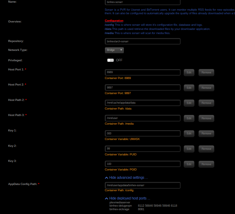

ok so same issue, you def deleted all files/folders for whatever you have mapped to /config on the host side for this docker right?
can you post a full screenshot of the container setup.
Just now, binhex said:
try again, thats sickrage
Hi i just post the good one sorry
try changing the host path for /config from /mnt/user/appdata/binhex-sonarr to /mnt/disk1/appdata/binhex-sonarr then restart the container
There are ongoing issues with using FUSE and Docker, im convinced there are issues around it, although LT have not found any evidence to date.
it's working :) thank you so much for helping me

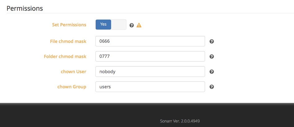

Just installed Sonarr and it's working great mostly.:)
Only problem is that it can't import the video files from Deluge. I just get this in the log-
17-8-20 17:46:05.4|Error|DownloadedEpisodesImportService|Import failed, path does not exist or is not accessible by Sonarr: /data/completed/Stranger.Things.S01E04.Chapter.Four.The.Body.1080p.NF.WEBRip.DD5.1.x264-NTb[rarbg]
I had possibly miss-configured permission on install and didn't catch it until this problem came up. Ran docker safe new permissions tool to correct permissions on the unRAID server and I think they're set right now. Same permissions I've been using in Radarr without any problems.  Current settings-
Still can't import the videos though. Maybe I have something else set wrong???
Edit: Maybe I found the problem? Is the /data path supposed to be mapped to the Deluge share? Something like this- /mnt/user/Deluge?
It was mapped to /mnt/cache/appdata.
Edited by wgstarks
/data has to be mapped exactly the same as it is on the download client. See the docker FAQ for ...aka linking containers.
Sent from my LG-D852 using Tapatalk
Thanks Squid. That's probably fixed it. Just need to wait for another download to complete to be sure.
