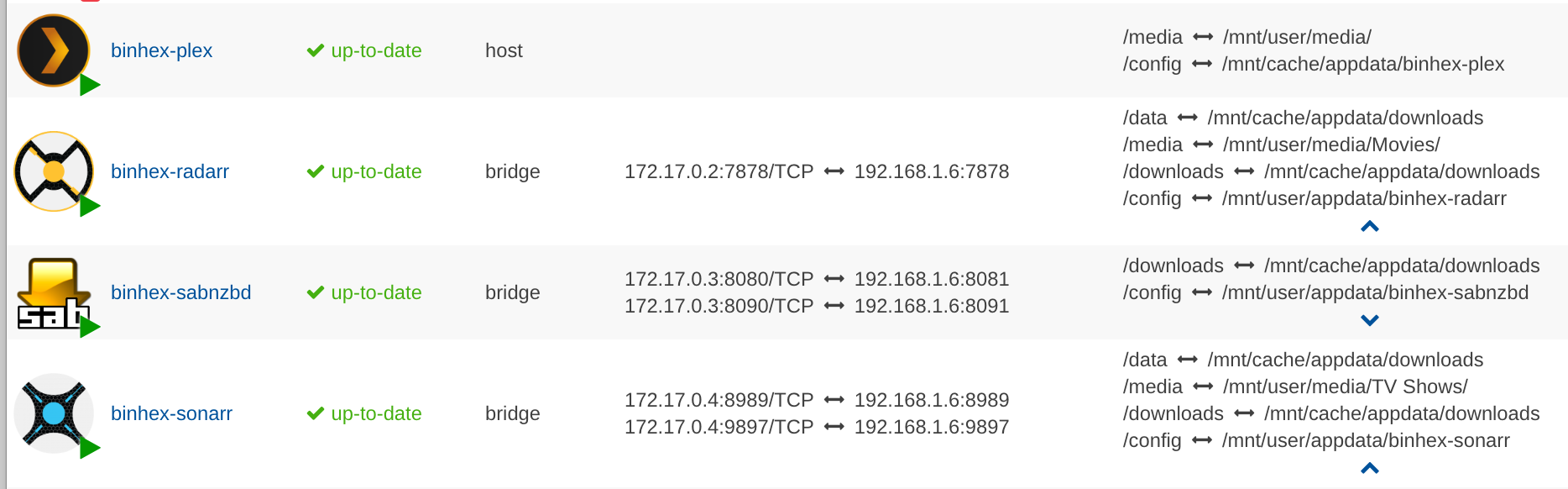

Hi @binhex  First off your docker images are fantastic.  Thank you -- made using UnRAID very easy and I use a number of them.

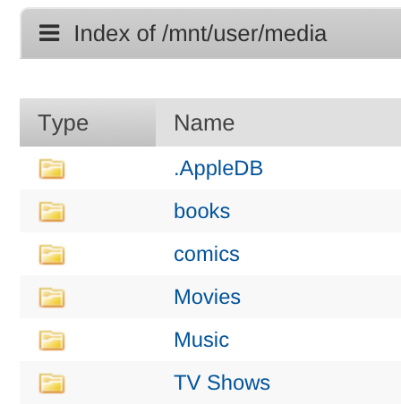

I recently added a cache drive and since then (in spite of a few days of reading threads, FAQs, and reinstalls, spaceinvader videos, etc.) I've been completely unable to get Sonarr / Radarr to move files after they've downloaded.  I know this is a newbie question but what's frustrating is that it was working, and is no longer.  Can you (or someone) please take a quick peek at these settings and let me know what the heck I'm doing wrong??
Radarr is reporting that it is "Missing root folder: /media/Movies"
Sonarr reports that it is "Multiple root folders are missing: /mnt/users/media/TV Shows | /media/TV Shows"
Capitalization looks correct.  Not sure why it's looking for "/mnt/userS" though?

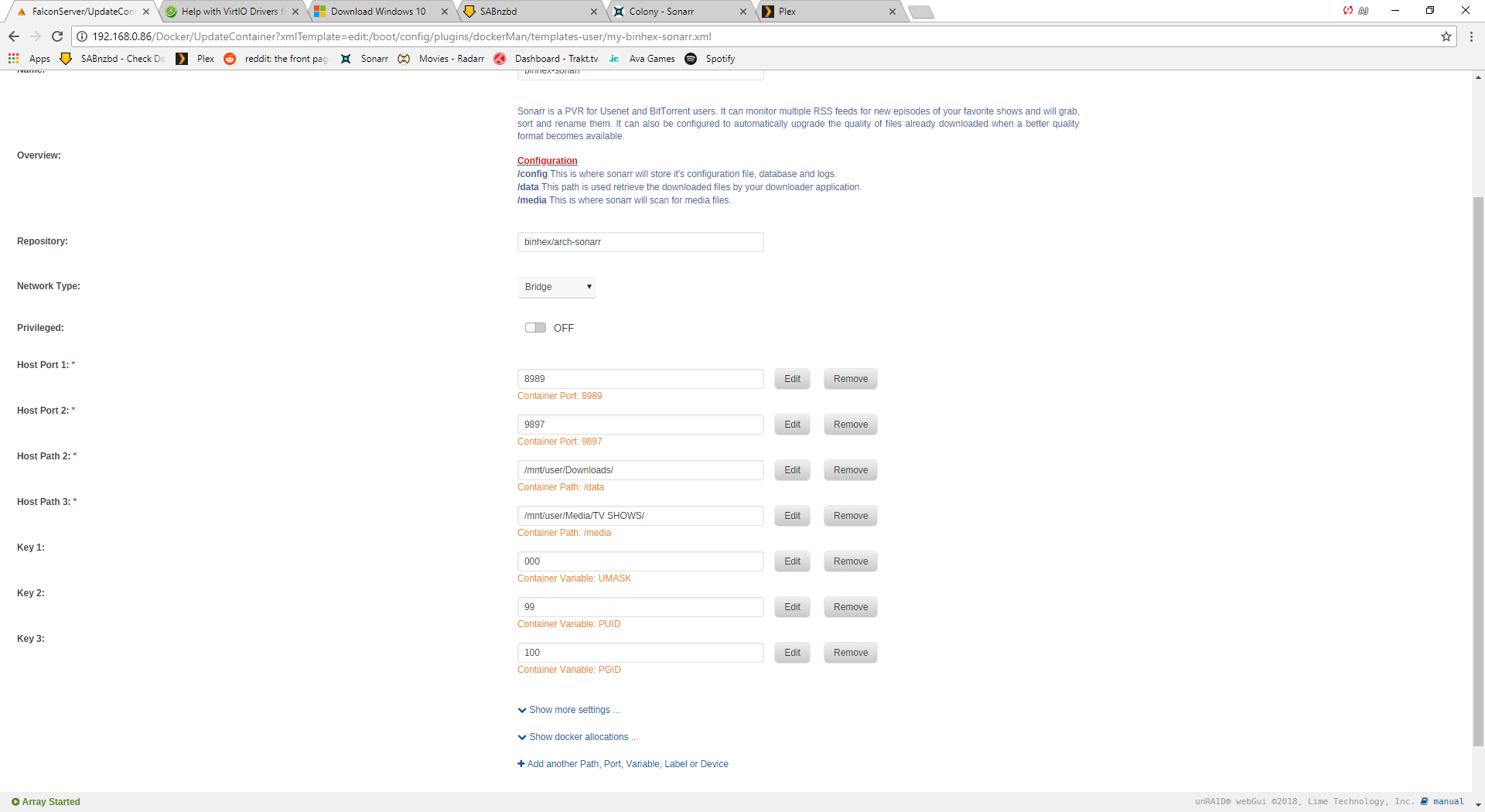

Here's my run command from Sonarr:
root@localhost/# /usr/local/emhttp/plugins/dynamix.docker.manager/scripts/docker run -d --name='binhex-sonarr' --net='bridge' -e TZ="America/Denver" -e HOST_OS="unRAID" -e 'UMASK'='000' -e 'PUID'='99' -e 'PGID'='100' -p '8989:8989/tcp' -p '9897:9897/tcp' -v '/mnt/cache/appdata/downloads':'/data':'rw' -v '/mnt/user/media/TV Shows/':'/media':'rw' -v '/mnt/cache/appdata/downloads':'/downloads':'rw' -v '/mnt/user/appdata/binhex-sonarr':'/config':'rw' 'binhex/arch-sonarr'

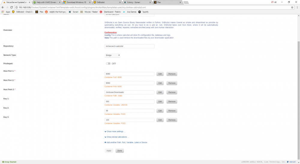

And run command from Sabnzbd:

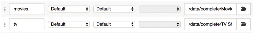

root@localhost:# /usr/local/emhttp/plugins/dynamix.docker.manager/scripts/docker run -d --name='binhex-sabnzbd' --net='bridge' -e TZ="America/Denver" -e HOST_OS="unRAID" -e 'UMASK'='000' -e 'PUID'='99' -e 'PGID'='100' -p '8081:8080/tcp' -p '8091:8090/tcp' -v '/mnt/cache/appdata/downloads':'/data':'rw' -v '/mnt/user/media':'/media':'rw' -v '/mnt/user/personal':'/personal':'rw' -v '/mnt/cache/appdata/downloads':'/downloads':'rw' -v '/mnt/user/appdata/binhex-sabnzbd':'/config':'rw' 'binhex/arch-sabnzbd'
Not sure what other information is needed to help me figure this out but any leads would certainly be appreciated!
Thank you.
Thank you.
Just to follow-up to my own question, the only thing that worked for me after days of trying was to delete the Binhex dockers (Sonarr, Radarr, Sabnzbd) and install the Linuxserver.io ones.  With the exact same settings, everything worked perfectly.   ¯\_(ツ)_/¯

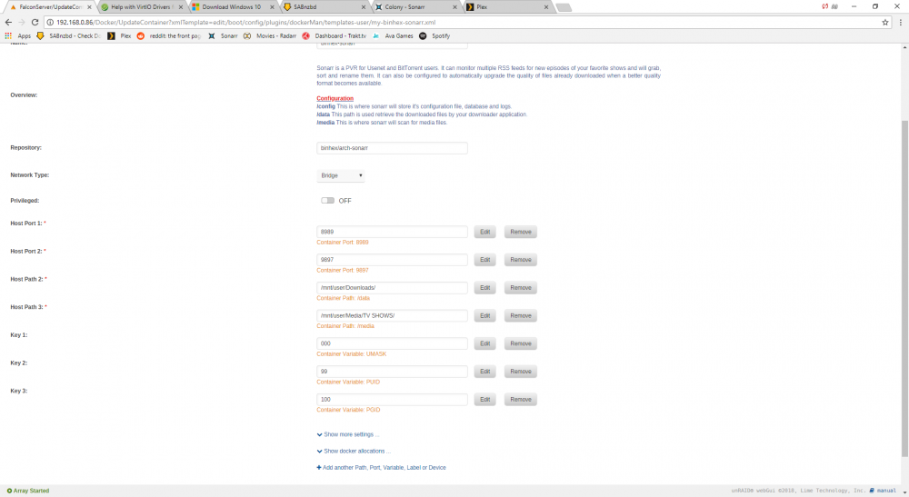

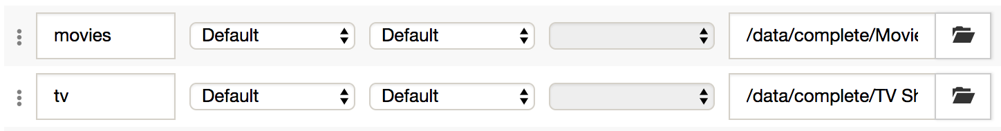

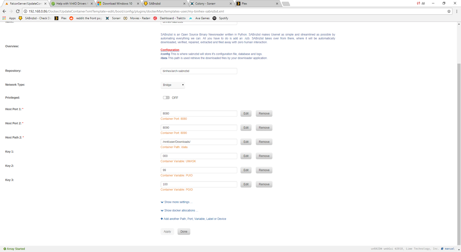

I am new to unRaid and i am having trouble getting the files and folders associations right.
I have attached a couple screen shots, any help is greatly appreciated!
But what is the actual problem?
i figured it out, the files were downloading but i couldn't find them. I am not entirely sure what solved the problem, i think it was the /data folders were not the same. But its working now.

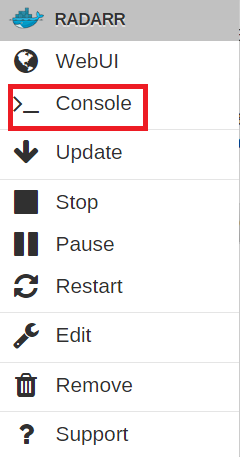

ok lets rule out mono, its a fairly simple process:-
1. go to unraid web ui/docker tab/left click sonarr and select console
2. copy and paste the below code
export aor_packages="mono" && /root/aor.sh
3. once its finished then close the console window and restart the container, do not edit it otherwise it will revert back to the previous mono version.
if this does fix it then i can make this permanent.

Hi Binhex, Thanks for helping on this.
So, first problem. Copy and pasting that command I get "sh: 1: /root/aor.sh: not found". Maybe a cause for this?!?
Are you sure you are in the console for the container? Look at my instructions again
Sent from my SM-G935F using Tapatalk
Yes, 100%. See small grab...
Sorry, ignore Radarr, Wrong screengrab. It was in Sonarr.
Here is a grab of the console.
