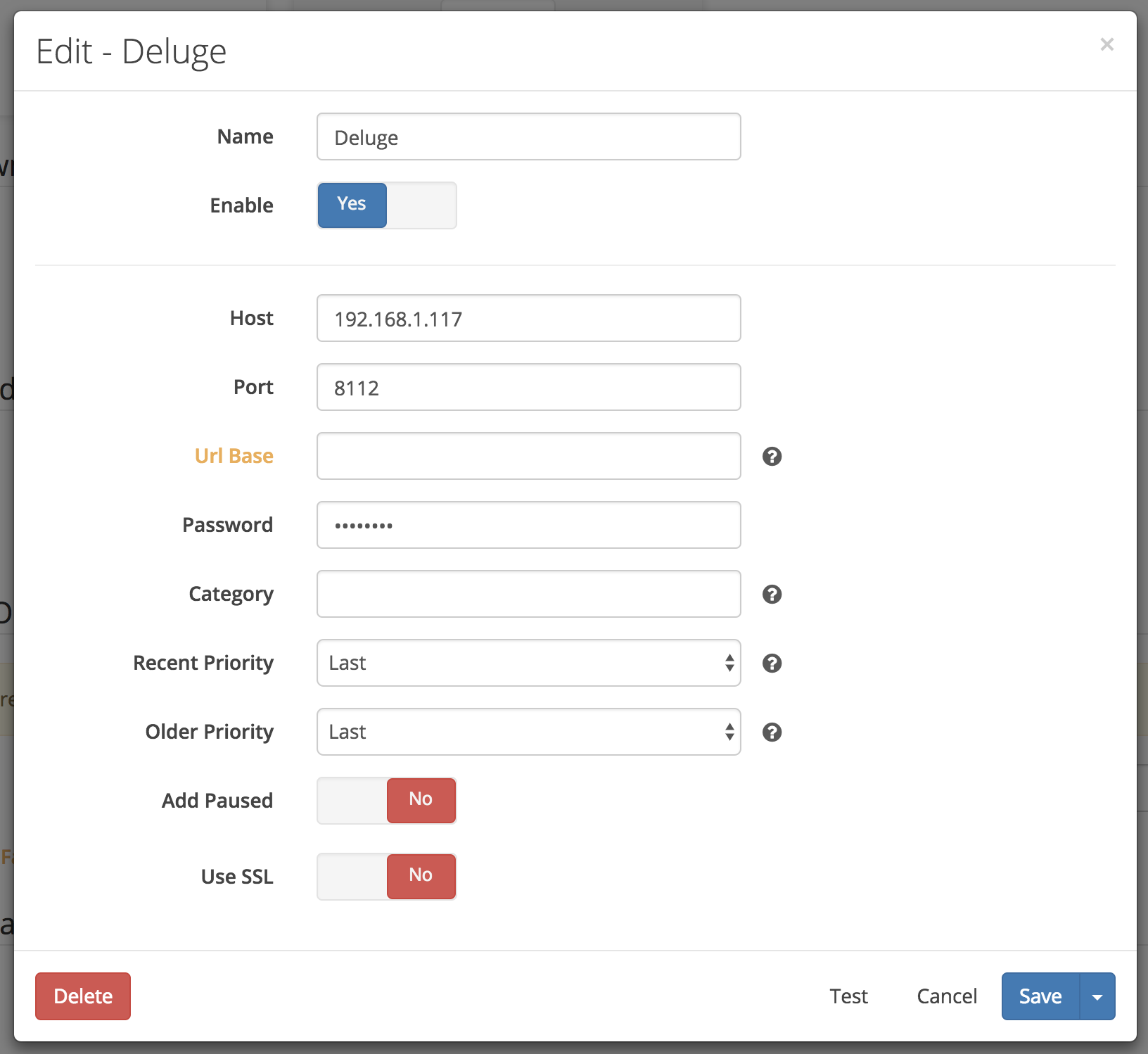

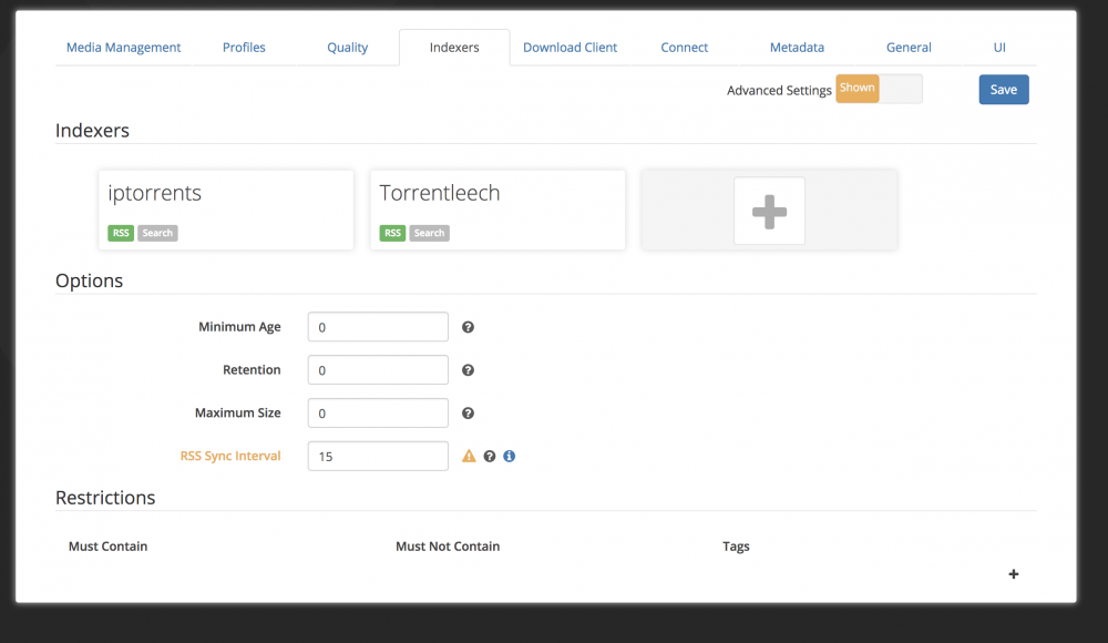

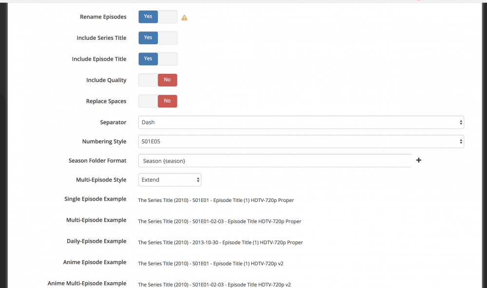

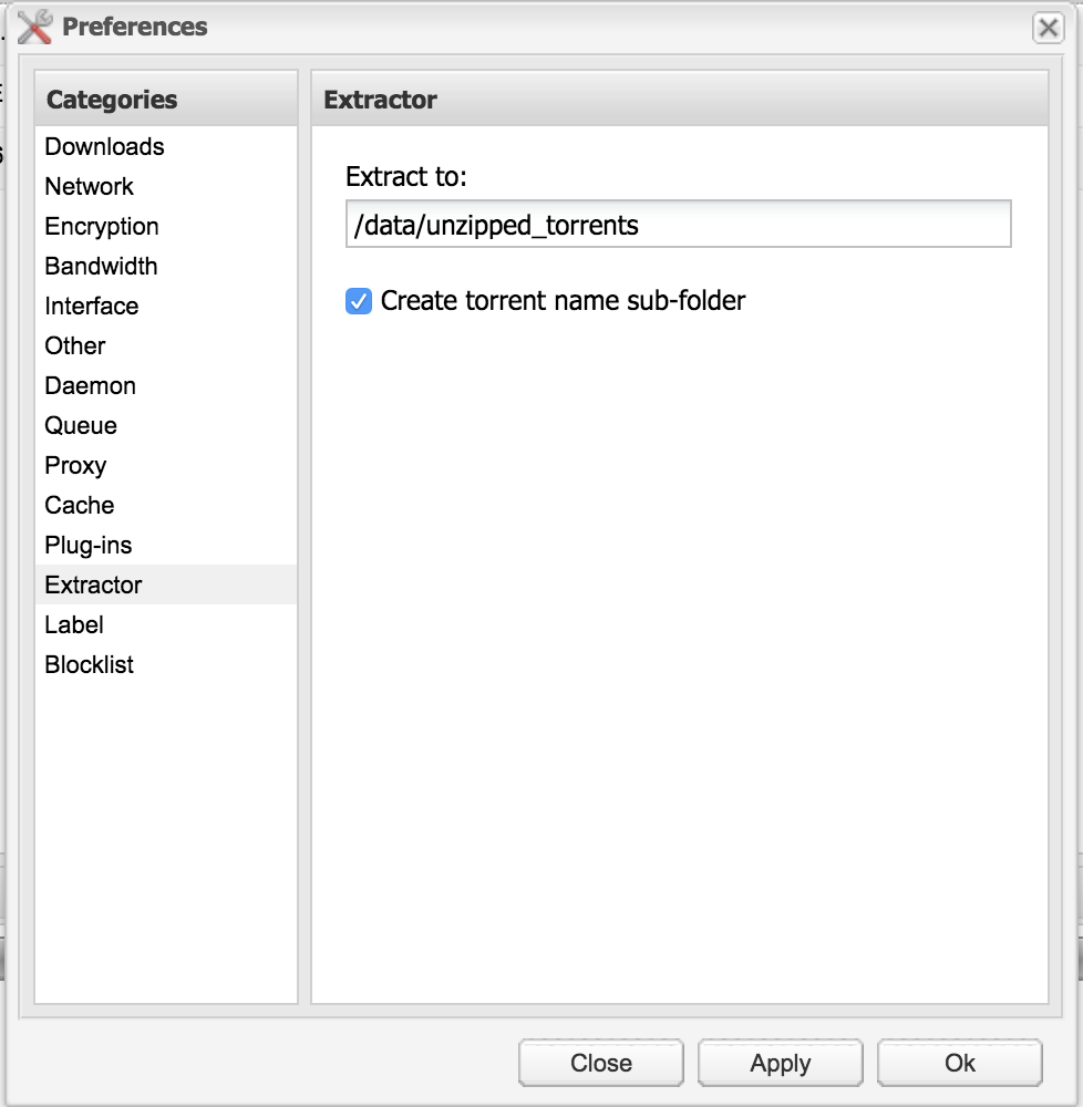

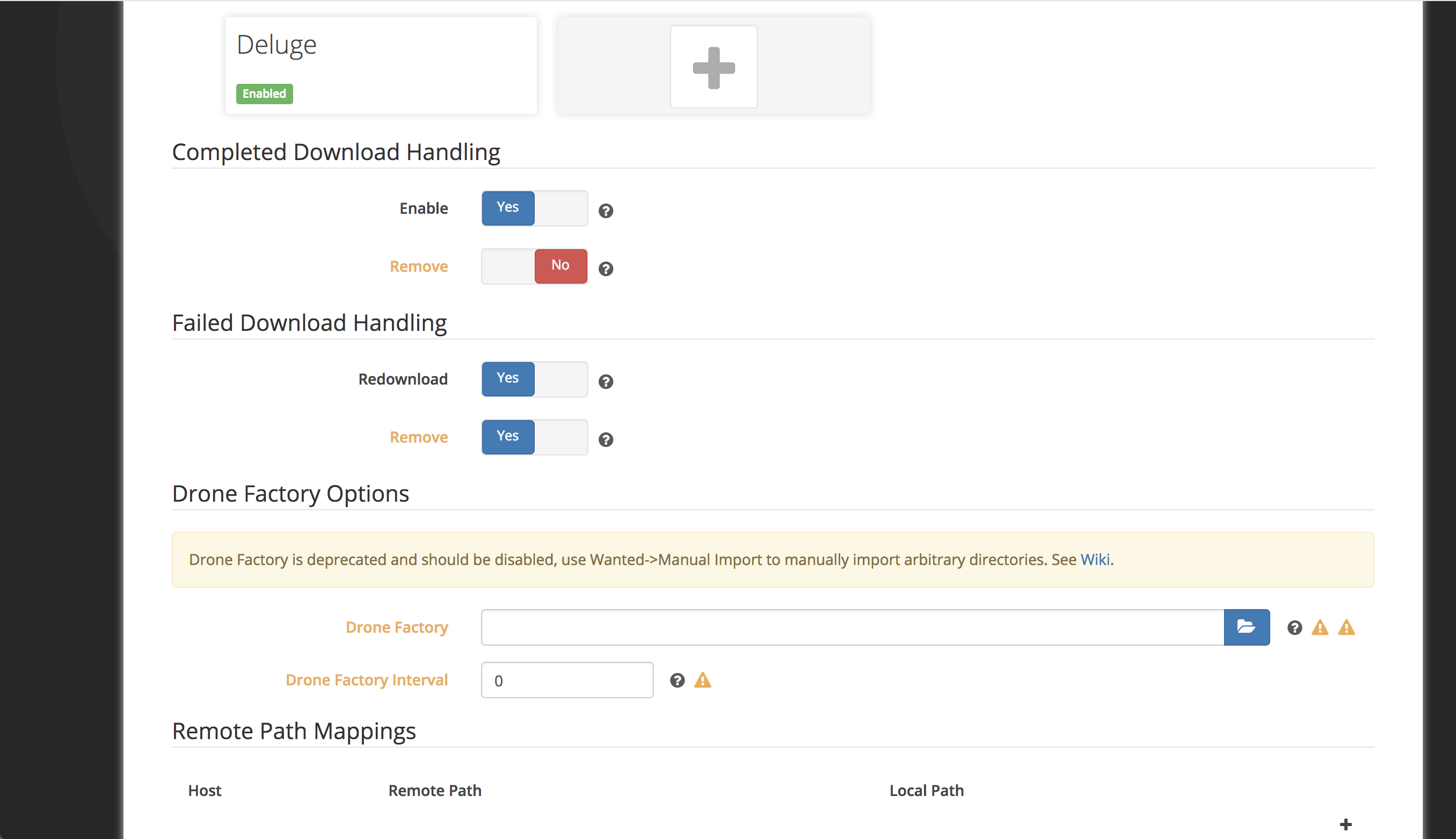

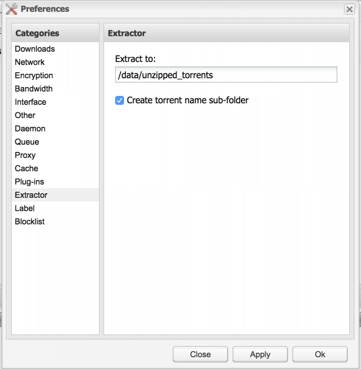

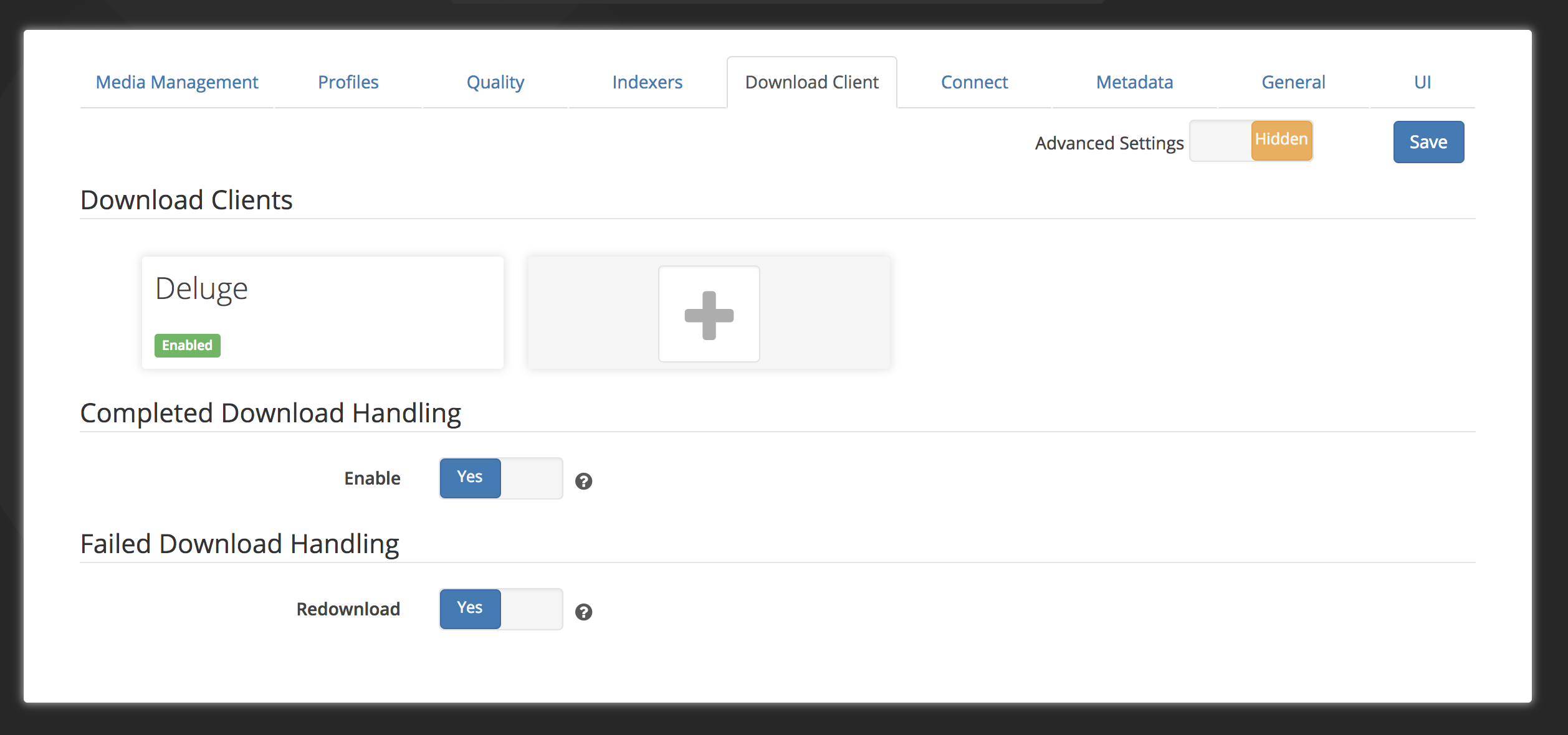

Hello guys
I have a problem that I can not solve. I use deluge for download and of course in sonarr. When a chapter is found it goes down without a problem via deluge but there is a problem afterwards. He can not move the chapter (and does not change the correct name) to my media folder /media/TVShows.
I tried all kinds of options - but unfortunately it did not help much. I attach a few pictures of the settings from Deluge and Sonarr hoping you will help me. Thanks

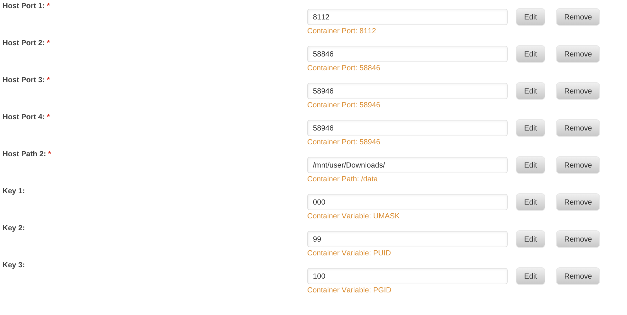

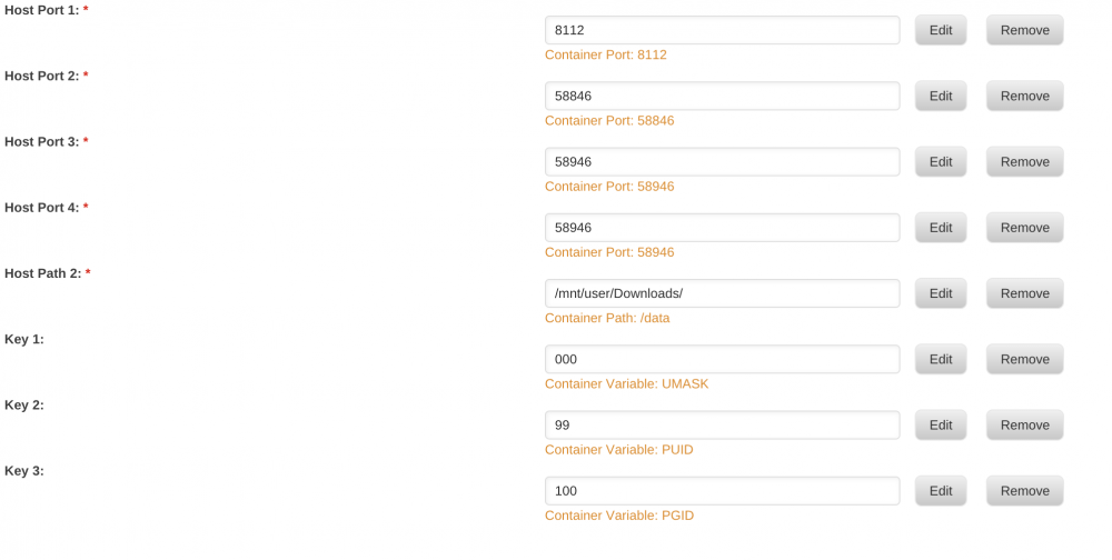

Thanks for the quick reply. Do I have a disk cache?  I do not have that, so I ask.

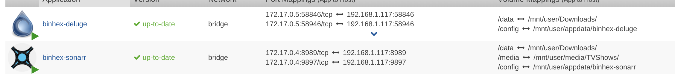

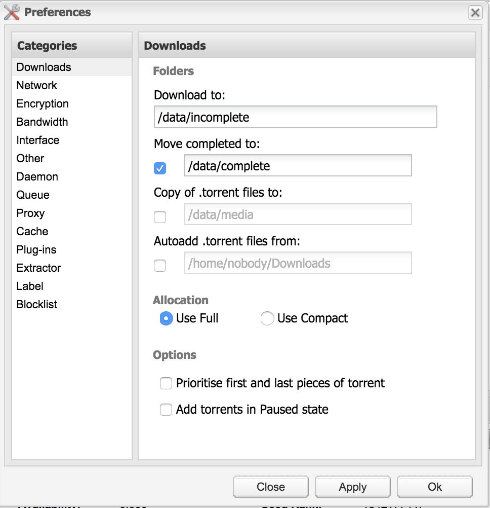

That's how it looks to me - it still does not work :(

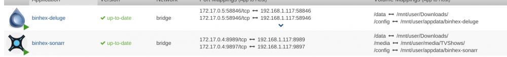

ok so that looks good, you have both the host path and container path the same for deluge and sonarr, now the configuration for the apps, i see deluge is saving to /data/complete where is sonarr looking for completed tv series?
Edited by binhex
1 minute ago, binhex said:
ok so that looks good, you hav both the host path and container path the same, now the configuration for the apps, i see deluge is saving to /data/complete where is sonarr looking for completed tv series?

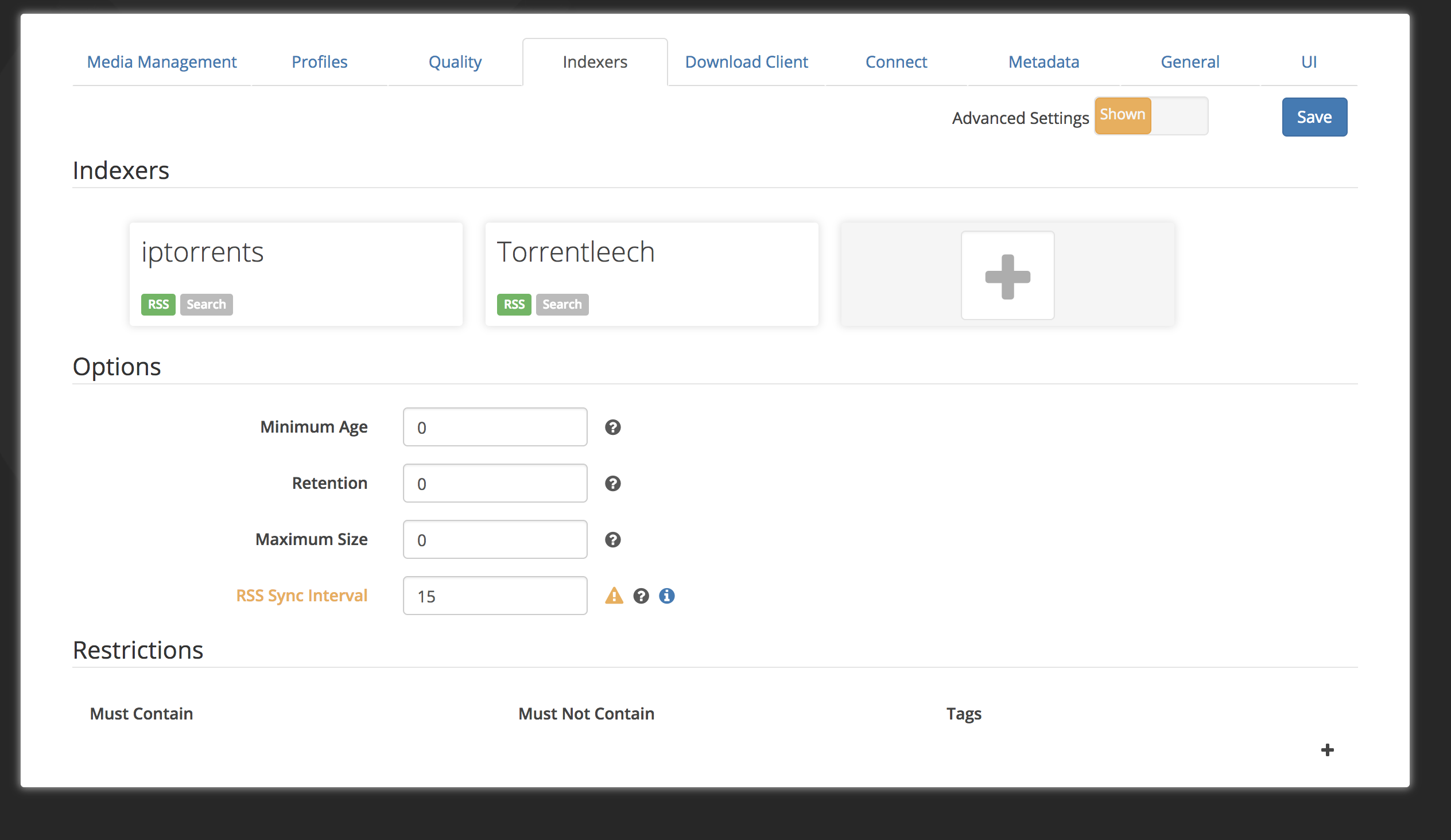

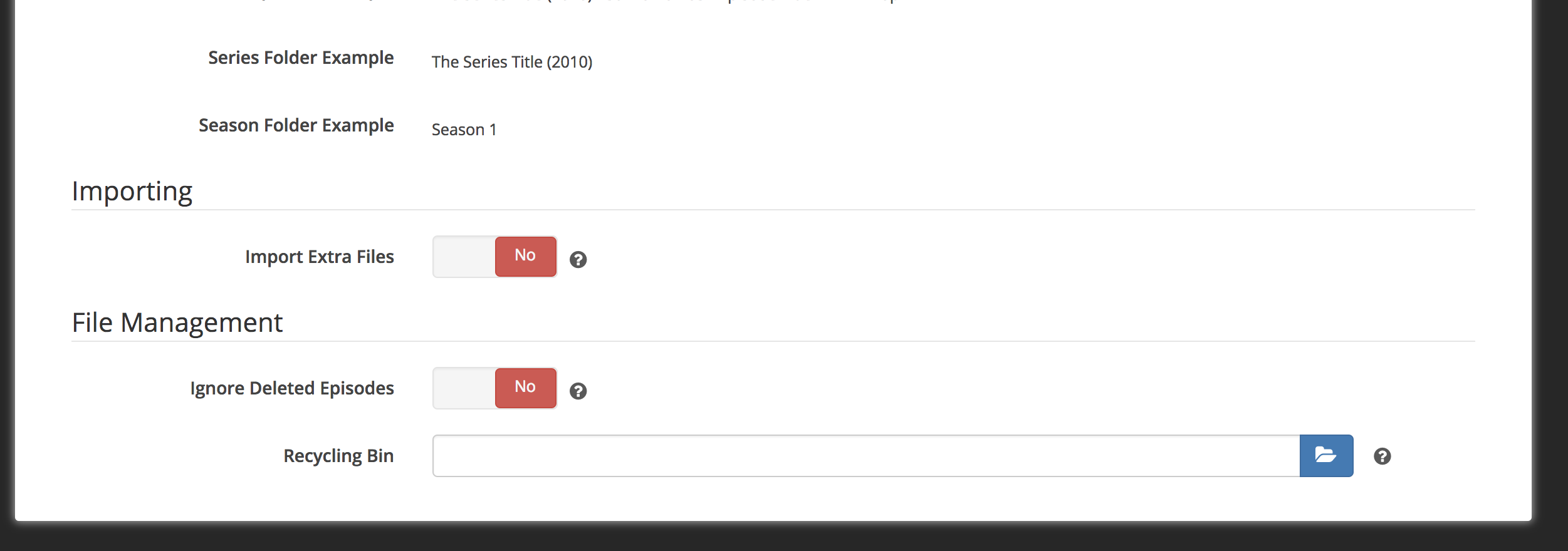

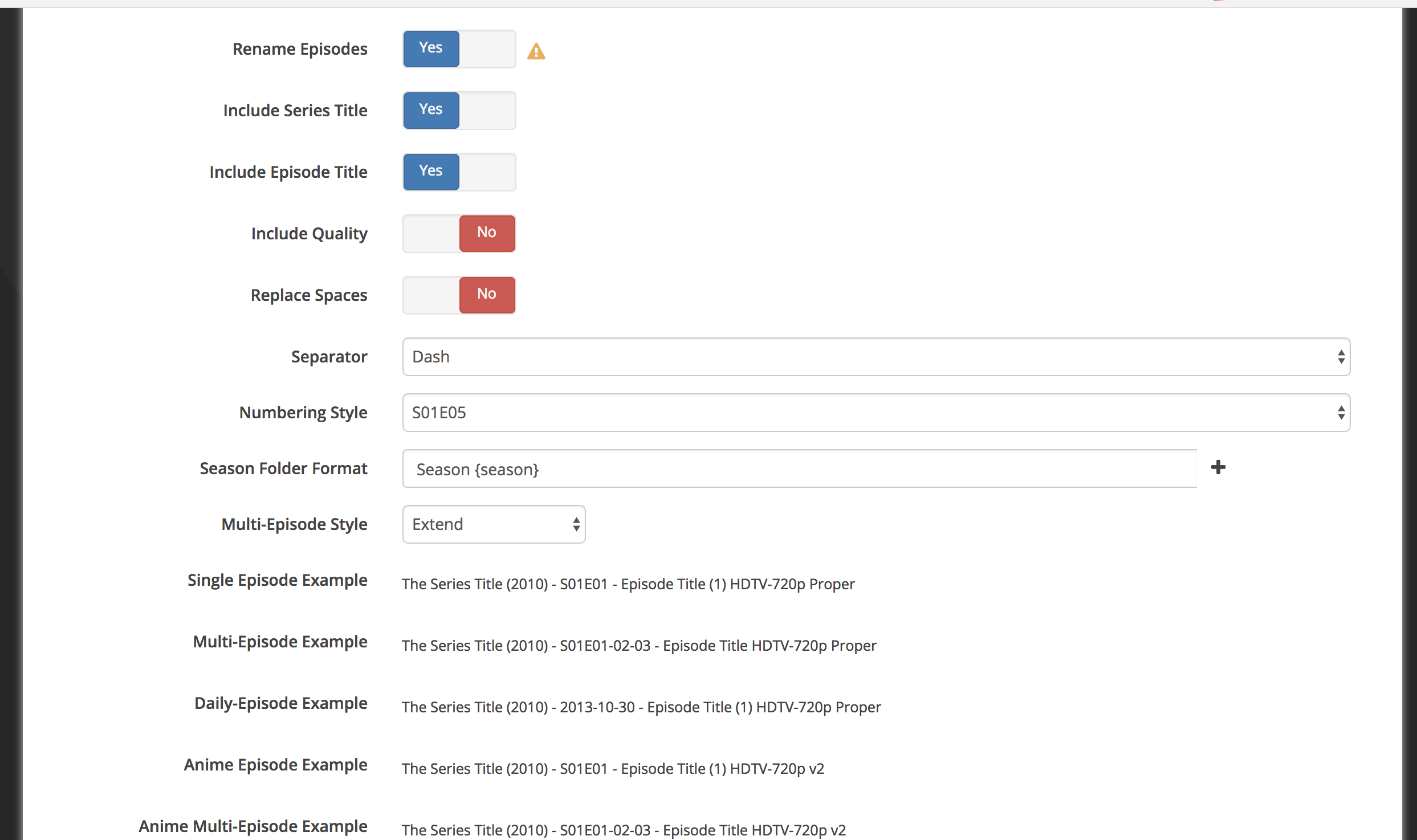

no im not after the settings for the sonarr container, i need a screenshot of the settings for the sonarr web ui, as in a screenshot showing where its looking for downloaded content to do post processing.
You mean here? If not, please direct me.
Does anyone have an idea friends? I'm desperateץ :(
