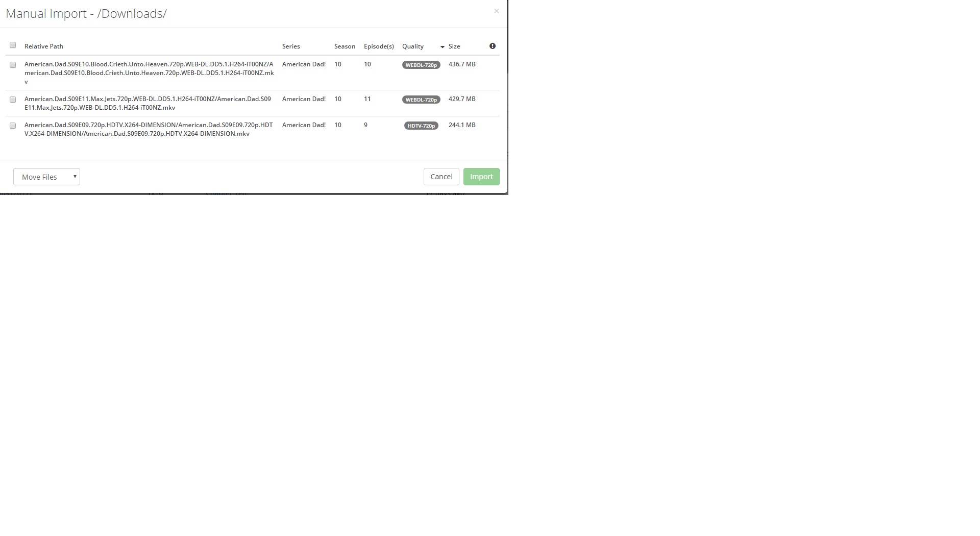

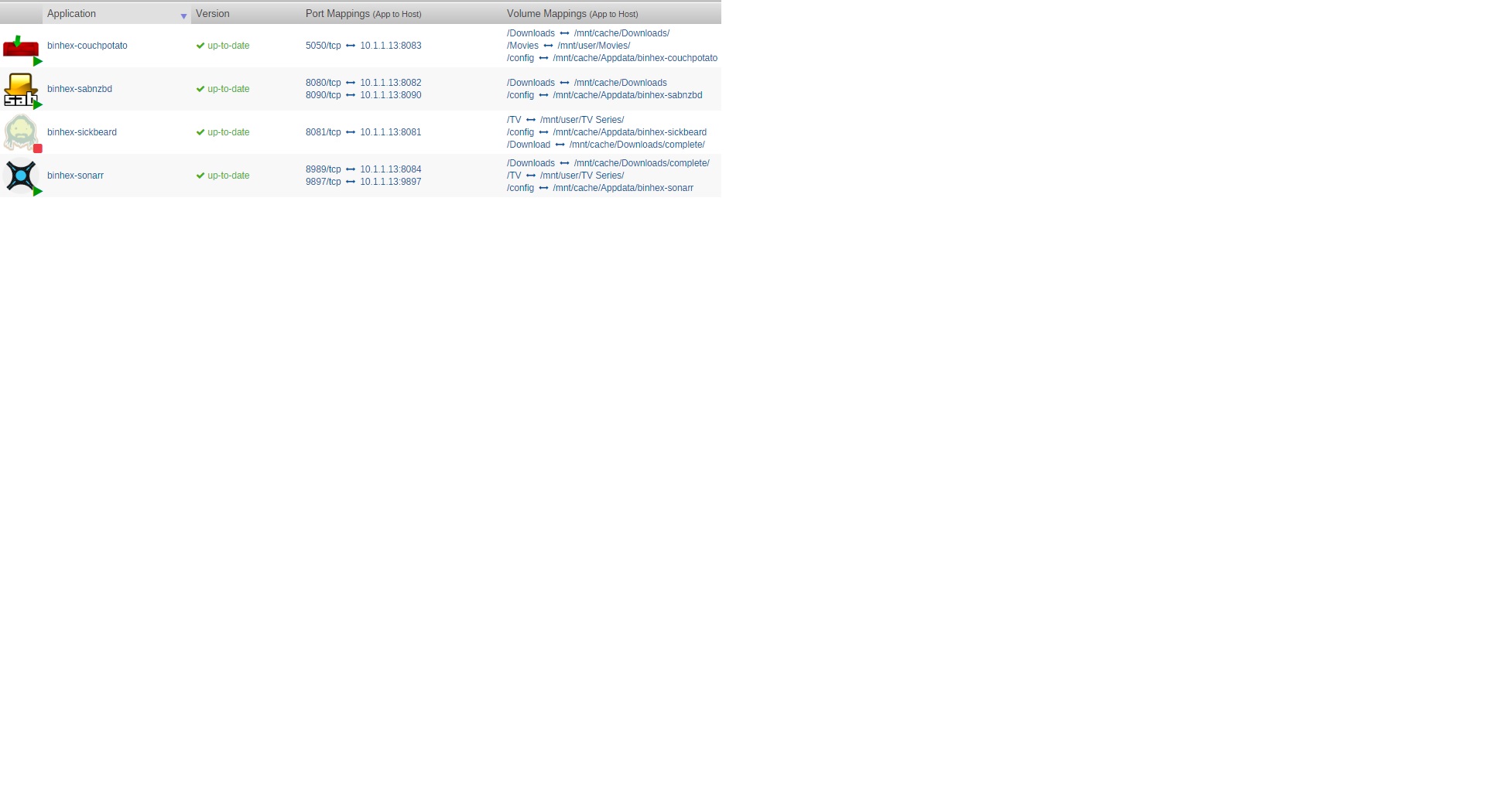

Hi, I have looked all over but I am still stuck. Sonarr will not import any files from SAB.
Import failed, path does not exist or is not accessible by Sonarr: /Downloads/complete/American.Dad.S09E19.720p.WEB-DL.DD5.1.H.264-iT00NZ-RP
I am pretty sure everything is as it should, I have only transitioned from SB and so they are both using the same mappings and yet SB works Sonarr doesn't.
Attached is my mappings and when i go to manual import in Sonarr and select the drive it can see the files.
Sorry for a repeated topic but your help is appreciated, I just feel i am going in circles.
/mnt/cache/Downloads/complete != /mnt/cache/Downloads
Remove the /complete
Ok thanks,
Made the change and I think it is looking good. Just retesting to confirm.
So i feel it makes sense now(Sonarr needed to match SAB and not be the same as Sickbeard), but why are these not the same /mnt/cache/Downloads/complete != /mnt/cache/Downloads/complete (when SAB IS putting the completed file here?)
Thanks again.
Because SAB is putting the file in /Downloads/complete, and Sonarr is looking for the file in /Downloads, not a subdirectory. Computers generally are very literal, they can't make logical leaps.
