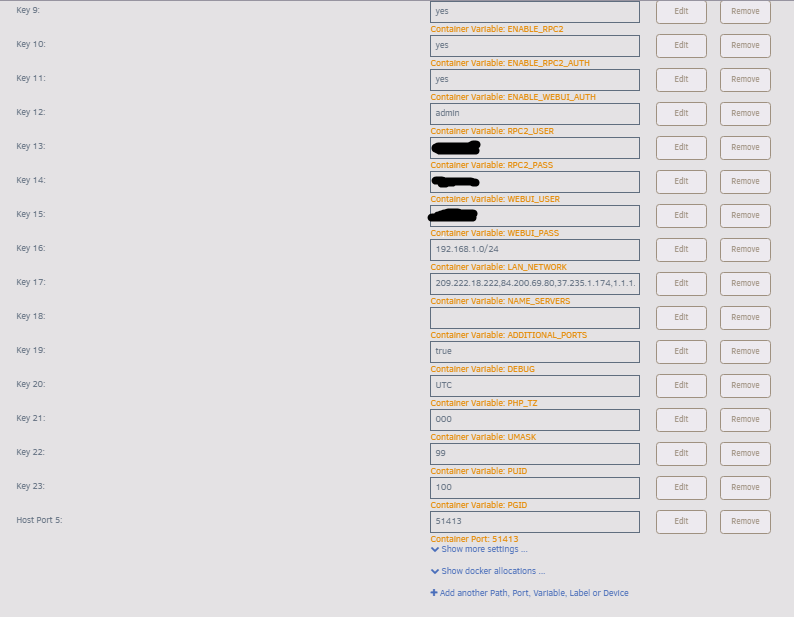

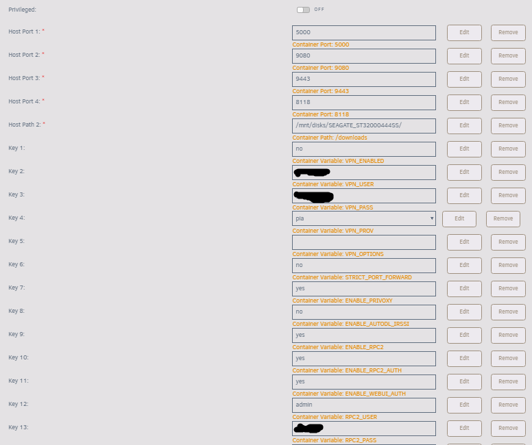

  7. rutorrent does show that in settings yes. Here are the screenshots from my docker.
  8. ##################################################################### # # The Seedbox From Scratch Script # ---> https://github.com/thevisad/ # # ## See Readme.md for License ### max_downloads_global = 0 max_uploads_global = 0 min_peers = 50 max_peers = 200 min_peers_seed = 50 max_peers_seed = 200 max_uploads = 50 download_rate = 0 upload_rate = 0 trackers.use_udp.set = yes encryption = allow_incoming,try_outgoing,enable_retry network.max_open_files.set = 2500 #network.max_open_sockets.set = 1536 network.http.max_open.set = 256 network.send_buffer.size.set = 1M network.receive_buffer.size.set = 1M dht = auto protocol.pex.set = yes check_hash = no pieces.preload.type.set = 1 max_memory_usage = 3500M throttle.global_down.max_rate.set_kb = 6400 throttle.global_up.max_rate.set_kb = 1024 # Default directory to save the downloaded torrents. # execute = {/bin/bash,-c,mkdir -p /downloads/incoming} directory.default.set = /downloads/incoming/ # Default session directory. Make sure you don't run multiple instance # of rtorrent using the same session directory. Perhaps using a # relative path? # execute = {/bin/bash,-c,mkdir -p /config/rtorrent/session} session.path.set = /config/rtorrent/session/ network.port_random.set = no network.port_range.set = 51413-51413 # Disable check for SSL cert for tracker # network.http.ssl_verify_peer.set = 0 dht.mode.set = auto # UDP port to use for DHT. # dht.port.set = 6881 # Enable peer exchange (for torrents not marked private) # protocol.pex.set = yes # Set downlad list layout style. ("full", "compact") # #ui.torrent_list.layout.set = "full" # SCGI Connectivity (for alternative rtorrent interfaces, XMLRPC) # # Use a IP socket with scgi_port, or a Unix socket with scgi_local. # schedule can be used to set permissions on the unix socket. # scgi_port = 0.0.0.0:5000 #scgi_local = /home/user/rtorrent/rpc.socket #schedule = scgi_permission,0,0,"execute.nothrow=chmod,\"g+w,o=\",/home/user/rtorrent/rpc.socket" # Initialise ruTorrent plugins (required for rss and scheduler plugins) on startup # (normally triggered by a browser opening the web ui). # # The command below in practice does NOT always trigger (possible race condition?) and thus # the same command has been added to the script /home/nobody/initplugins.sh in order to # attempt to ensure all plugins are initialised. # execute = {/bin/bash,-c,/usr/bin/sleep 10s && /usr/bin/php /usr/share/webapps/rutorrent/php/initplugins.php admin &}

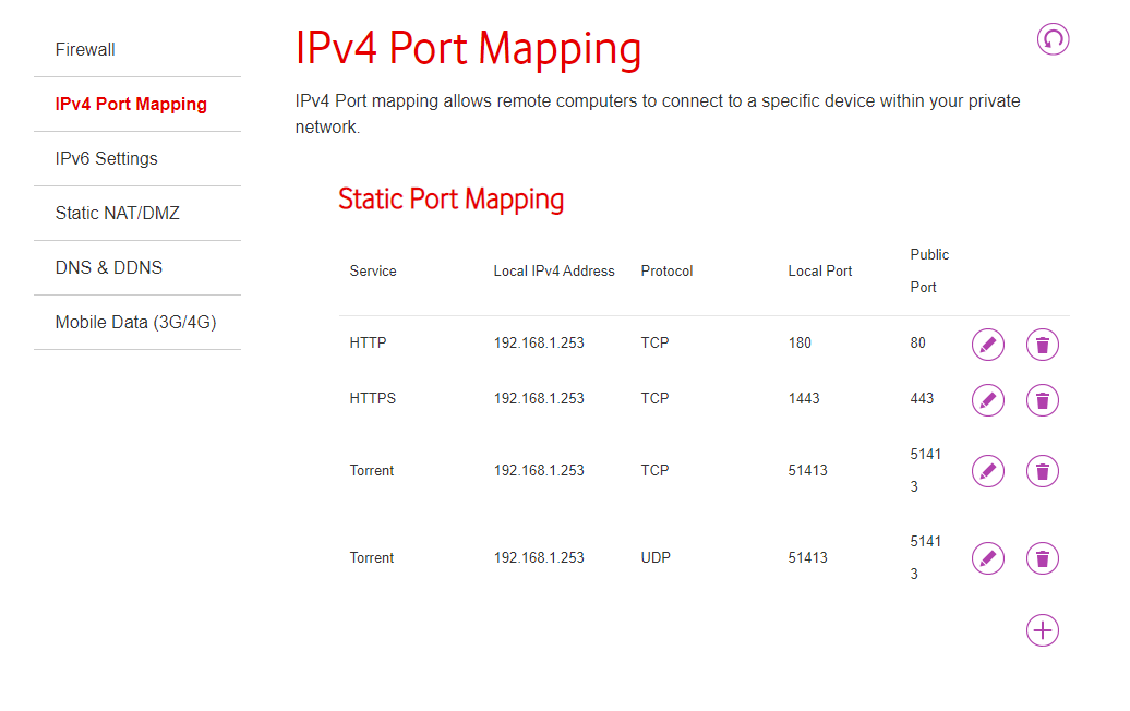

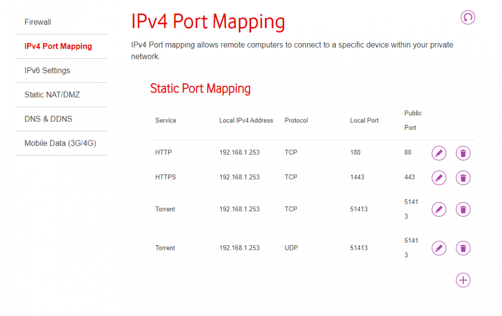

  9. My sites also report the port as closed (unconnectable).
  10. Yes but my port is reported as closed, even though i have tripple checked everything is set correctly. Docker mapping has 172.17.0.2:51413/UDP192.168.1.253:51413 I have that port forwarded on my router, both UDP and TCP, I've edited the rtorrent.rc file to include the port also.
