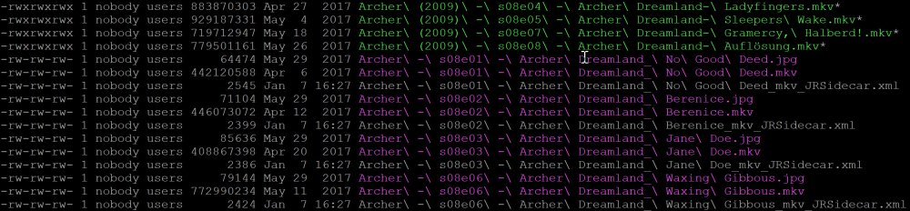

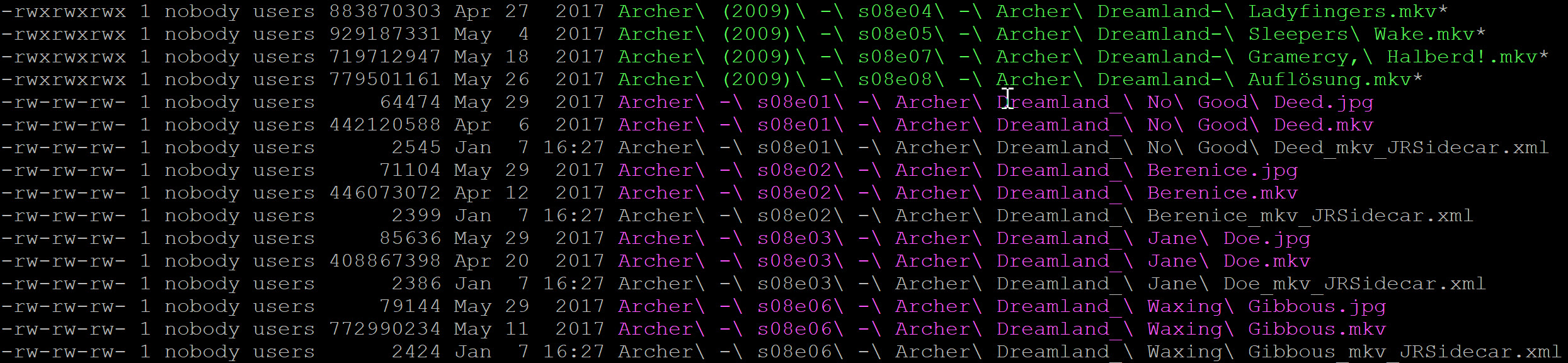

A question about permissions:
I used to have the setting at 770, which mostly worked, but Fix Common Problems complained that the files didn't have the right permissions, and I had to run the Docker Safe new Permissions script in tools to 'correct' them.
So, I changed Sonarr to use 777 instead, and now FCP doesn't complain, but my (JRiver) media player doesn't like the new permissions.  I used to be able to "Update Library (from tags)" to get the program to see the new dimensions (1080 from 720) because Sonarr found the better file.  But after changing to 777 JRiver fails when I try to update; which tells me it doesn't like the new permissions for some reason.
Below is a screenshot of a few files (in green) that Sonarr just replaced and you can see their permissions are not the same as the rest of the files.
tl;dr: how do I set the permissions in Sonarr to match what Docker Safe New Permissions sets them to?

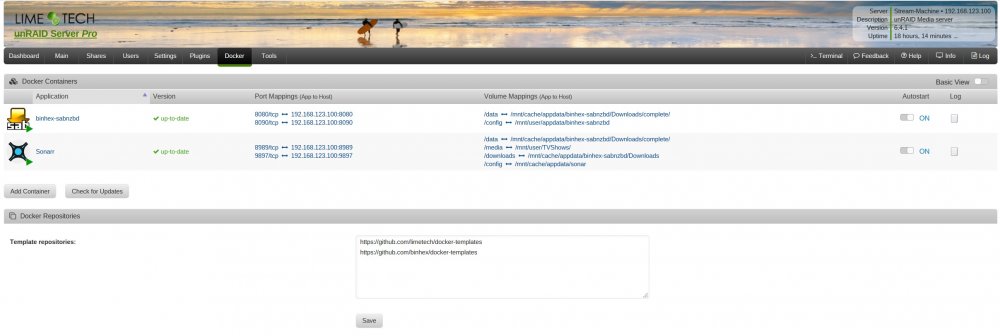

Import Failing After Upgrade And I Can’t Figure Out Why
Sonarr version (2.0.0.5153):
Mono version (5.0.0):
OS: unRAID 6.4.1
So this happened to me once before and I thought I had this all figured out, but apparently not.
I’m running SABnzbd and Sonar in Docker containers on and unRAID server, from the binhex repositories. After upgrading to the latest version of unRAID both Sonar and SABnzb went belly up so I deleted the containers and started again.
Everything is working except that Sonar can’t seem to find the download TV shows and import them to my unRAID server. The following log message seem to indicate Sonarr is looking for them in a nonexistent location from an ancient install from another repository (I don’t know where it’s picking this up from): Import failed, path does not exist or is not accessible by Sonarr: /config/Downloads/complete/Genereic TV Show Nme.S07E04 Episode name.720p.AMZN.WEBRip.DDP5.1.x264-NTb-postbot.1/37de00f3d8f747a3acb0728d88d4ee19.mkv
I’ve looked and fiddle with every setting I can find to get Sonar to pointed to the right download folder but I’m obviously missing. Anytime there is a setting field and I click on it, opens right to the correct folder with the downloaded files. I can even go into the Wanted tab on the webgui select Manual Import and the downloaded files are right there in the Recent Folder where I can manually import them.
Any help or suggestions would be greatly appreciated.
Here’ are my paths for Sonar and Sabnzbd:
I figured this out and thought I post in case anyone runs in to the same issue.
After poking around my cache drive (where all my docker containers are on my unRAID server) I realized there were multiple locations with the sub-path \downloads\complete (and \incomplete) in them. All of which when selected as the download destination in the settings of SABnzbd appear as \config\downloads\complete. There was also a \downloads folder as well.
Adding to my confusion was the fact that one of locations had an uppercase D in Downloads, which the Sonarr error message has as well indicating to me that is where it was looking … it was not.
I replaced the config and .ini files for SABnzbd with those from the last working version then downloaded and successfully imported a file to make sure it worked. After doing so I opened up the two \downloads\complete folders, the \Downloads\complete and the \downloads folder and downloaded the same file again and monitored exactly which one the file was actually being downloaded to then put a null text file called This Directory in it. Put the newest config and .ini files back, went into the settings, navigated to the folder with the text file and selected it as the destination folder. I also deleted all the apparently extraneous \download\complete folders. All working now.

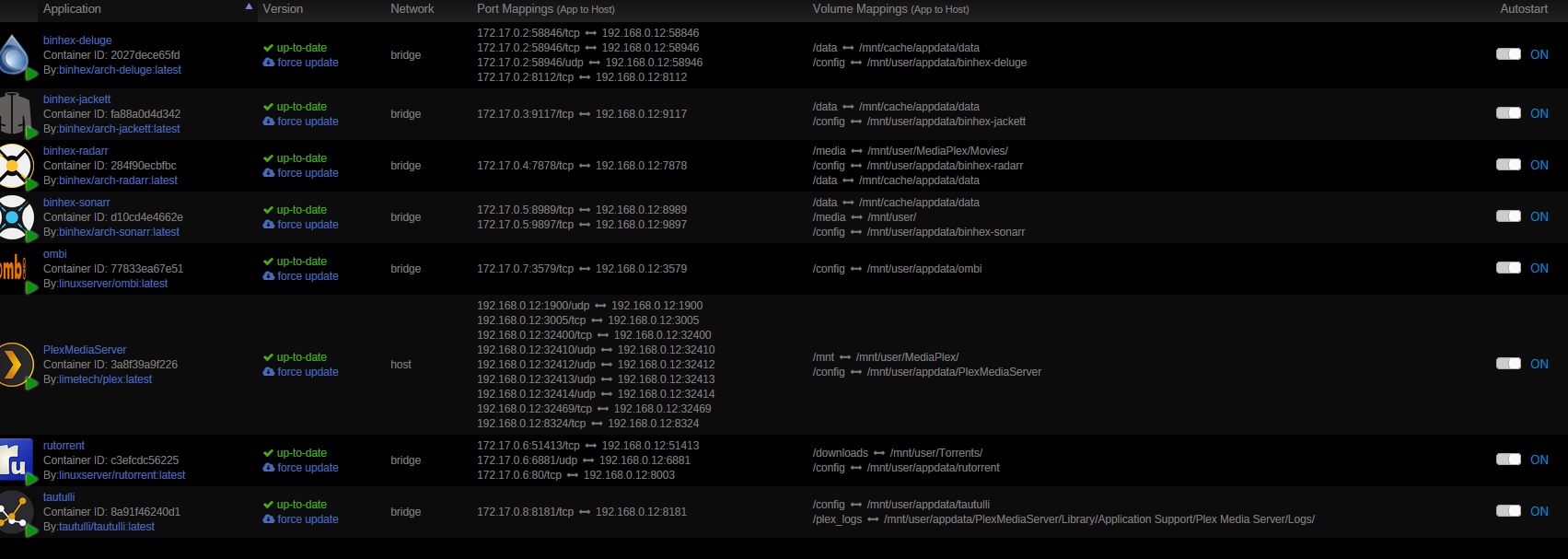

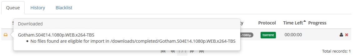

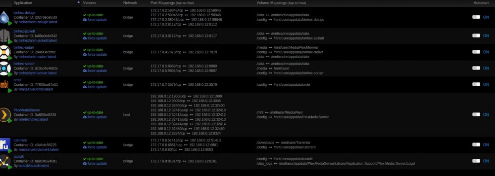

So I could use some help.  FYI, I'm super new to unraid.  (IE I'm within my first 24 hours with unraid as of this post).
Right now, I have the following dockers installed (please see below).
I can make a request through Ombi (in this case I'm just testing it with last weeks airing of Gotham [ No spoilers, I haven't seen it yet ;)]).
Ombi sends the request no problem to Sonarr, which in turn uses jackett to find my file, and then automatically starts the download in rutorrent (or is it rtorrent... I don't know what to call it).
Now I created a user share called Torrents.  Inside of it are the downloading and Completed folders.  I set the /downloads container for rtorrents to this share.  I also set it up to automatically move all completed downloads to the completed folder and it auto unpacks them.  I've navigated to this folder and verified that it is successfully unpacking the media from it's rar format to (in this case) it's mkv format.  Keeping it within it's individual folder that all the rar files are in within the completed folder.
Problem is, Sonarr won't then automatically move it to my Plex Media Server TV Folder.  It gives me the error you'll see in the second screen shot.  I can scan and bulk import no problem from my plex media tv shows folders. I just can't get Sonarr for whatever reason to find and move over the freshly unpacked file.
Advice?
You sir, are a very helpful genius. It's always a super easy solution that drives you crazy for hours.  Thank you!

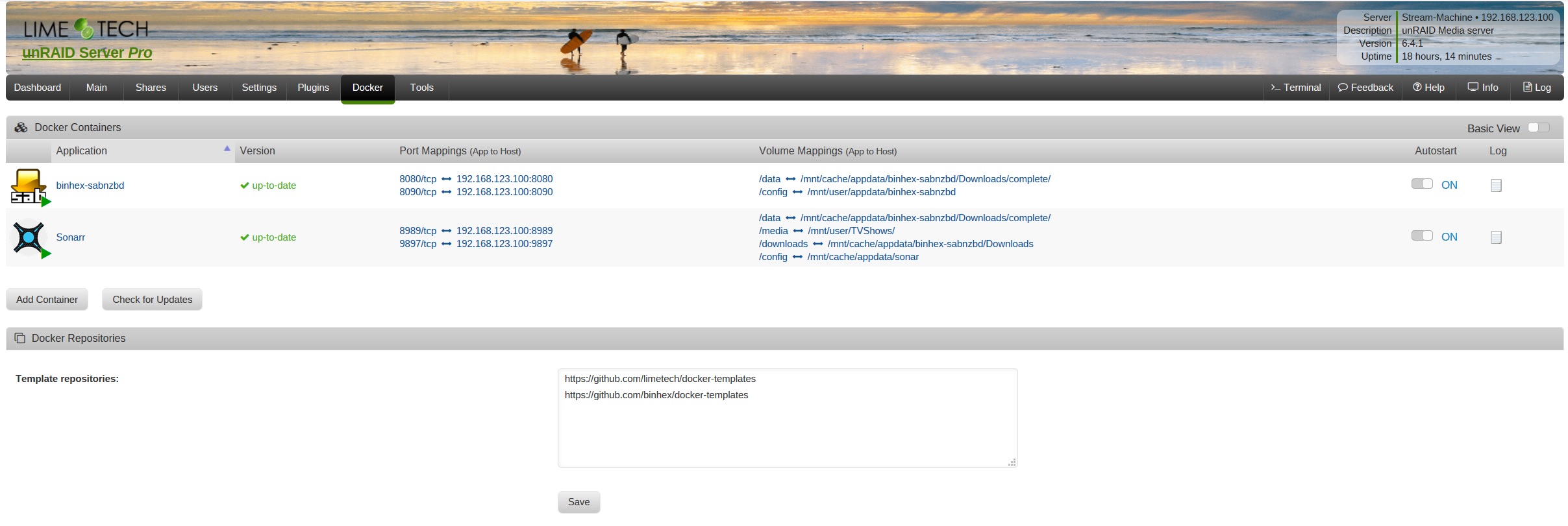

Sonar in outer space.  I am not sure what is happening - this is a new problem after everything had been working well.  Sonar starts, the web GUI comes up partially and all I see is the bouncing ball left to right.  I can never get fully into Sonar.  I believe I have all the mapping correct -
Below is the log from Sonar - I get the import failed issues mentioned in the above posts - but it was working before.
Created by...

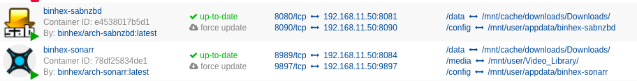

On 3/28/2018 at 2:26 AM, Squid said:
Since you mapping is correct right now, check that sab is storing completed downloads in /data and not /downloads
I am not sure what is the issue - below is the error message for the WebIU log .
DownloadedEpisodesImportService Import failed, path does not exist or is not accessible by Sonarr: /downloads/complete/<tvshow name> 5:40am
Per my physical drive mapping: /mnt/cache/downloads/Downloads/  which is mapped to /data for Sonar and SAB.
I have no path named /downloads/complete/  -  All my container paths for download data are named /data  -  nowhere do I have a container named /downloads
If I do a manual import via the Sonar WebUI,  it maps to /data/complete/ I have no issues.  I am not sure why the autoprocessing tries /downloads/complete.    SAB saves its files to /data/complete  - the files are there.
(As a side note, for some reason when using Chrome on a Mac, the Sonar UI never gets beyond the bouncing ball - this is a new phenomenon I have not seen before. Safari has no issue. )
Thanks in advance for the support.
