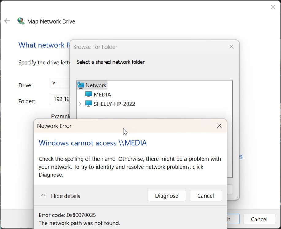

  1. No, because I'd already rolled back before I saw that image. I rebooted the laptop about 4 times while I was running 6.12.2 and they never worked, and I could not re-map a drive makes sense. How would you recommend one begins this update to their security? I'm not in love with SMB, it's just what i setup long ago, and has mostly worked fine for me. I don't open any ports to the internet, (I run a ShieldsUp test regularly) and I'm not really worried about anyone on my wifi, so I'm not sure it's "necessary", but more security is usually good. Thanks all for the help
  2. I reverted to 6.12.0 and upon unraid server restarting (not my laptop), shares were instantly available with no further input from me. I guess this is, once again, a formal bug report and no longer a request for help. my system did no change, only the unraid version. this points to unraid issue, not a me issue. thanks again for trying to help

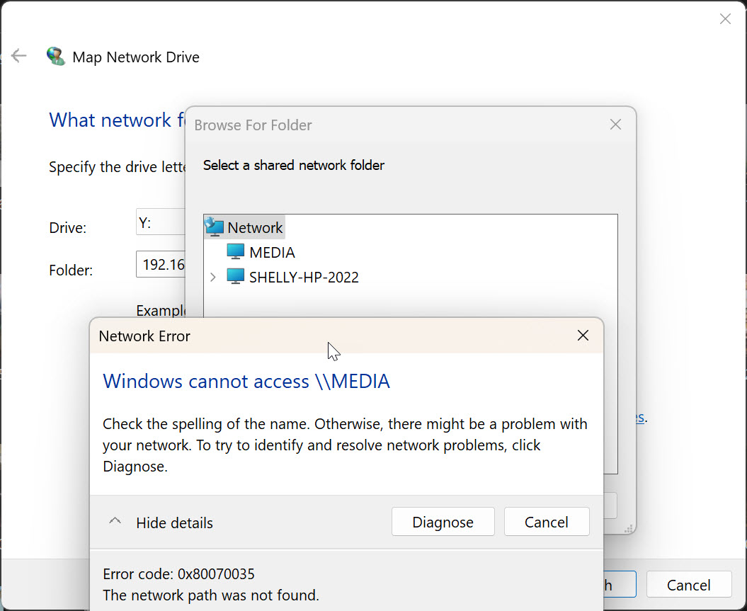

  3. thank you, I appreciate the data point. I have used the server name on multiple computers for over a decade without issue. Even if it were unreliable, that is still an error and should be fixed. But, in my case that has not been the case, and it has worked just fine. With all that said, I have tried to connect with the IP address and that also fails. Windows sees the server name just fine, but refuses to connect.

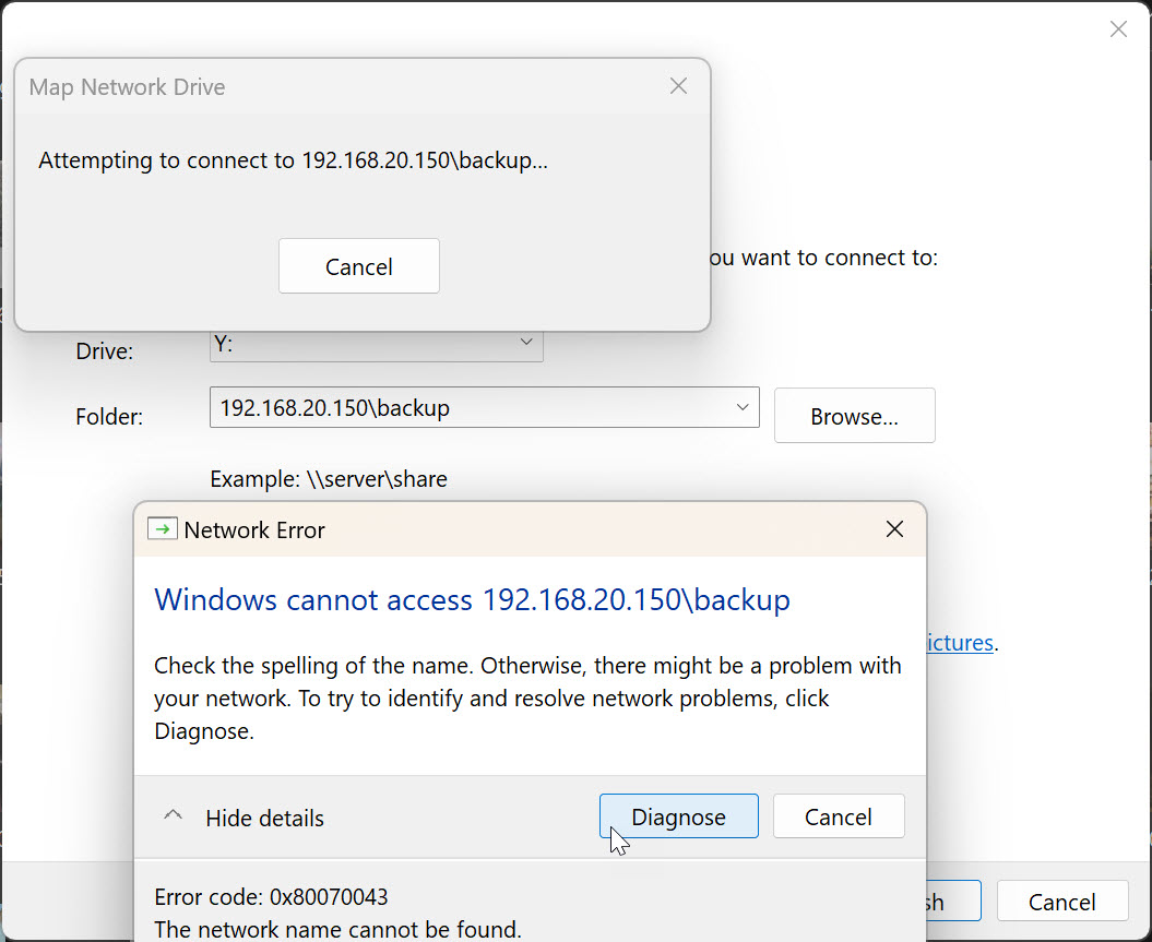

  4. Thanks for the help. it's not a company laptop. it has worked mostly flawlessly this way for a decade. it's just the latest upgrade of unraid that has caused the issue. i did not change anything on the laptop. as I posted before, a previous upgrade caused the same issue, and reverting instantly restored full functionality. I have not reverted simply because I'm hoping there are some actual troubleshooting steps I can take. i will wait until after the US holiday and create a new post in general if there isn't any more feedback here.
  5. I've been able to use name for about a decade without issue. However, i did try using IP address, and it still fails to connect. There is something about this new version that breaks the ability to map network drives on my laptop. The diagnostics file I attached previously doesn't tell me anything, but I also don't really know what to look for. What else can i do to help diagnose/troubleshoot/solve this issue?
  6. Sorry, I was mistaken in the versions that had the issues. I had version 6.12.0-rc5 installed and mapped drives worked fine. I updated to version 6.12.0-rc6 lost mapped drives. I downgraded back to rc5 and it all worked again. Earlier today I updated to 6.12.0 and tested mapped drives and it all looked fine. I then updated to 6.12.2 and lost mapped drives again. I have tried re-mapping, but it does not work. Windows tells me it cannot access \\MEDIA (the name of my server). Windows does find it under network, but refuses to connect to it. Diagnose does not find any issues.
  7. windows 11 shares are broken in this build. I was on 6.11.5 (I think) and updated to 6.11.7 (can't remember exactly which, but not 6.12) and I lost the ability to open/use mapped drives in windows explorer. After a couple hours trying to resolve, I thought to just roll back to 6.11.5 and mapped drives worked again. Earlier today, i saw that 6.12.2 was available, but I could only update to 6.12, which I did. i tested mapped drives and all seemed fine. Then I updated to 6.12.2 and now mapped drives do not work again. I'm guessing this is me not changing some setting, or this would have probably been reported before, but either way, it IS broken for me, and I don't know how to resolve it. Diagnostics attached, help much appreciated. media-diagnostics-20230704-1710.zip
