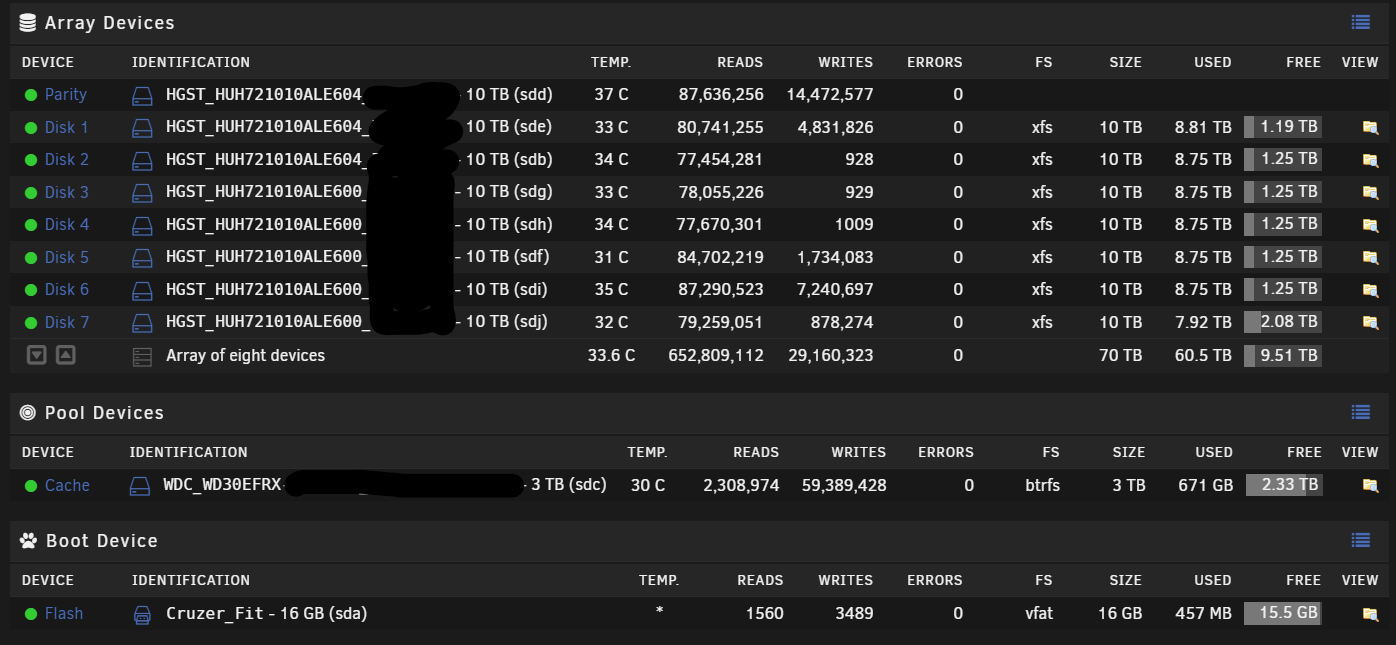

  2. Current setup: 1x 10TB HGST Parity 7x 10TB HGST Array Devices (xfs) 1x 3TB WD HDD Cache (btrfs) 1x Flash Drive for Boot Device (vfat) All of this is in a Dual Xeon 4u 24bay Supermicro X9DR3-F, running 6.9.0-rc2. I'm over 60tb used of the 70 I have in my array so it's getting time to add new drives. This is scary and I am beginning to have worries over things like drive failures/redundancies, but that's a different question. Over the years I've read conflicting things about cache drives (SSD/HDD) and would like to know the current best practices. I'm planning on adding maybe 6 more large drives, and maybe throw in a couple new drives for the cache. Should I get SSDs? High reliability HDDs? Bigger drives? 1. I know I need to have another cache drive at least, what drive (or drives) would you recommend adding? 2. Should I have a 2nd parity drive? 3. I'm using a single flash drive as the boot device, should I add another or is it fine? 4. Lastly: I worry about losing data. Everything is replaceable, but I know it'll be a pain if a giant drive eats it, anything I can do to allay my worries? BONUS: I've just recently learned about DAS, and there's a kernel of an idea for me to make a dedicated machine with a beefy, modern cpu to handle all the docker/transcoding/compression stuff. My machine currently has dual xeon E5-2680 that were, in their heyday, absolutely beastly, AND it has 256gb ram, but I know a modern AMD chip would probably blow it out of the water. Am I overthinking things?
